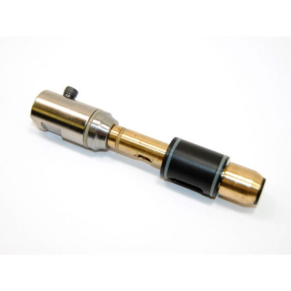

    I understand beveling the bolt on top to avoid clipping but wouldn't the rest of the bolt encourage pinching any shells between the bolt and body?
    There is nothing indexing the bolt in these. It's very conceivable that the front delrin portion might spin slightly after a couple thousand cycles. Even with all the mods, the re-cock becomes extremely unreliable if you have a single ball break in a cat, so "shooting through" a chop isn't really an option anyway. At any rate, last time I tried shooting 0.675 paint through a cat, I never made it out of the staging area. Today I put at least 4 or 5 hoppers though it. The whole point of this is to make sure there AREN'T any loose shells in the breech....
      • 6182
      Shows how much I know about cats!

          I wonder if a T15 bolt would fit in a Cat. I know it's based on the design. Obviously the slider doohickey would have to be swapped for the donut.
          • Myrkul
            Myrkul commented
            You might just be able to take the brass tip and swap it with the derin from a cat, but I suspect some of the dimensions will still be off. That is also going to be far more expensive then the two $0.15 washers and a sheet of 400 grit sand paper....

          Great mod. Put about half a case through my thundercat at bones n' ashes a couple weeks ago by modding my bolt in this fashion.

                Bob Cat Differences.
                Finally got around to getting my Bob Cat running on HPA. This was definitely a little trickier to do then my Alley Cat or Thunder Cat since the volume is a lot more restricted on these.
                Step 1 is to drill out the air passage on the Vert ASA AND on the body itself. The largest I was comfortable going remained 7/32.
                Step 2 is actually replace the main spring with one from a later model cat. It looks like the Alley Cat/Thunder Cat main springs are about 1/8" longer. I used a fresh one from those 32 degrees kits that occasionally pop up on Ebay.
                Step 3 is to Polish up the valve Stem.
                I usually disassemble the valve stem from the cup seal, toss it in a drill chuck, and then hit it with sand paper. 600, 800, 1,000, 1,200, 1,500, 2,000, 2,500, 3,000 grit sand paper. I also hit the brass edges around the cup seal itself.
                Step 4 is to sand the cup seal flush. I noticed on a lot of cats, especially if you are using a replacement cupseal, the cup seal sticks up a bit above the brass cup seal base. This causes the valve stem to sit a bit lower then it should and decreases the velocity. Using a plexiglass backer, I sanded it in a figure 8 motion to ensure it stays perfectly flat. Again, I use 600, 800, 1,000, 1,200, 1,500, 2,000, 2,500, 3,000. grit sand paper. I usually keep going until the cup seal is just below flush with the brass edge (this does knock just a little bit off the brass edge too).
                I have gone back and updated both my Thunder Cat and my Alley Cat with this valve polishing/tuning as well, and both experienced a significant velocity increase, which I then used to decrease the tension on the main spring for a softer shot. Be sure to use blue Loctite on the threads when reassembling!
                Step 5 is modding the bolt. I managed to bevel the bolt tip in the Bob Cat, but the bolt face is a little different then it is on the Thunder Cat and Alley Cat so I had to be extra careful not to take off too much material. For whatever reason, my Bob Cat refused to beat the nylon washers into the correct diameter like my Thunder cat did. After I got the inner diameter hogged out with the Dremel, I had to toss those washers in the drill check and sand the outside diameter down so that the black plastic donut could slide freely over those like it was supposed to.
                And that's about it. I took it to the chrono today and was able to get it cycling perfectly in the 290 range with extremely small field paint and a large overbore. Put an entire hopper through it with zero issues.
                I suspect that these additional mods will work on getting a Puma up to speed as well, but I don't have one handy to act as a guinea pig.
                10/04/2026 dumped a case though the Bob Cat at the big game today. Zero barrel breaks or misfires. This thing shoots absolute fantastic. I brought other markers to use, but at the halfway point I put everything else in the car and just kept running the cat.
