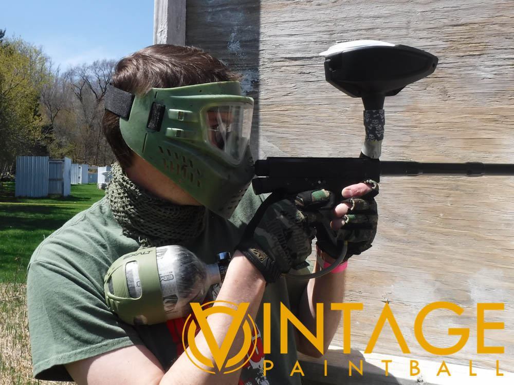

                  Love my Cats. Mine run fine on HPA if you add a gas through grip and bottom line. Can't see it in this older pic, but it has one from a Spyder Xtra now. Gave me enough air that I had to dial back my tuning screws a bit.
