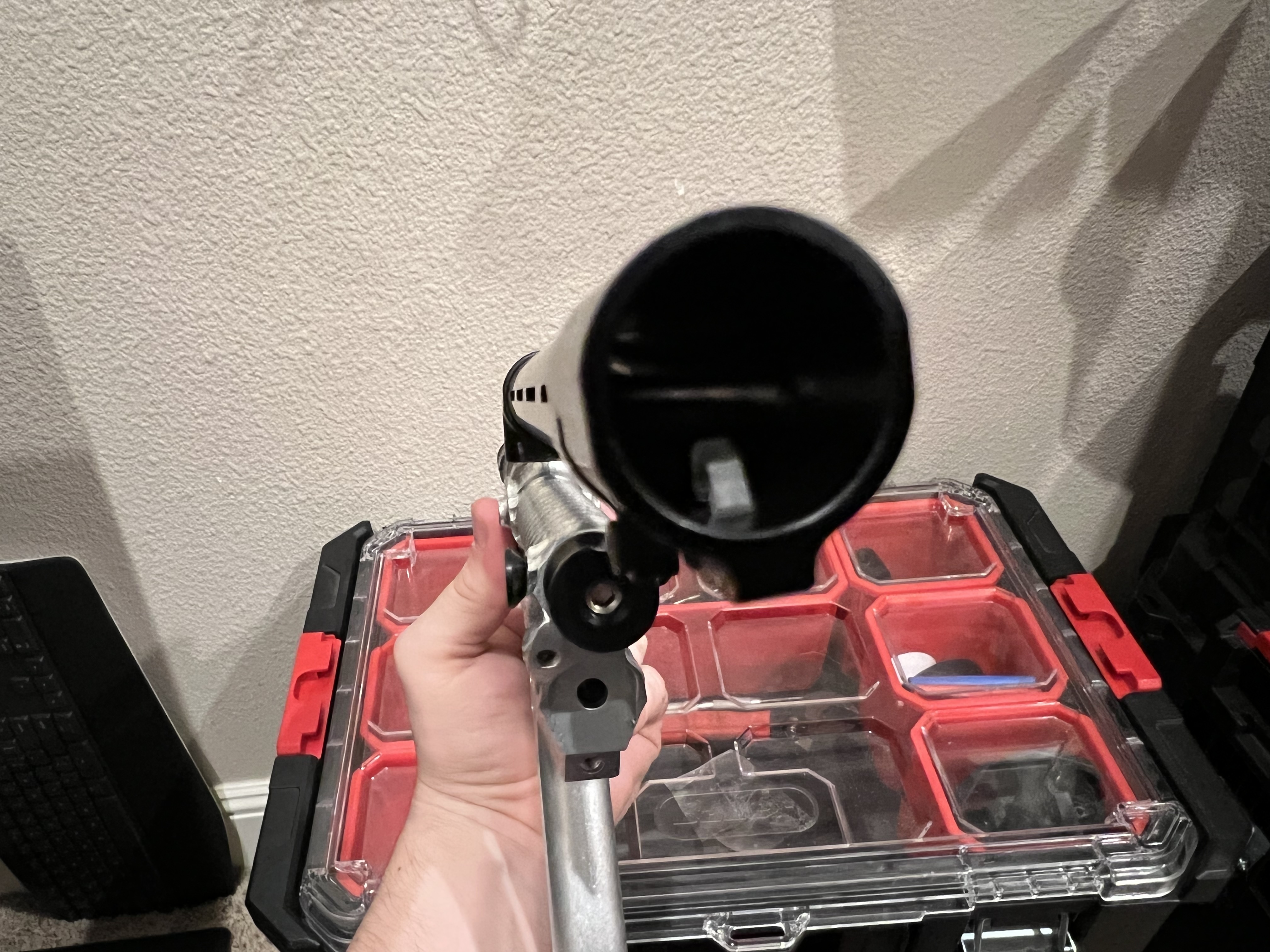

    Confirmed, locks on to empire/inception feeds. Click image for larger version

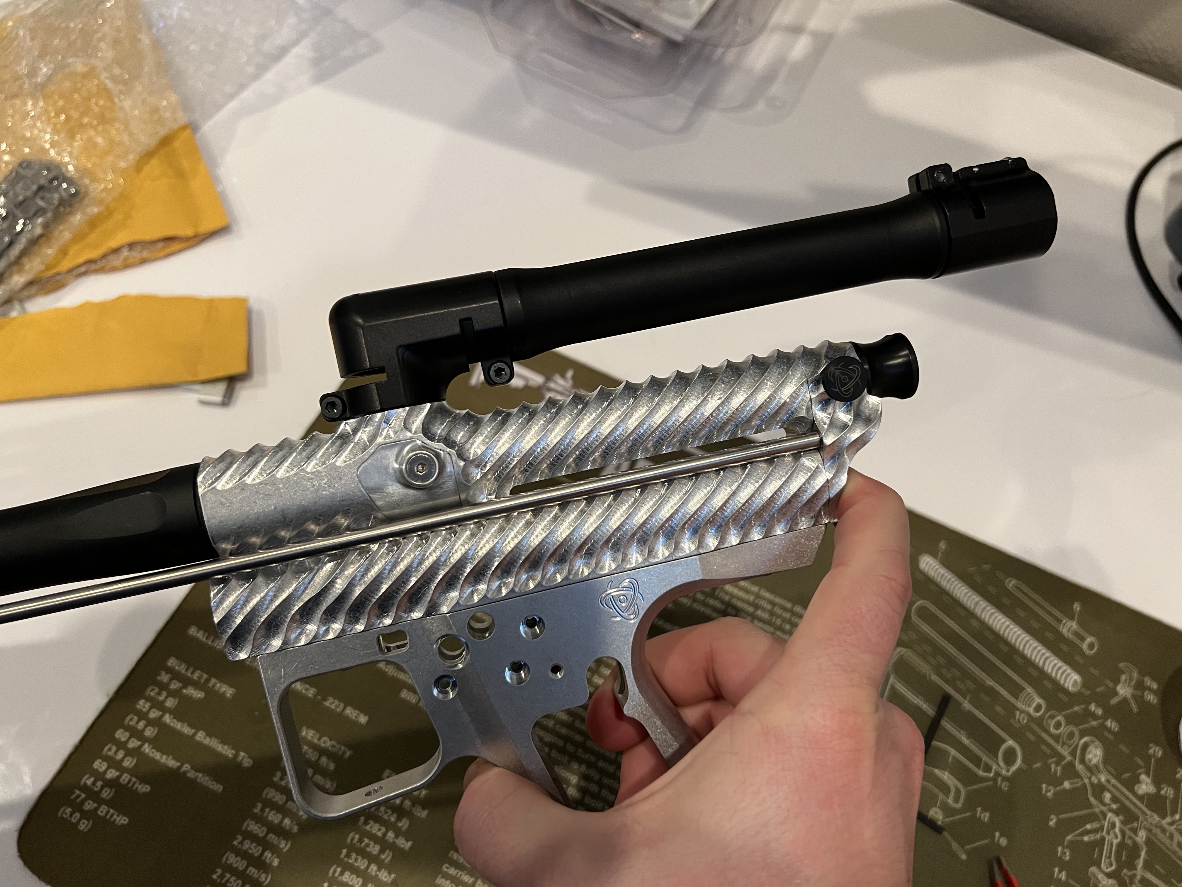

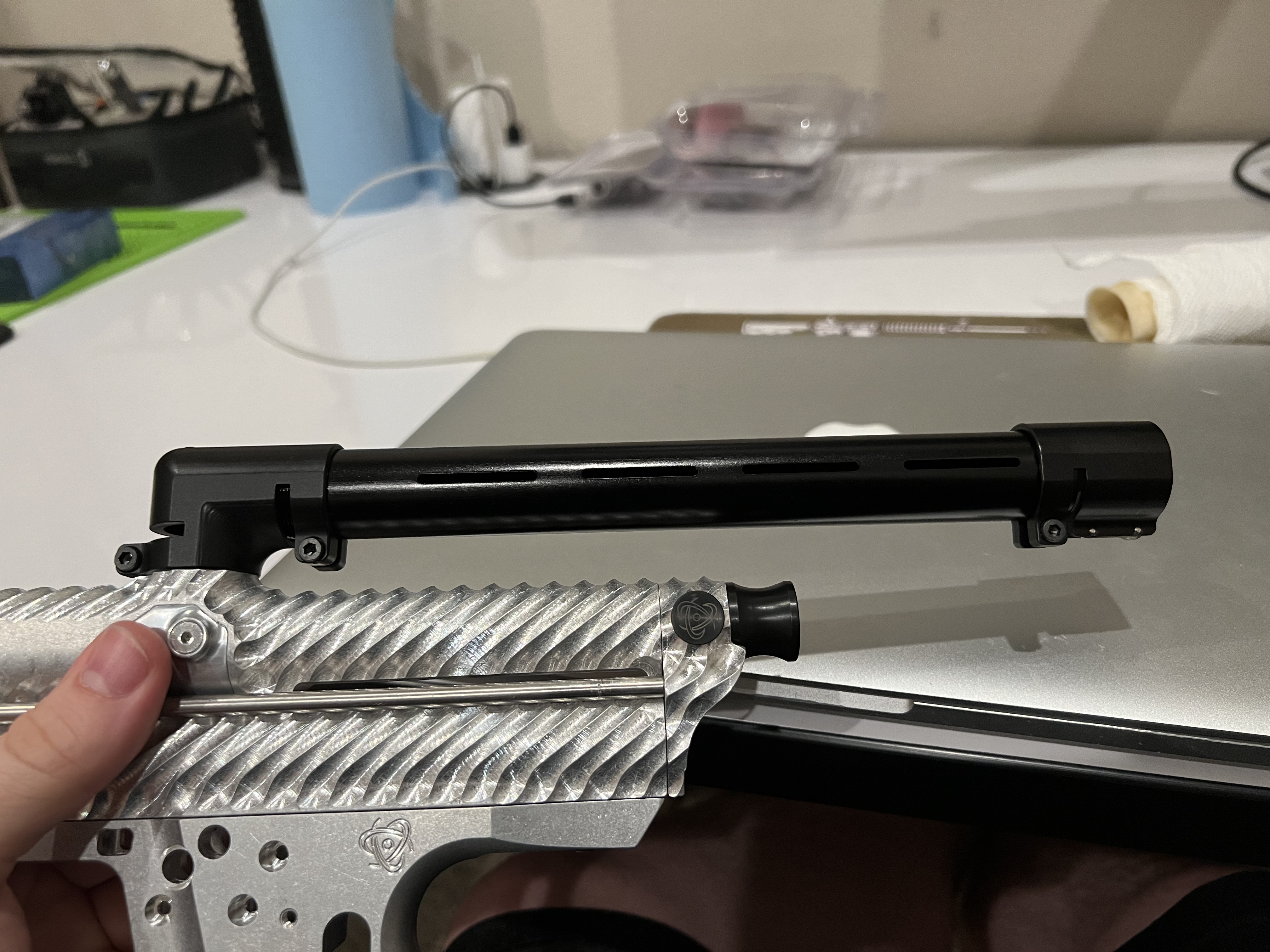

      Did some swapping. I am 99.89% sure it is all aluminum, but I do not know if it is all the same alloy. A CCI feed will cram into the "elbow" portion, and the ICD feed gate will just barely cram on to the CCI feed tube. The CCI feedgate will not work on the ICD tube without modification (CCI is a little too big). The feed gate is like the old Sheridan/PPS style, where you cram a tube far enough to depress the lever of the feed gate, dump the balls and then when you extract the tube the lever flips up and holds the balls in. I may try to source a carbon fiber tube for the top since my build will feature CF heavily.
      Overall very nice build quality. I recently PM'd tjd10684 to see if his design for an empire/ID spec stock class feed came to fruition, but have not heard back. I was considering getting a run (based off that design) made by a machinist (with TJD permission), but this may be a better solution so that we are not infringing on TJD's work. At the moment the only thing I wish was that the screw placement for the screw that secures the feed to the body was on the "rear" side of the gun. That way the front was super smooth and flowed a bit nicer. I might email ICD about doing a run of just the front bit, if making CCI bits work ends up fruit-full. Might help lower the cost.
      Click image for larger version  Name:	image_39399.jpg Views:	4 Size:	3.69 MB ID:	321614
      Click image for larger version  Name:	095959F4-6419-4A5B-A599-F9517C0050FD.jpeg Views:	0 Size:	2.38 MB ID:	321615

        Oh FYI I just found this out. The ICD feedgate is made too small for the "smoked" 10 round tubes. You can get it in there but the fit is very tight and not a quick reload. With a bit of tape it looks like you can get the CCI feedgate to stay on the ICD tube, and so I'm going to run it that way from now on. Only other issue I can see is that I wish the feedtube had some slots in it to be able to see how many balls you had left, like most other SC feeds.
          There aren’t slots in the feed? It looks like it has slots in the pictures. That kind of stinks about the newer style tubes not fitting well.
        • Lt. head-shot
          Lt. head-shot commented
          There are slots in the elbow part but not on the main tube. Side bonus is if you remove the tube all together you can use the screw to tension that area and cram the smoked tubes into the elbow directly, making it like the PTP and CCM cram n' jam.
