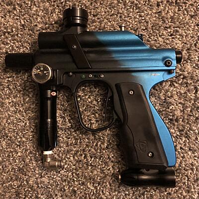

    I took my completely stock promaster out for the first time since my rammer started leaking in 2007. I forgot how close to modern these things are. Anyway I have been building a promaster out of parts I have. I’m trying to make the ultimate promaster. The body is lasoya, the reg adapter is stock icd, cp reg, aka lpr, vapor valve with light spring, kila drive board, cp trigger (these tend to not fit well I might sand down the sides), Bob long cam drive asa, inception grips, superfly bolt (idk if I will use it or stock), aka feed neck, and icdu rammer. I had ordered kila detents but they get either never got shipped, got lost in shipping, or I lost them if anyone knows where to get some please lmk. The plan is to anno this gun in some way as well, but my first plan of action is to get it shooting. I am having some leaks around the solenoid barbs I need to take care of.

    Very nice! Always loved the look of the Lasoya's.
    I think the biggest leaps for modern markers are the fact that there's just not much that needs to be upgraded. OEM regulators are better, OEM boards are better, and most bolts/engines are pretty well tuned.

      I agree, new markers are leaps and bounds ahead in design. I just wanted to build something I could play with at a local 5 man or something. After last weekend I would try one with a stock promaster at 10bps, the rotor even fits the stock feed neck.
