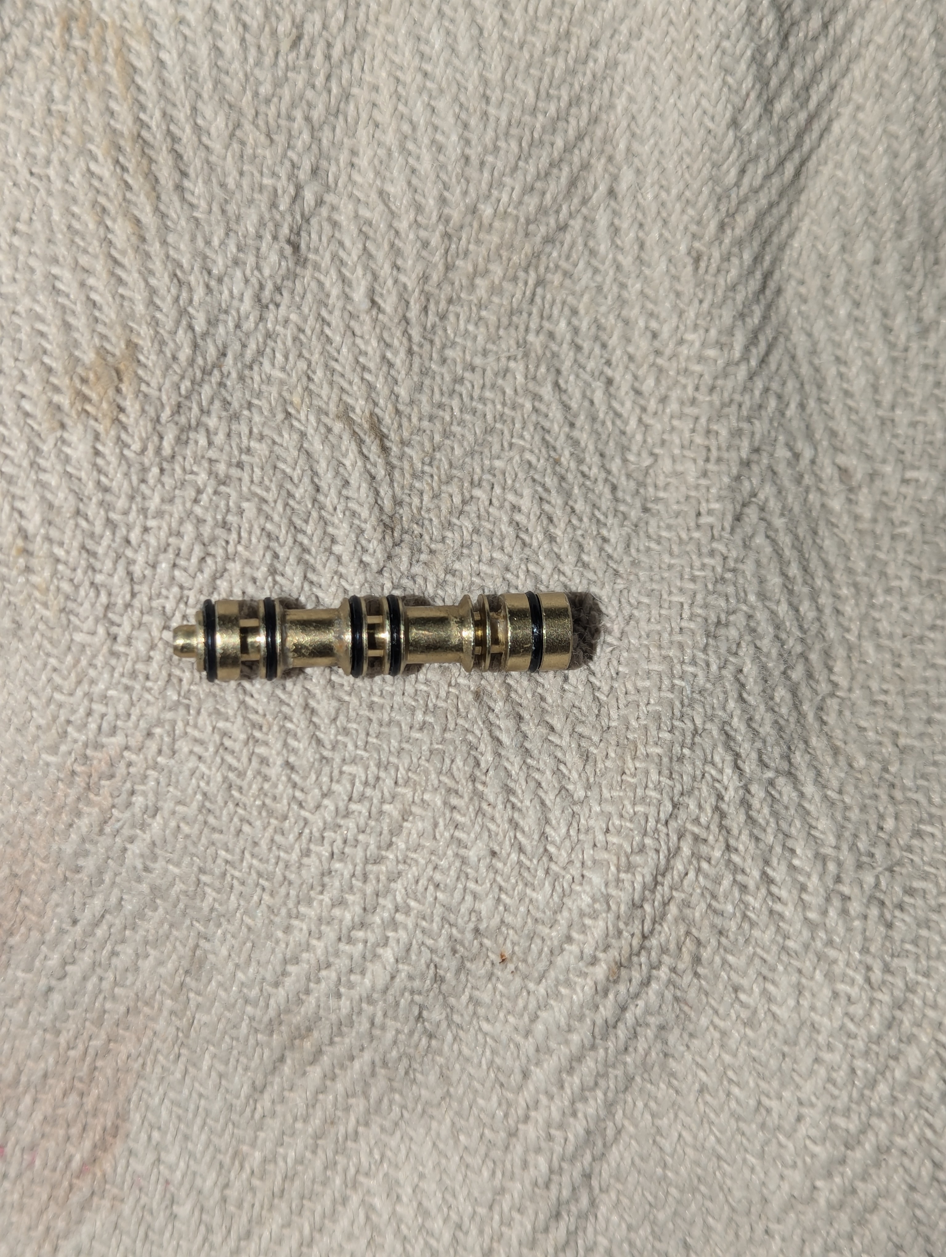

    So, all the recent defiants that have popped up made me want to take mine out but I was getting a persistent leak around the manifold/gasket. Wound up taking the solenoid apart and found this oring (is it even an o-ring?) shredded. Big yikers. Any chance this is a sourceable seal? Or anyone happen to have a nonfunctional solenoid to scavenge a full piston out of? The rest look decent but I'm not super confident.

      I have a piston that appears identical in my pile of random bits but I have no idea if it will fit... iirc it's out of a shoebox shocker, which used Parker solenoids?
      You're welcome to it but shipping from Canada is pricey.

        The shocker has two solenoids in it, a Parker/Skinner K3H01 and a Parker/Skinner K4H01.
        The K3H01 is identical to the K4H01 except the spool and spool housing are different.
        Bushmasters and Defiants use a K4H01 with a "modified" (lighter) spring to run at higher pressures.
        Long-winded way of saying this should work.
