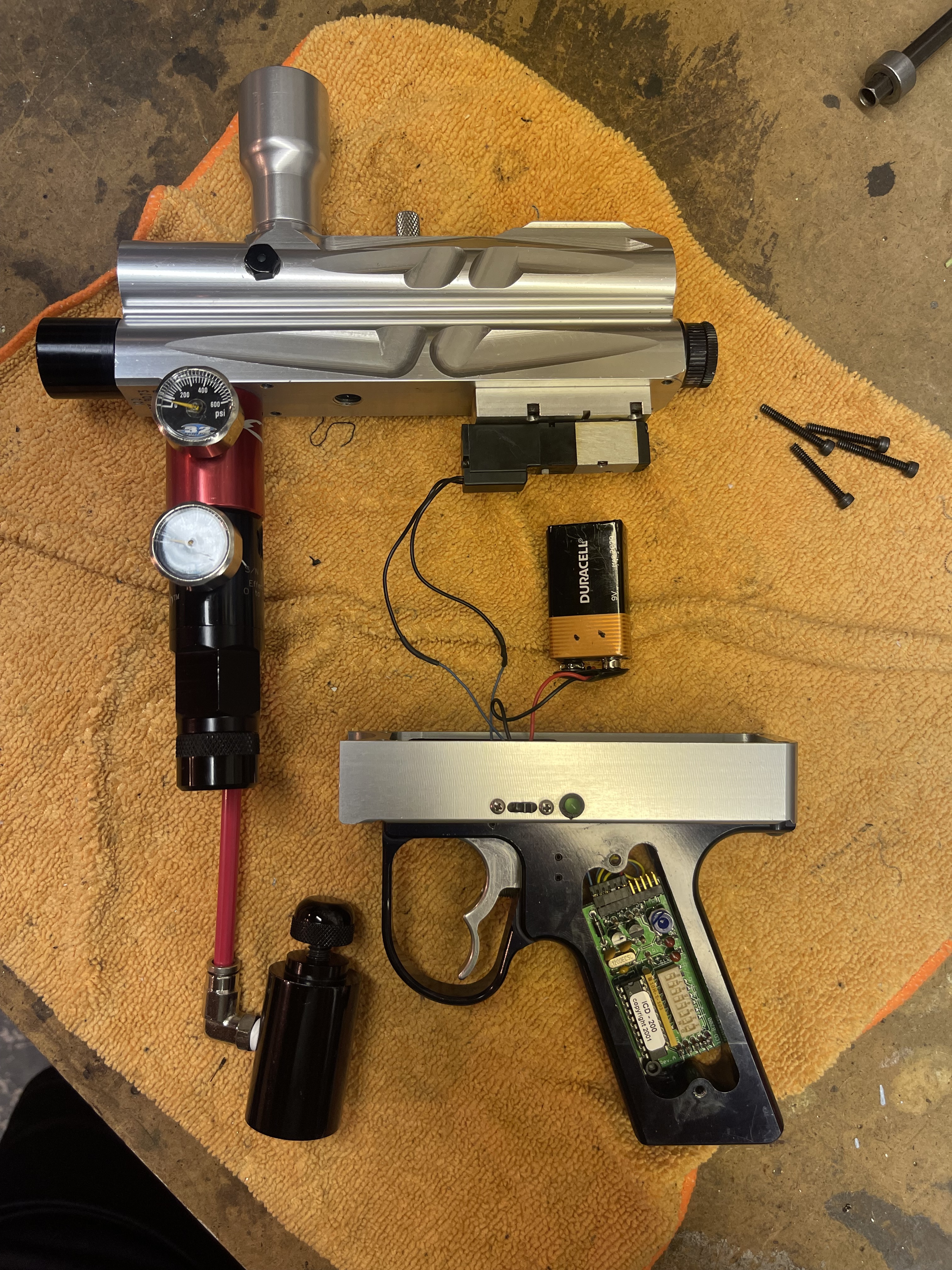

    Hey guys, working on a B2K. I replaced all the orings and lubed it accordingly. When I gas it up the bolt stays in the forward position and doesn’t cock back. HPR input pressure is at 250psi. LPR is screwed in until it leaks and then screwed out a half turn. Solenoid clicks when trigger is pulled. No leaks from anywhere. Any idears what to look at next? Somewhat familiar with these but not super familiar. Haven’t come across this before. Thanks!

    What year is it? Photos are your friend. Clean and lube the noid first. If you already did that there is a chance you put it back together wrong.
    Where does it leak from when the LPR is over pressurized? That could be a clue as well.
    Are all the air passages clear? I had a MacDev that had a massive chunk of "o" ring stuck in the tiny air passage once that caused a lot of headaches.
    I suspect this one is a good candidate for LPR porting. Back the entire LPR out 1/4-1/2 turn and see what it does.
    If you keep going in on the LPR, does it eventually recock and does the leak get worse? Does it never recock?
    Report back and we will go from there!

      Thank you sir! I’m not exactly sure what year it is but I attached a photo of it as it sits.

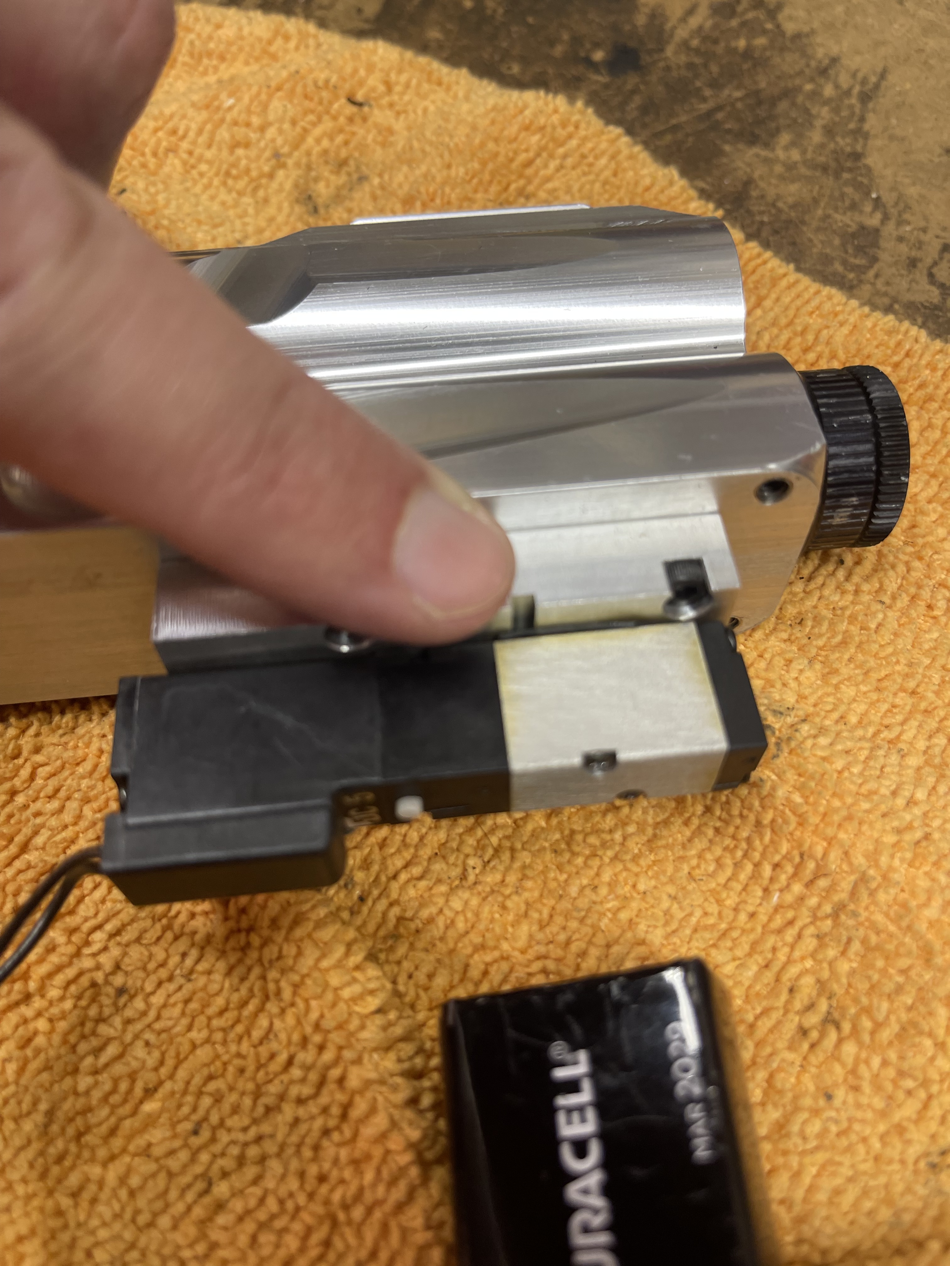

      The noid leaks out of the little cut out where I’m pointing to when I turn up the lpr. The leak gets worse the higher I go but it never cocks. It has yet to cock since I started working on it for a friend.

        That's "the bitch" hole.
        It was initially designed as a pressure relief to protect the noid from damage, but realistically there are a bunch of things that can cause it to leak though, not just LPR failure.
        Fresh manifold "o" rings?
        Are you sure the noid is attached securely to the manifold? Shit needs to be tight but not too tight or you will strip out the manifold. Use a little finesse and wizardry.
        Did you rebuild the ram?
        Ram leaks will manifest out of that hole.... unfortunately the best way to determine a bad ram is with an LPR guage or part swapping with another functional B2K. Rams are more or less unchanged with only minor details across all generations.
        Break out a lighter, rebuild and polish the ram, and report back.

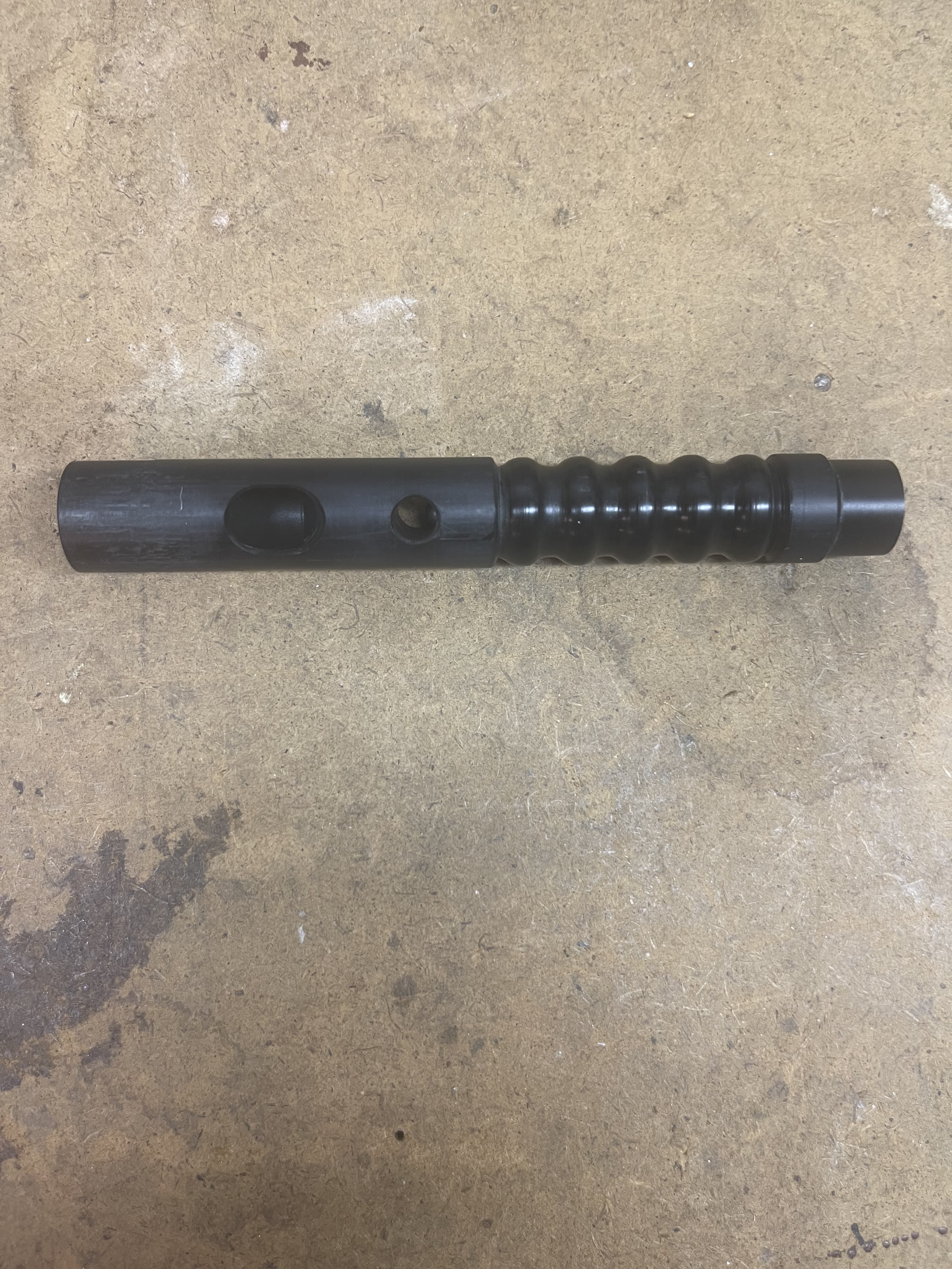

                Not sure what bolt is in this, but it’s delrin with no orings, I attached a picture.

                  I'm also not sure what bolt that is, I haven't seen one like that before, might be worth an ask in the ICD-O Facebook group.
