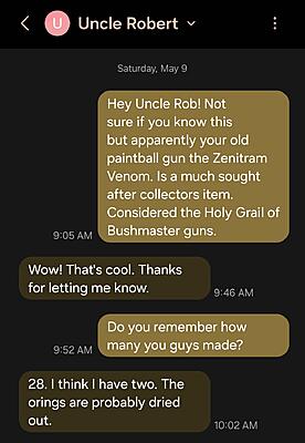

    Fun fact! Robert Martinez is my uncle. I am the reason he became obsessed with paintball back in the day.

      Next time you see him can you ask him how many Venoms were actually made?

    Oh cool! Maybe I'll see you at Jaegers Beat the Heat or Battle for Earth events this year. He was going to give me one back in the day but my mom told him not too because of how expensive it was..... still haven't forgiven her for that lol.
    Just text him this morning about it. He said they made 28 and he has 2 of them. So excluding yours there are 25 out in the wild. Was cool to let him know his gun has gone down in paintball hostory.
    He retired and sold Zenitram a few years back. So he doesn't do machine work anymore.

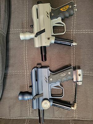

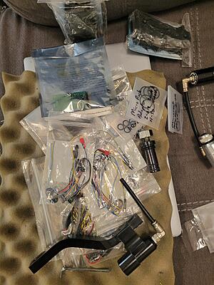

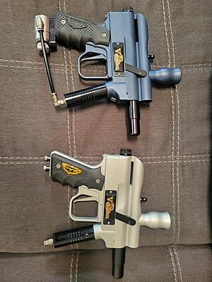

    Just a little update. My uncle is sending me both Venom's he has in storage and all extra parts he has. Will update whenever I have them.

      Here they are! Will post more pics of what all is here.
      This gallery has 3 photos.
      • Myrkul
        Myrkul commented
        Oh man! Those look incredible! They should clean rebuild perfectly!
        Looks like those are threaded for ICD barrels instead of cocker barrels?
