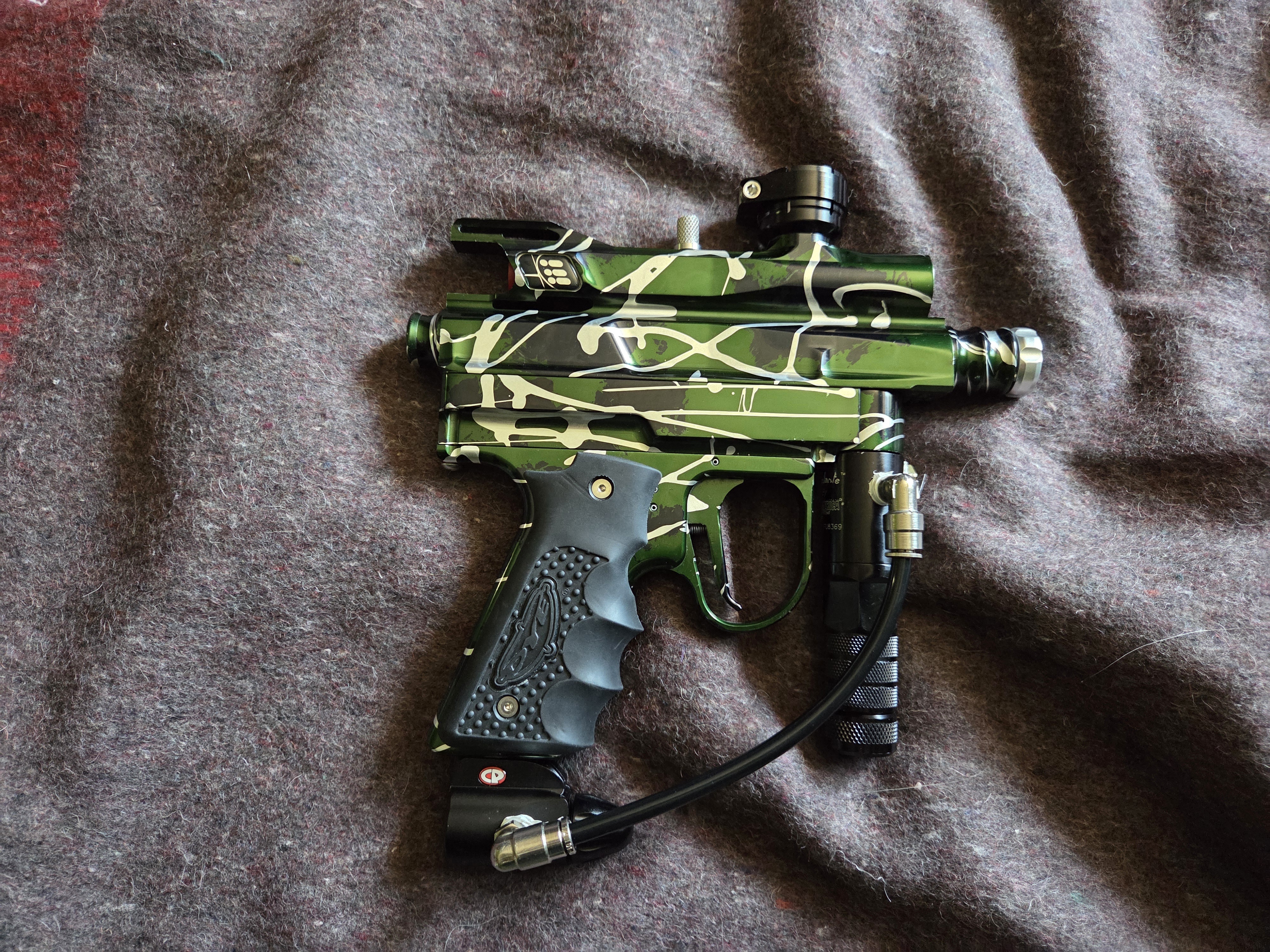

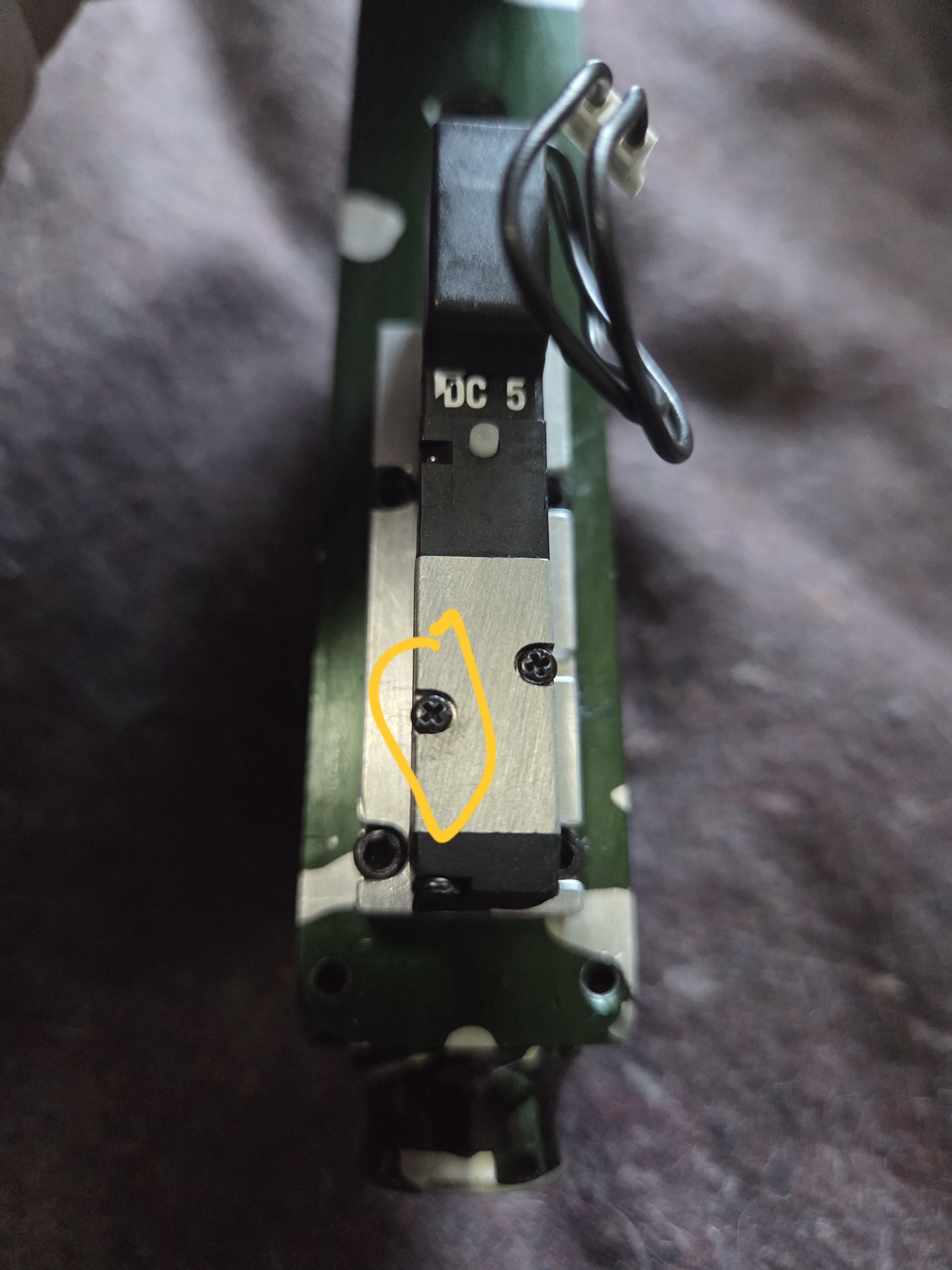

    I have a PE bushy that is leaking from the grip frame, and I noticed one of the thin machine screws that hold the noid to the block has the first few threads are worn so those first few are stripped but a longer screw would work as if the noid is removed and the screw goes deeper it's fine.
    Where am I getting parts?

      The screws are 1.6mm on the Parker Noids. I have had only limited success with repairing the manifolds on the parker noids, the later Humphrey style noids seem like they are far easier to repair. A longer screw can definitely work, it's hard finding screws that the heads work as well though, so be prepared to turn down the screw heads. You might need to buy the screw long and chop it down to the correct length.
      Honestly for an eclipse I would buy a beat up donor marker and steal the manifold.

          Full disclosure, the circled screw won't tighten.
