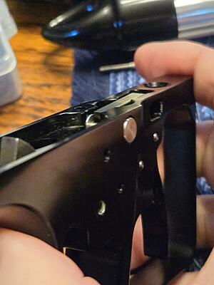

    Hello,
    I bought a used RIP hinge frame and the safety is stuck off. I don't know what to adjust to get it functional. Does anyone know how to fix?
    Thanks,
    Brandon

    Stuck as in the button won’t move or stuck because it moves and the safety doesn’t do anything?

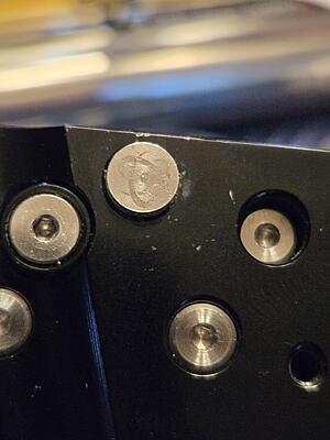

      Button won't move, has scratches from previous owner trying to force it.

            There’s a little bb that goes in the tiny hole above the safety. Is it in there and wedged oddly?

              It looks like the black plastic plate is to far rearward.

            I had the same problem. Loosen the 2 screws on the trigger. That will let the trigger plate move forward.
