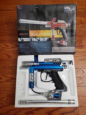

        Well, just bought one off the-bay. Seller claimed it was new, in the box, but he listed it as used as it has been sitting / kicking around all these years.
        Anything I should know when rebuilding this?

          go through all the o-rings in the marker and reg. they turn to mush after a few years.

            Well, got her in. At first I thought it was new, but found traces of old paint in the crevices, and found bolt wear (can see the anno scratched off the bolt where it passes by the feed neck). Either way, I'm happy for the $60 I spent.
            Where is the regulator on these? Is it in the chrome section of the fore-grip? Or in the ASA bolted to the drop forward?
            Considering one of the dirrect bolt CP on/offs for the ASA, and unsure of what i want for the grip regulator. And yes, I'm aware of the funky spyder bolt pattern.

              The regulator is the part with the gauge.

            Hobbes , so if I get an HPA tank with a built in regulator, and set the output to 700-800ish PSI, i can in theory eliminate that regulator and use a standard ASA? Then use the adjustable bottom tube cap to set my velocity?
            Or should I run a standard ASA with a regulator front-grip, like an Autococker would?

              You shouldn't need a regulator. And most tanks are going to be preset around 850psi unless you spend more on an adjustable, but you really shouldn't need that. Yes you use the adjustment on the back to set velocity, if you can't get it in the proper range, then you can pick up a spring kit for cheap to get you dialed in. Of course if it's shooting to high you could always cut the spring down a little at a time with the adjuster all the way loose, until you're shooting just a hair low, then use the adjuster to bring you back up where you need to be.
            • 4251
            I personally would remove the stock ASA reg and use a reg in the vert ASA. The stock regs aren't great and are no fun to work on.

                Throw a tank on it. Delete the regulator with a Spyder asa. Go play. My son uses my Spyder extra that I bought back in 2001 still to this day with a 68/4500. No issues. That reg is more of an issue than it’s worth.

                      Thanks for all the help guys. I think I'm gonna have CP throw up on this gun lol. Planning on a gas-thru grip, drop, on/off ASA, and a 10" barrel.
