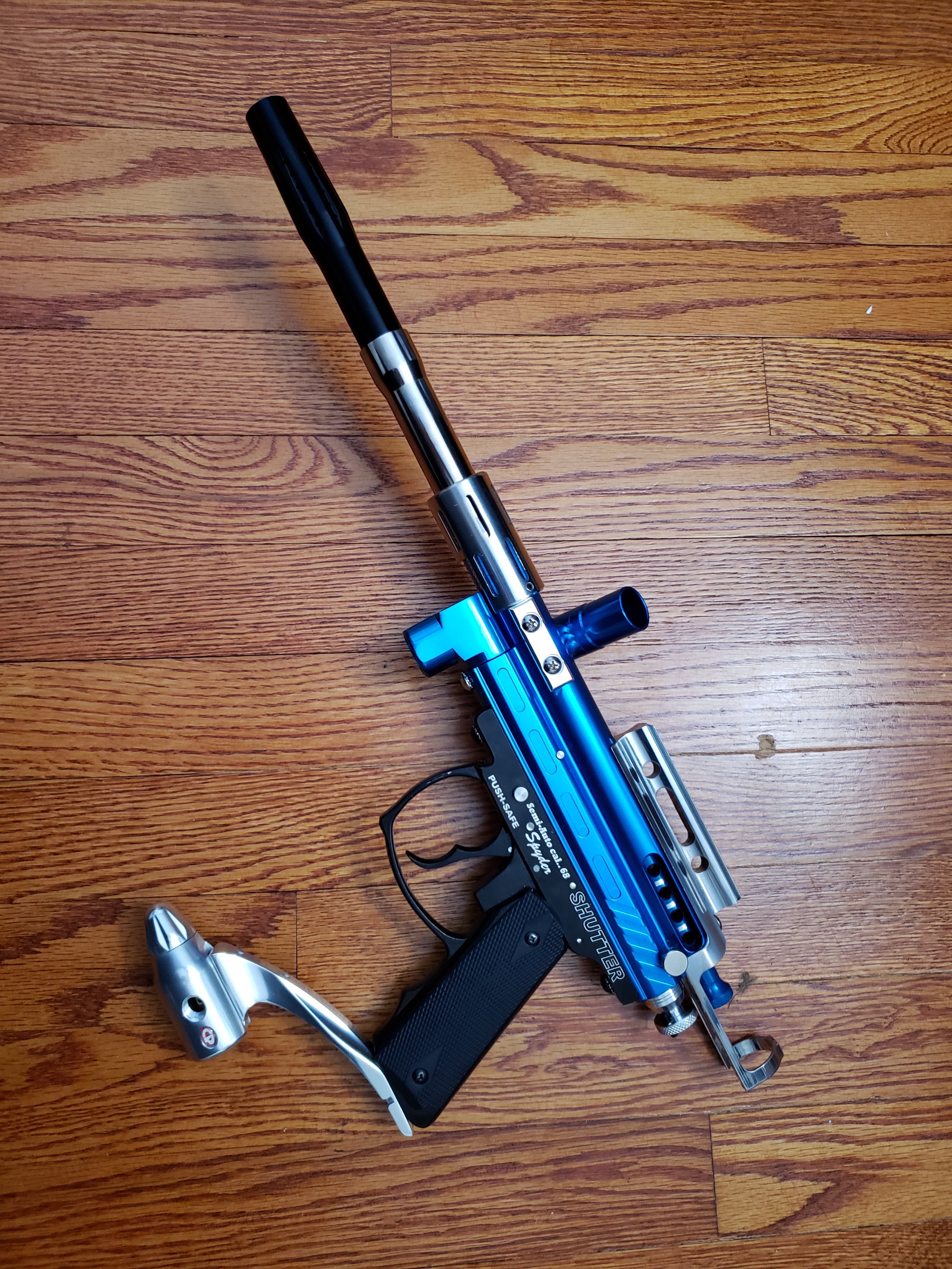

    And here's a pic of where I'm at so far. Coming along nicely if I do say so myself lol.
    • Tarsun2
      • 1029
      shouldn't be any loc-tite, glue, sealant, or setscrew there.

          What I found most interesting, was the condition of the O-Rings on the LPC, as well as the O-Rings on the vertical grip adapter block thingy (the piece the LPC screws into). All the O-Rings looked to be in really nice shape, which makes me think someone was in there not too long ago.
          The ball detent also looked to be in like-new condition, so either replaced or it just wasn't used much. Has a black, round, pin & disc style one.
