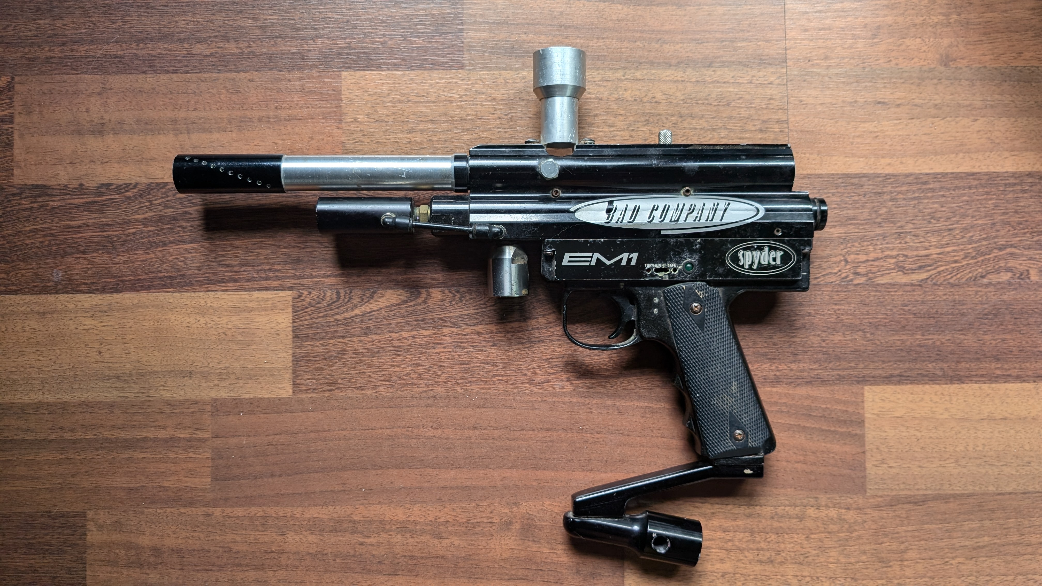

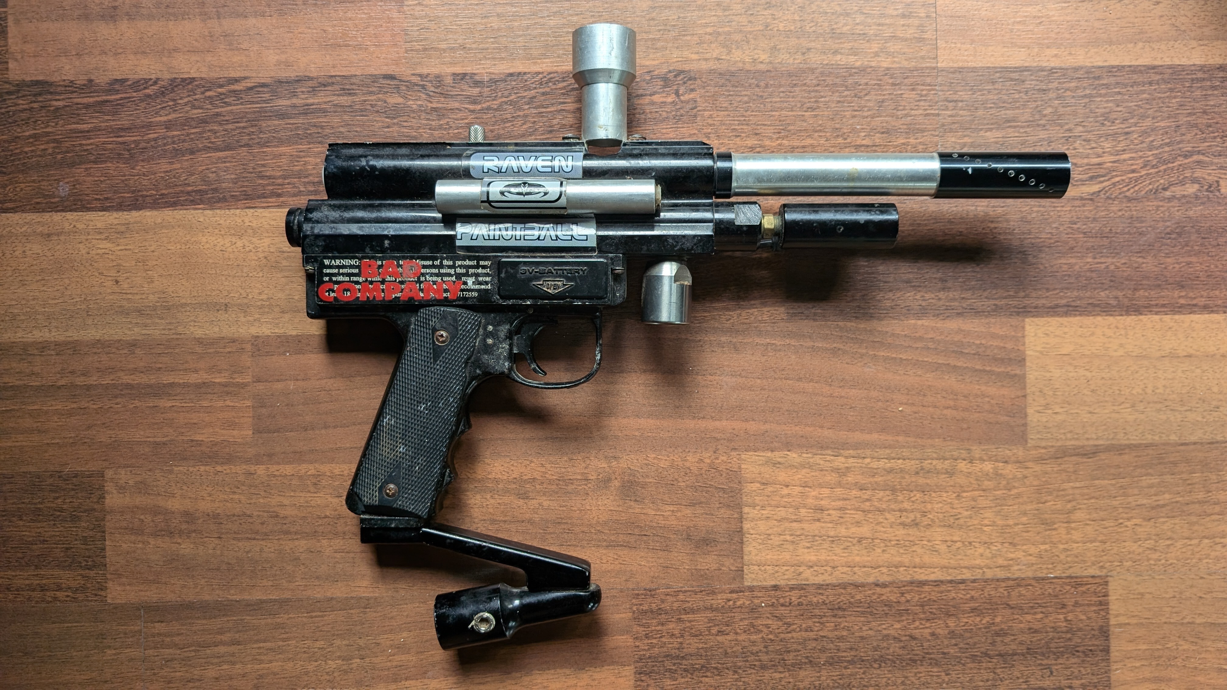

    So my birthday was this weekend and I had a party on Friday night. Had a bunch of people over, most of them ballers from my team. A few months ago I put a post on FB:
    "Don't forget... My birthday is coming up and I'm a size Tom Cole's Bad Company, 1 of 1, EM1. 😉"
    It included the link to the Bacci listing thought It would be just a fun joke post. Joke was on me because my wife bought it and that was that! Click image for larger version  Name:	PXL_20240720_133859439.MP.jpg Views:	1 Size:	2.75 MB ID:	569108 Click image for larger version  Name:	PXL_20240720_133910692.MP.jpg Views:	1 Size:	2.44 MB ID:	569109

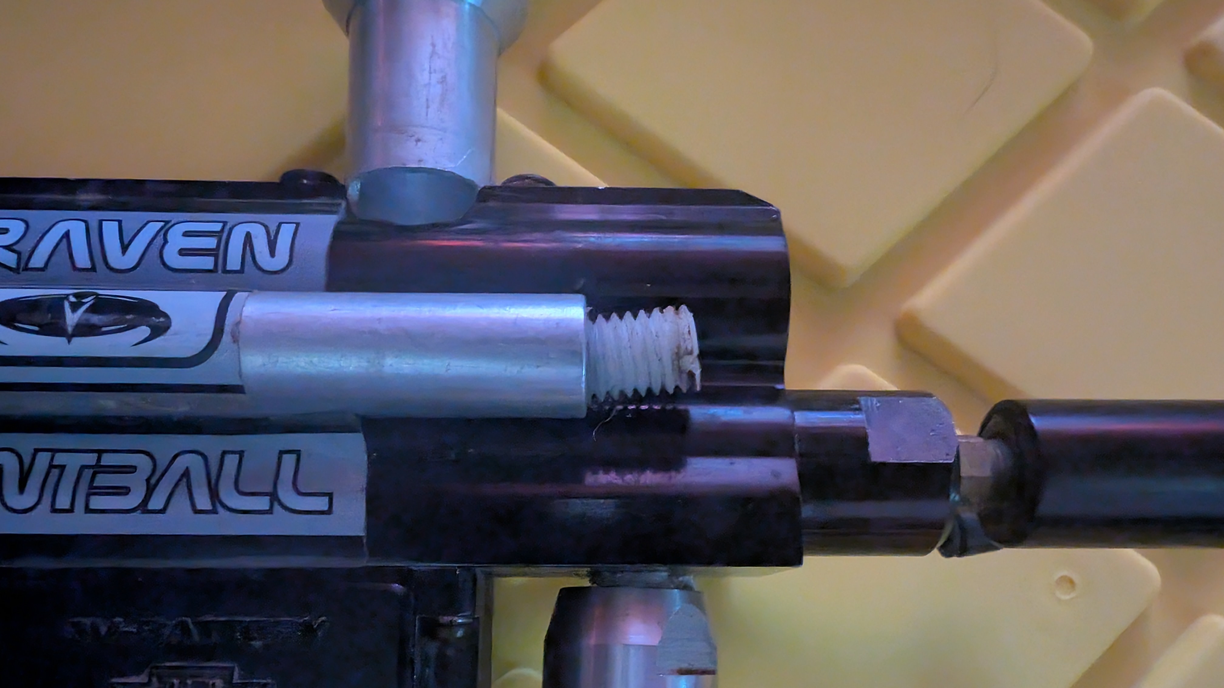

    Starting with the top tube:
    Bolt is a full Bushy bolt. The myths about the EM1 converted to a full Bushy 2000 (not a FASOR to a full 2 way ram) are unfortunately unfounded.
    Click image for larger version  Name:	PXL_20241222_024502631.MP.jpg Views:	0 Size:	650.2 KB ID:	635025

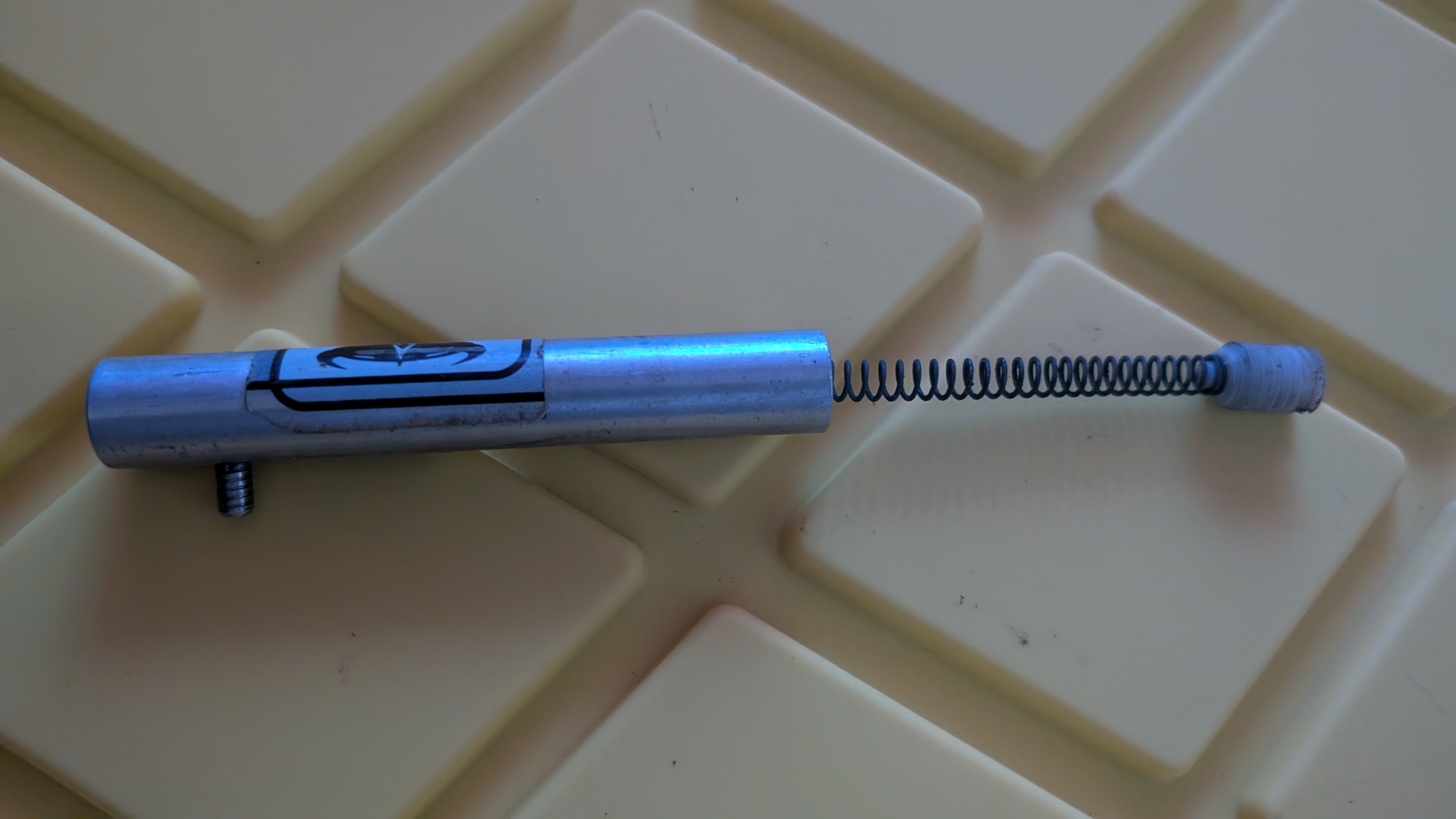

    So how does it return?
    The passenger side mystery tube! It's a return spring. It seems to be more consistent vs the original backcap spring setup. (won't know till this is fully rebuilt and field tested.)
    Click image for larger version  Name:	PXL_20241222_025030857.MP.jpg Views:	0 Size:	692.2 KB ID:	635026
    There is a threaded rod into an aluminum piston (non-sealing) that's held in by a delrin threaded plug on the front side. The threaded rod goes into a milled slot and works as the return mechanism for the ram. This is mounted via 2 small screws coming in from the driver's side.
    Sorry, no pics of the slot.

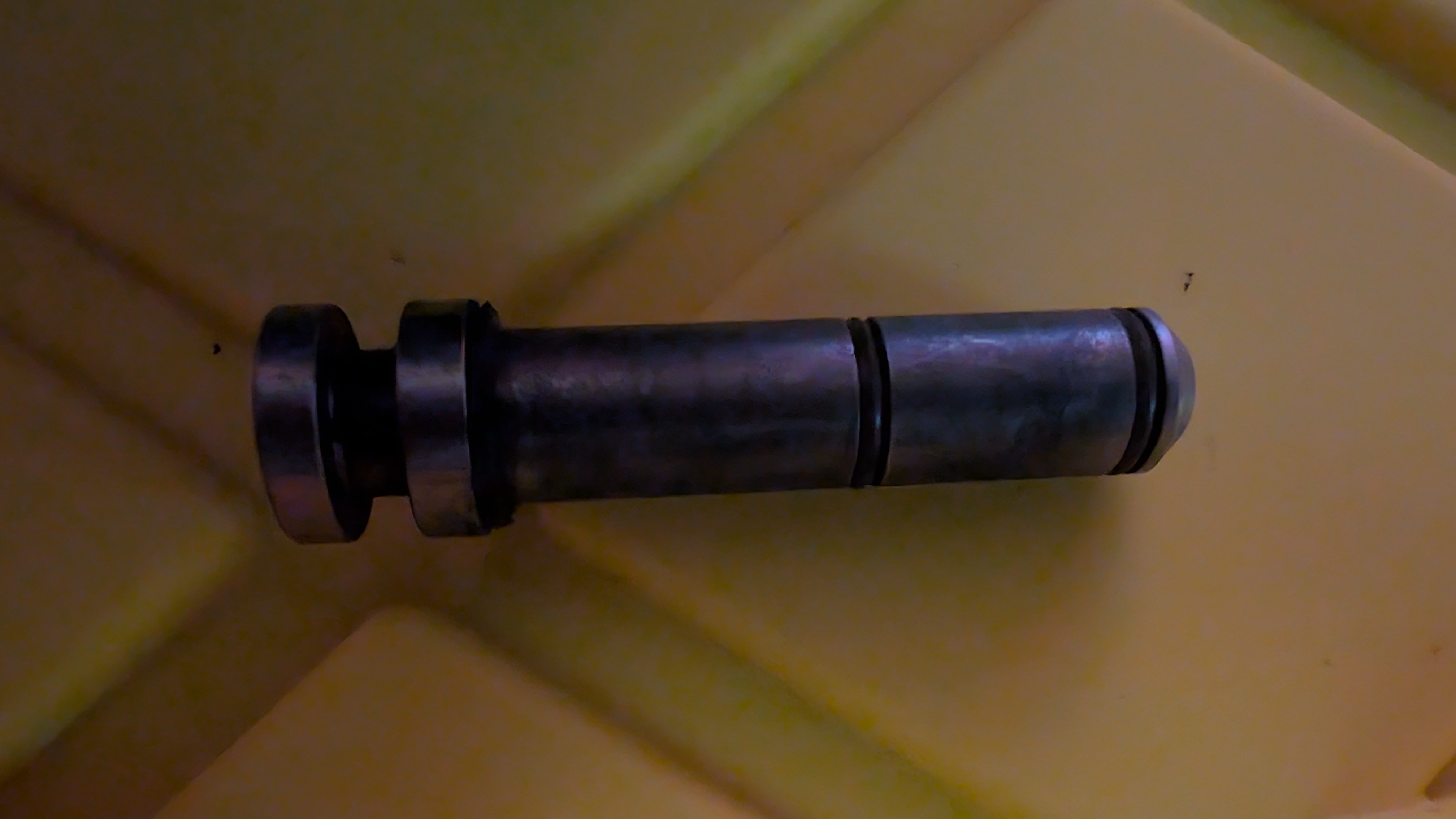

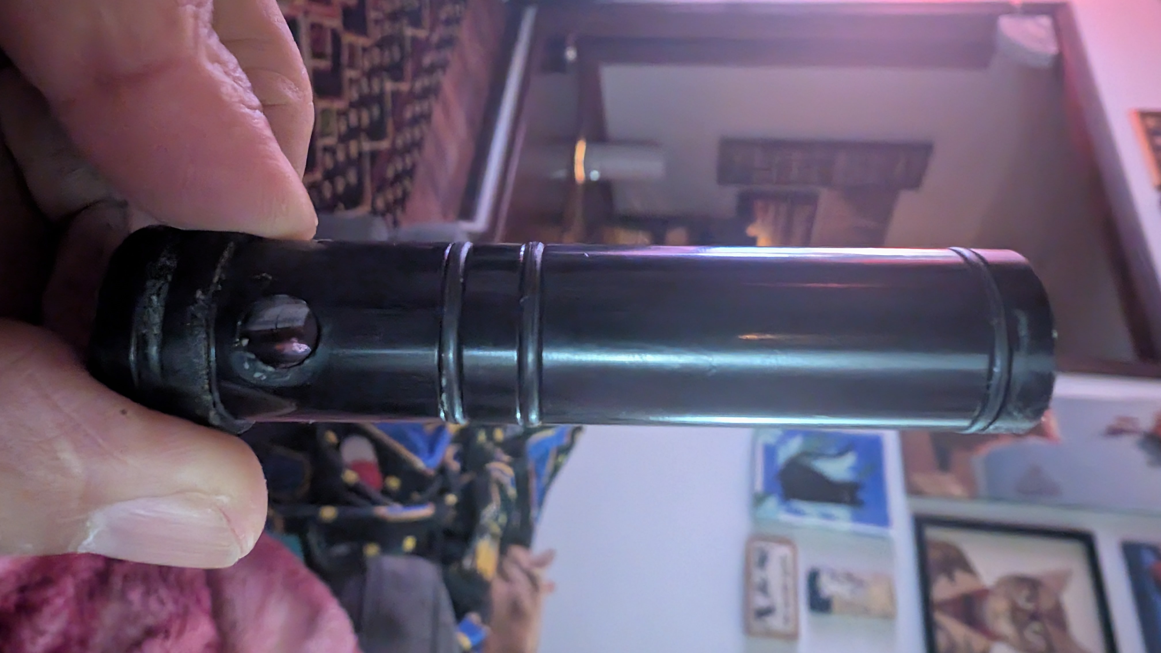

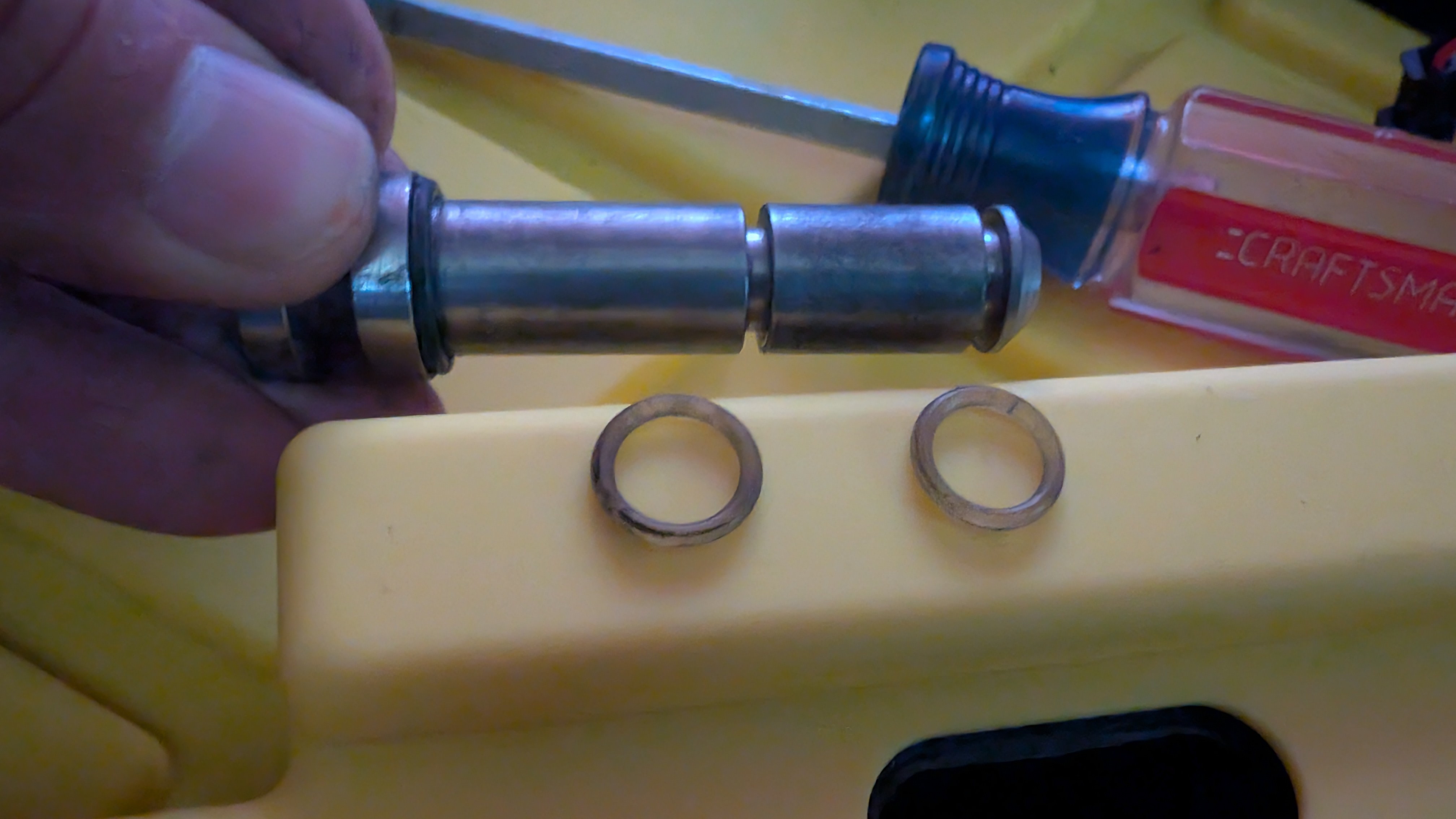

    Moving to the ram:
    Orings on the sleeve were good.
    Click image for larger version  Name:	PXL_20241222_024748232.MP.jpg Views:	0 Size:	1.00 MB ID:	635030
    The ram, not so much. They were gummy, but not goop.
    Changed them out and if I held my thumb over the inlet/outlet holes on the sleeve, it snapped back when pulling pulling the ram out.
    Click image for larger version  Name:	PXL_20241222_033304459.MP.jpg Views:	0 Size:	880.9 KB ID:	635035

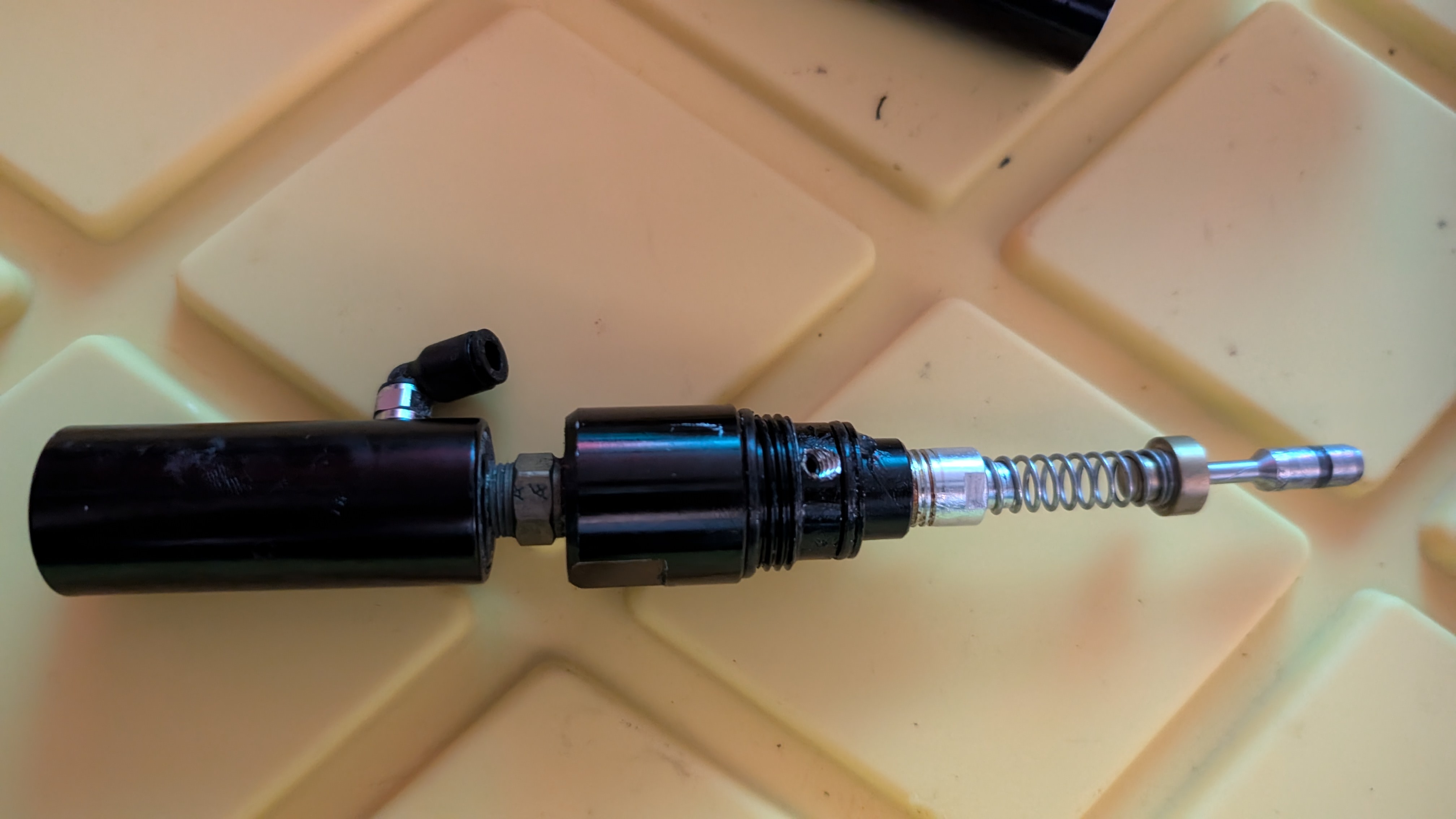

    Continuing with the lower tube:
    The LPR was gutted and red loctited. A new air path was drilled in and a corresponding hole into the body was added. This is where the Rock Reg was added via hoses to the small PTC connectors on the Driver's side. (Rock needs to be rebuilt, I think... Will cover this in a later post along with the noid.) Valve stem, spring, oring all stock and the oring looked fine.
    Click image for larger version  Name:	PXL_20241222_055923049.MP.jpg Views:	0 Size:	765.9 KB ID:	635034

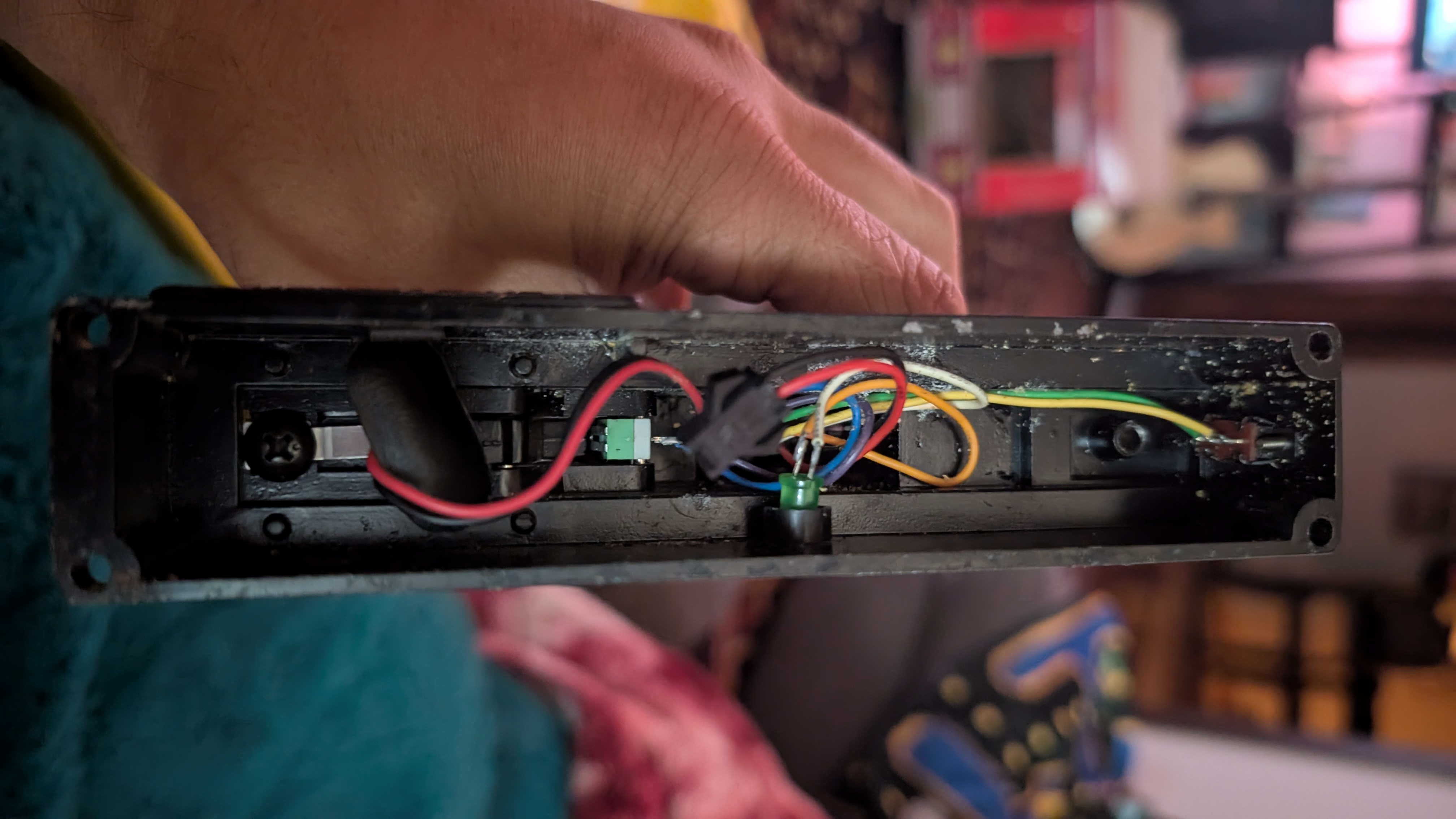

    Pretty stock. Board is the OG Red board. The power switch was moved to the rear with an on/off latching button.
    Click image for larger version  Name:	PXL_20241222_030005801.MP.jpg Views:	0 Size:	1.07 MB ID:	635031

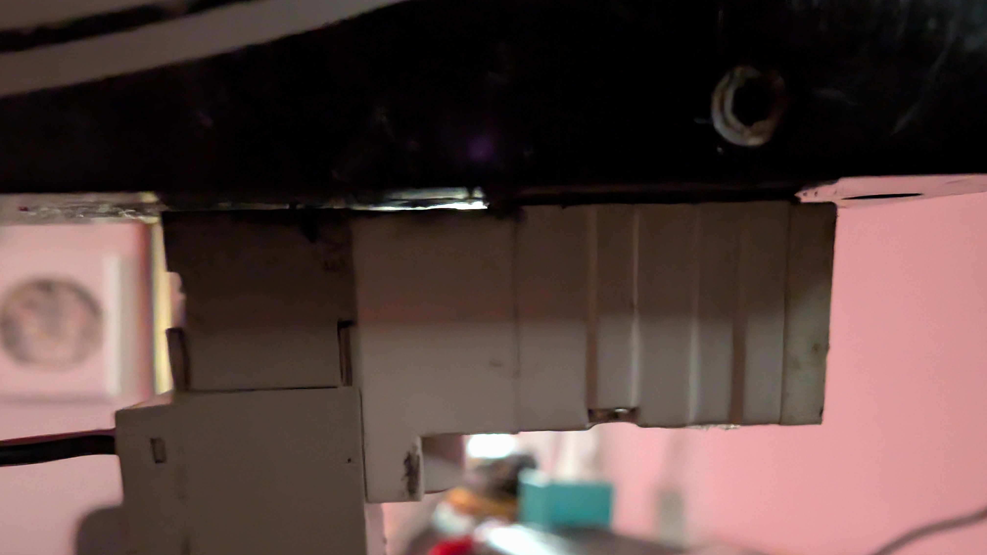

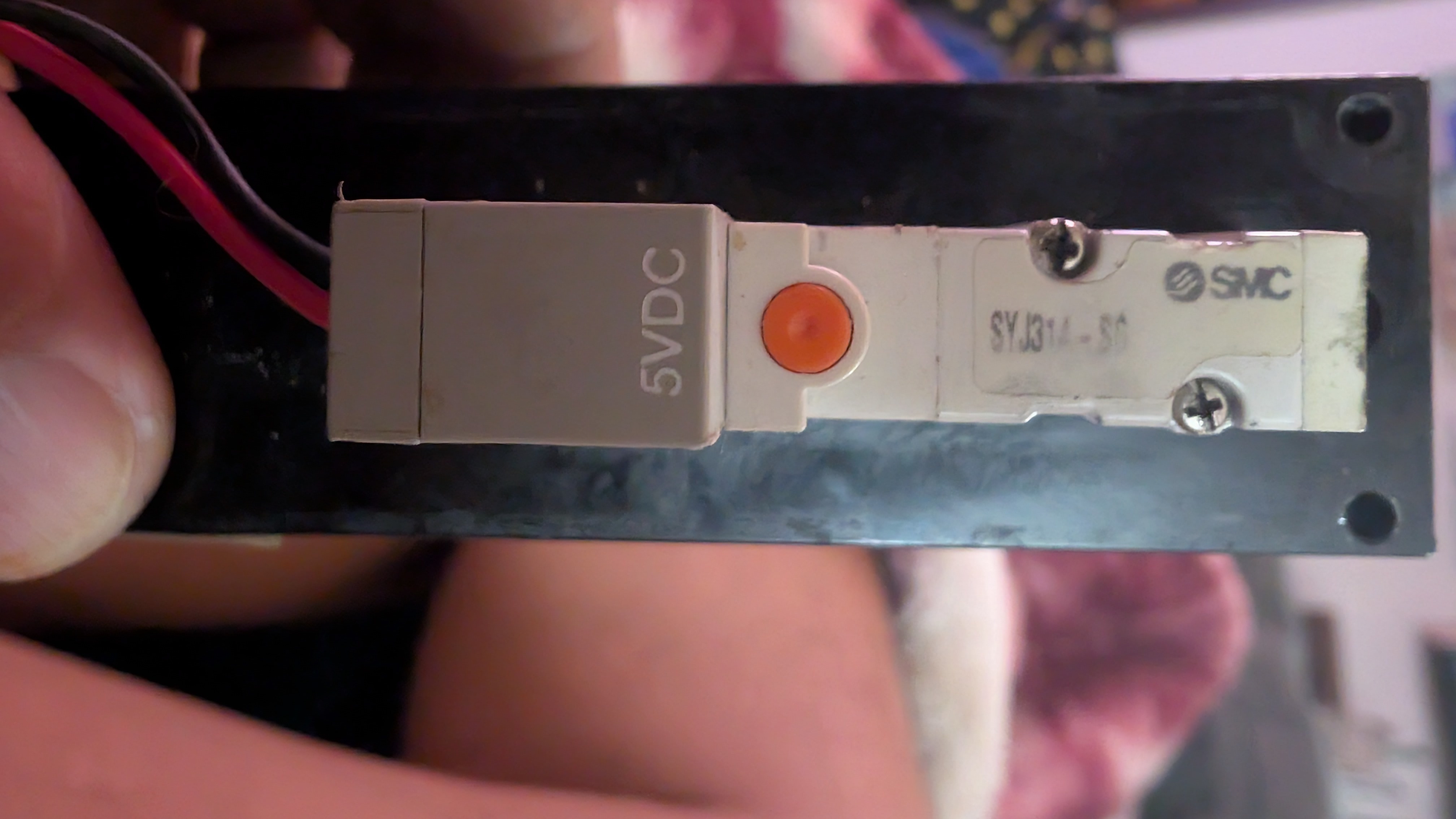

    Since we are in the tray, let's move onto the solenoid:
    Sad news here. The stock SMC SYJ314-SG seems fine. I can hear it faintly click, as this noid doesn't make too much noise on a regular EM1.
    Click image for larger version  Name:	PXL_20241222_032051239.MP.jpg Views:	0 Size:	882.6 KB ID:	635032
    The sad part is the gasket that mounts to the body. It looks like it's degraded and mushroomed out from the screw stress. Likely dead since I can see light in areas that I don't see on my original EM1.
    Click image for larger version  Name:	PXL_20241222_031716678.MP.jpg Views:	0 Size:	739.3 KB ID:	635033

            Very cool, congrats dude. What's the silver ram-like thing on the passenger's side?
            • ChoSanJuan
              ChoSanJuan commented
              I think it's for the fasor return... The bolt is a full on Bushy bolt so there is no back cap with the spring. There's so much speculation, even from back in the day, that it was a 2 way ram or a spring return or some other secret sauce thing. Nobody will ever know till I crack this thing open. (hopefully NOT doing any damage to threads or slots in the process!)
