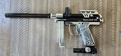

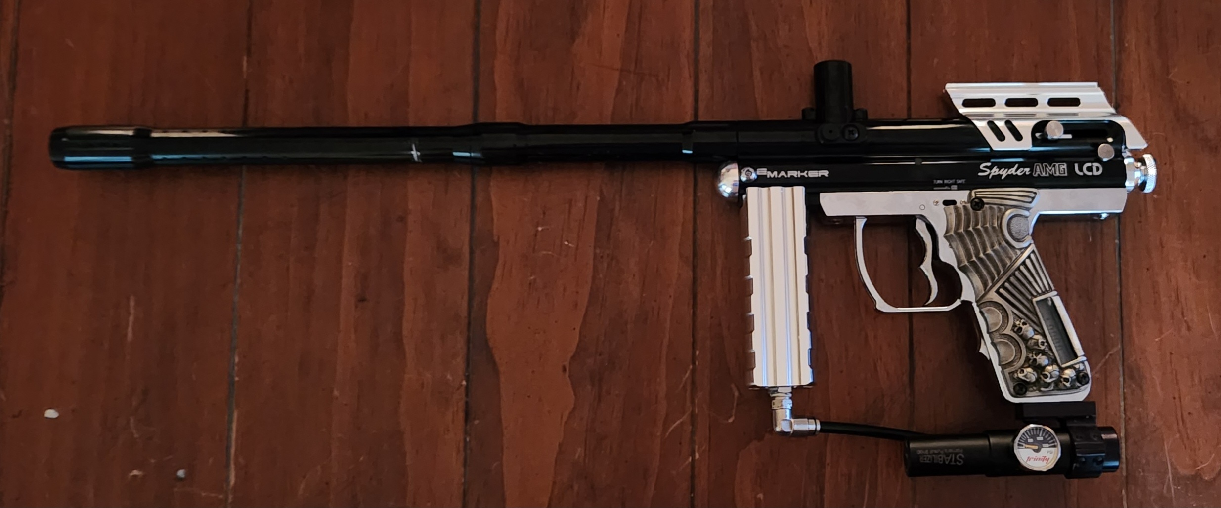

    An AMG LCD popped up somewhat recently and I just couldn't resist. I've been after one of these for a long time. Barely used, in excellent condition.
    Tossed in a balance valve and strike, and female stab. Just need the right spring combination.
    Hoping to play around in the 200psi zone for fun and giggles.

      Waiting on some new springs to arrive. Got it sorta cycling on the remaining springs I had from other projects but the operating pressure was too high for the balance valve, closer to 400.
      I plan to use the black valve and black hammer spring from one of the warrior/32 degree spring kits.

      She lives and is a beast. attached a short video in the first comment.
      Shooting ~285 at what looks like 220 psi. Really nice to shoot.

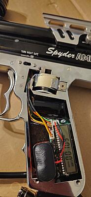

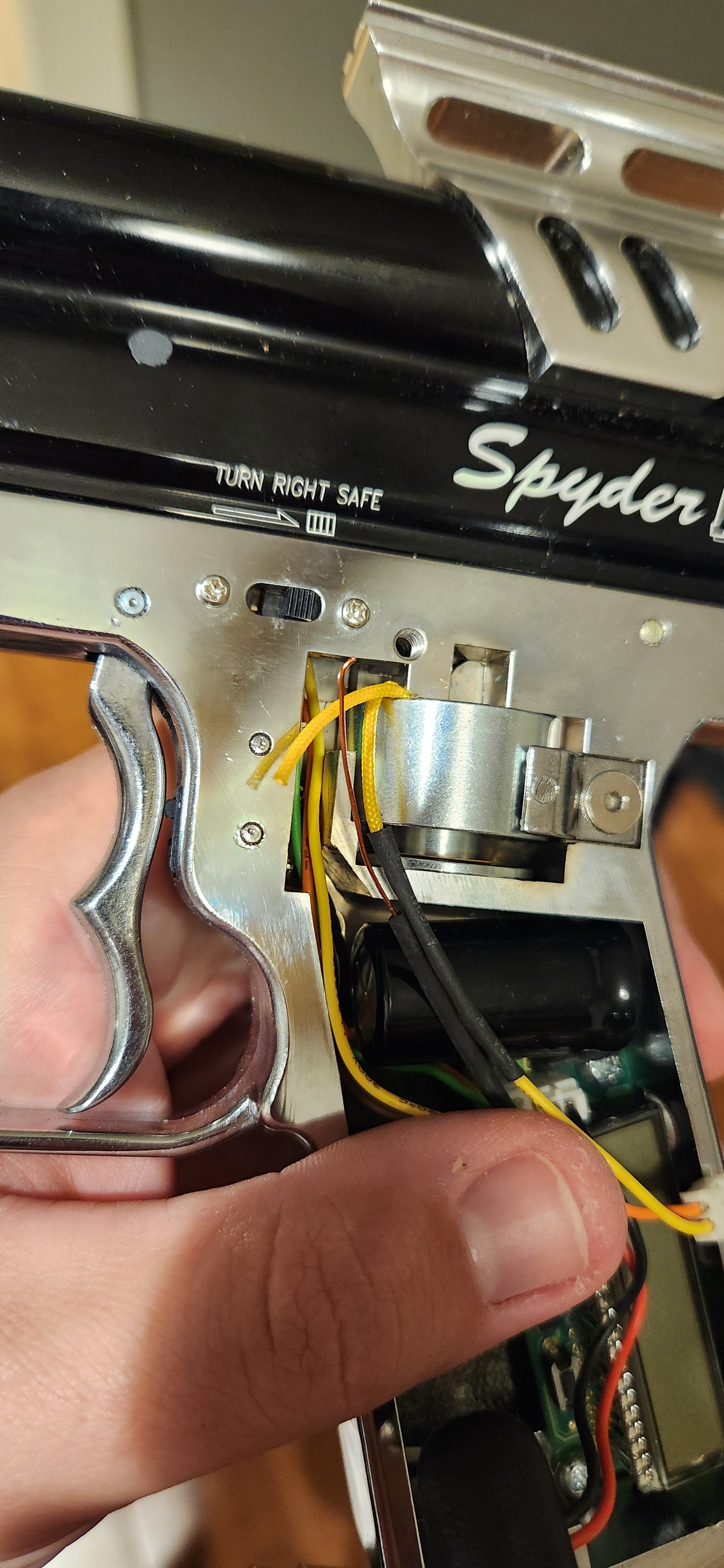

            Maan.... planned a day out at the field Sunday and something was super weird with the board.
            Batteries acting funny, board switching off and on, cap not clacking when it should clack.
            Wire apparently separated from the noid...
            Don't have time to repair by tomorrow...
            Bummer...

                Got it fixed and working great again. I'll know now not to touch the wiring again as it doesn't like manipulation with that bend to it.
                I was tinkering with the trigger and switch which I guess put too much play into the wire. I won't tinker anymore with this gun.

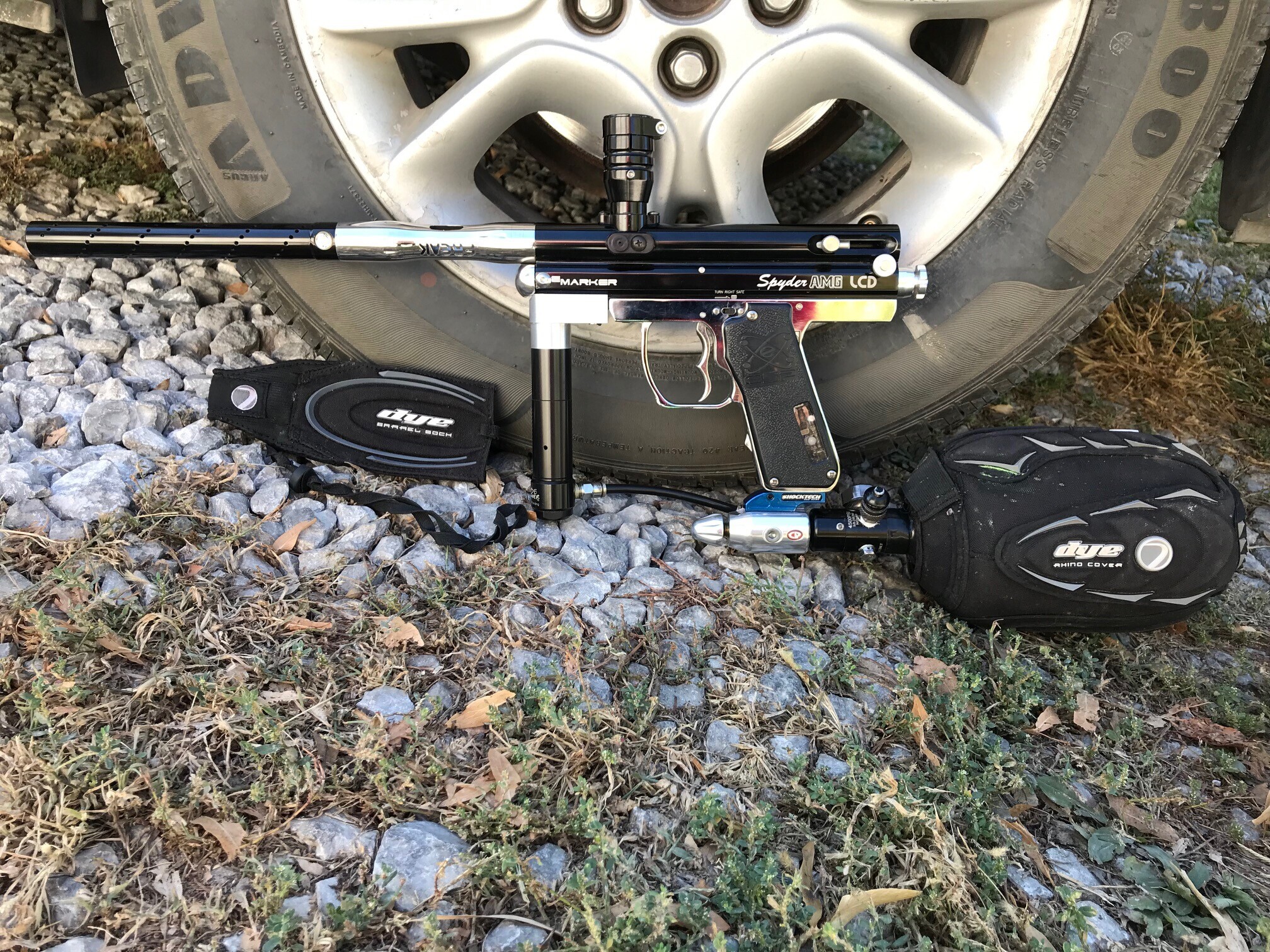

                  I had one of my AMG's out yesterday at the field.
                  image.jpg​
