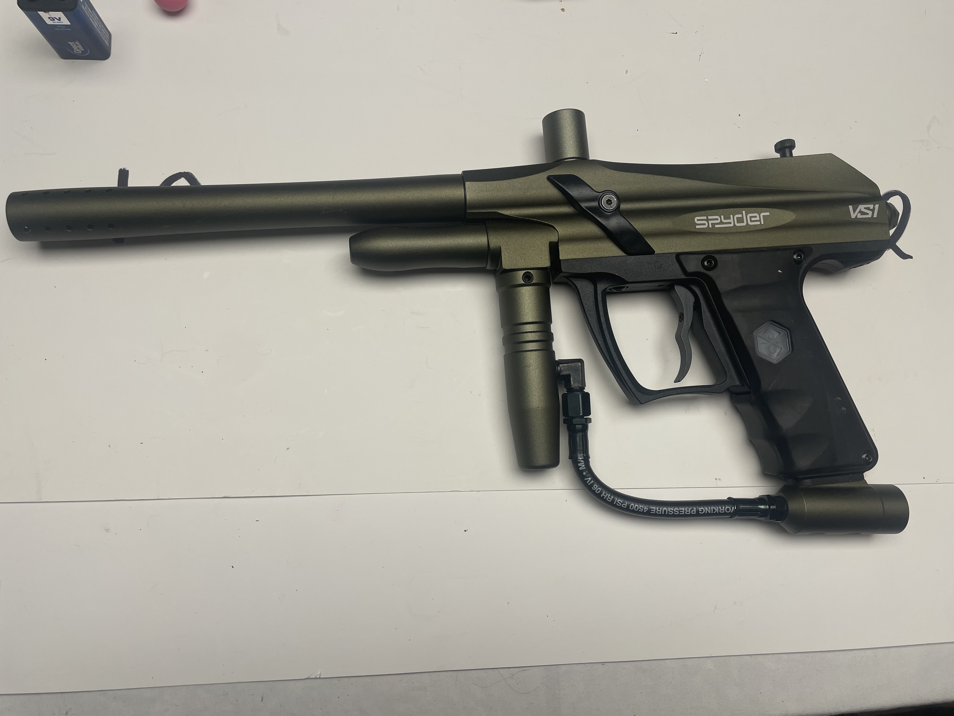

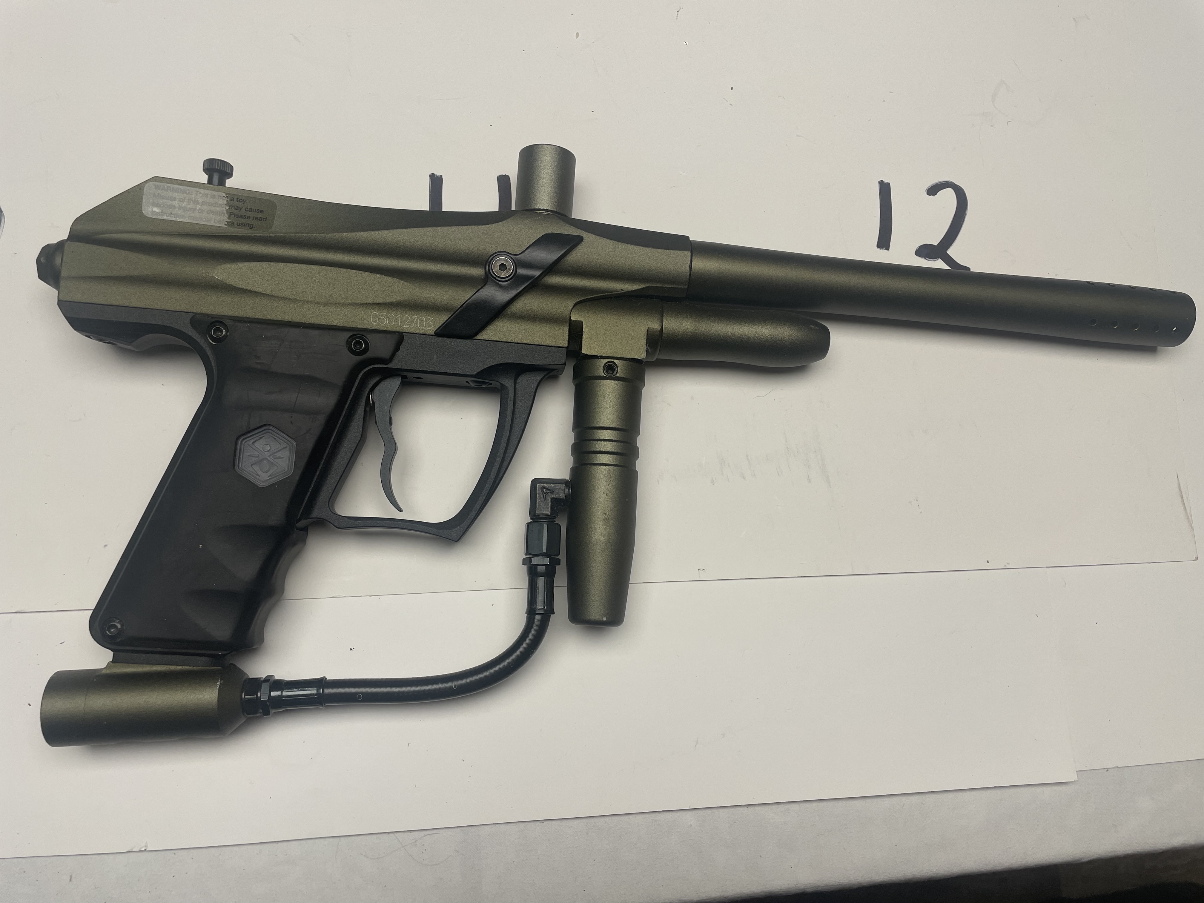

    Just had a vs1 handed to me. Bolt is missing entirely. Looking for a replacement option. I looked on ans and there was nothing that said it worked for the vs1. I emailed them about a top cocking bolt for a fenix and they said it was different. Google search also wasn’t coming up with anything. I want to rebuild it and have it as a backup for some woodsball. If you know of anything, please let me know.
    thanks,
    Jake

      It looks like it might be something different. Compared to my pilot bolt, there’s no groove to connect the bolt to the striker. The vs looks like maybe the cocking knob goes all the way through the bolt into the striker.
        • 6182
        Take a look at this. I think it might work. The mr100 was released right around the same time as the vs1 so it would make sense that they recycled the bolt
        https://hustlepaintball.com/kingman-...ing-knob-semi/
