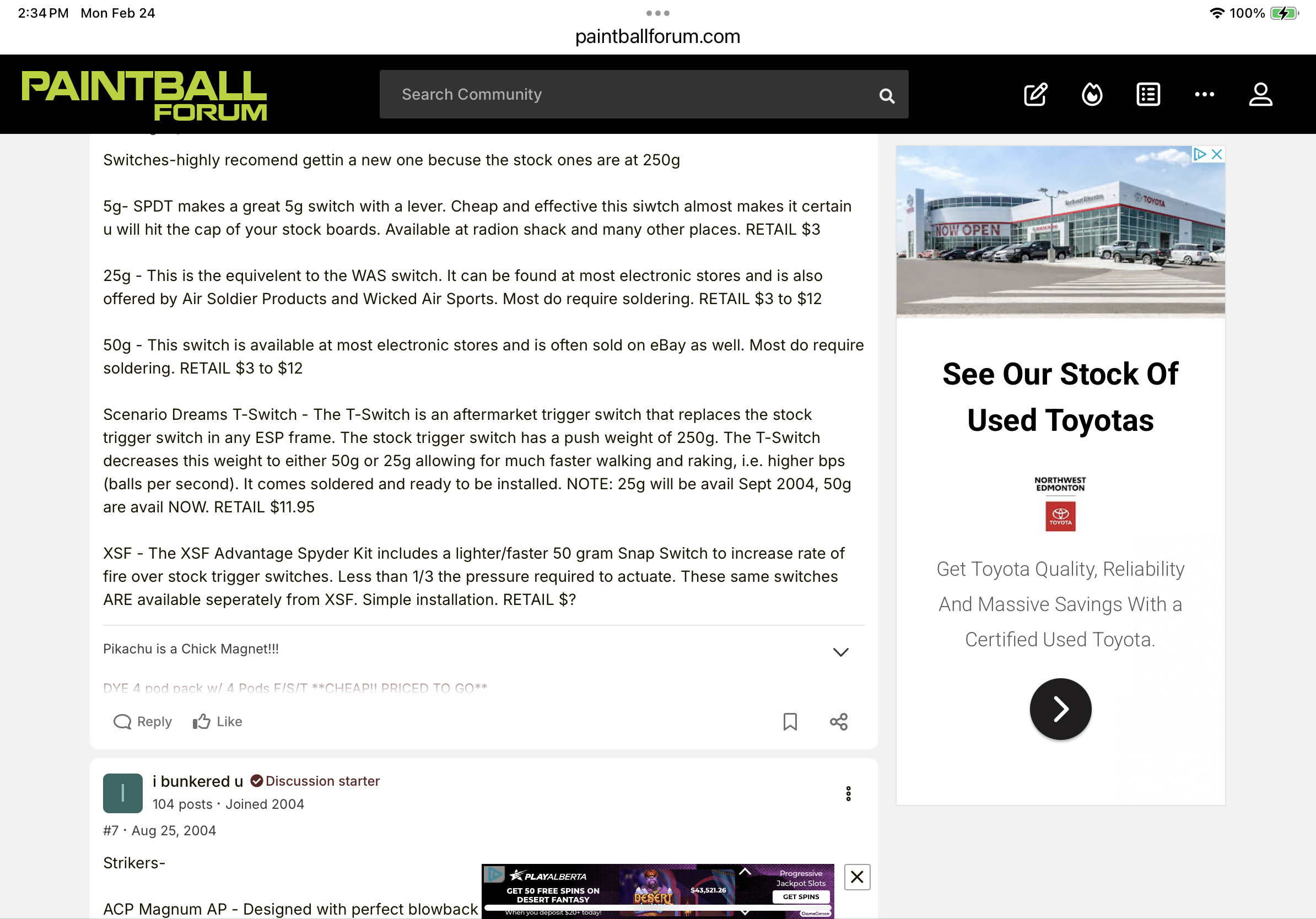

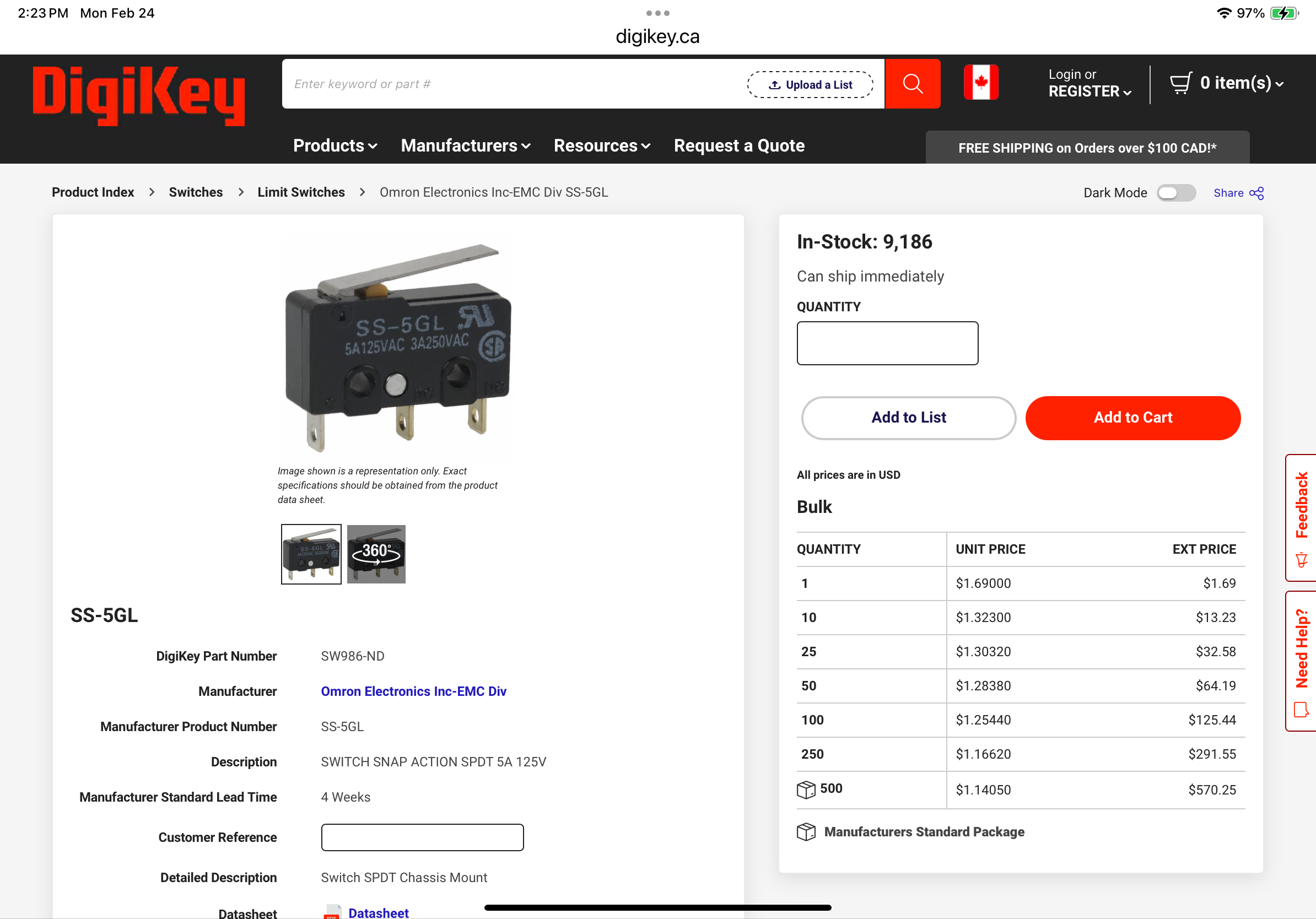

    Can someone recall the model number of the replacement microswitch for an e-grip. Specifically looking for Imagine or AMG direct fit replacement.

    Or this? I seem to remember Spyder switches looking like this back in the day. Activation weight isn't listed, but maybe will get you down the right path.
    Cylewet 25Pcs AC 1A 125V 3Pin SPDT Limit Micro Switch Long Hinge Lever for Arduino (Pack of 25) CYT1073: Amazon.com: Industrial & Scientific
    Also, from what I remember, stock Spyder switches were 250g. I'm not saying you don't want that, but I found that whack back in the good ole days. Then again I found out why they came with 250g switches stock lol. Things turned into MG-42 paint choppers with a lighter switch. ​Maybe Kingman was on to something.

      I replaced the micro switch years ago. I think 25g is too light for a Spyder, I do believe the stock micro is 250g. I think I used a 50 or 75 g switch.
      Digikey or radio shack had them.
