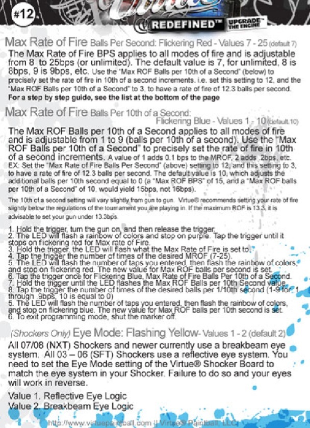

    Does anyone know the BPS valves to the Spyder Virtue board? It seems to not align with the other board valves.

      Bps input like 1 input is 7 bps, 2 inputs is 8 bps, etc

      The way the Virtue boards do bps in max bps mode isn't linear. Here is the page of the manual describing adjustments in max bps mode. You may want to stay in the flickering red light program mode and refrain from using the flickering blue light mode.
