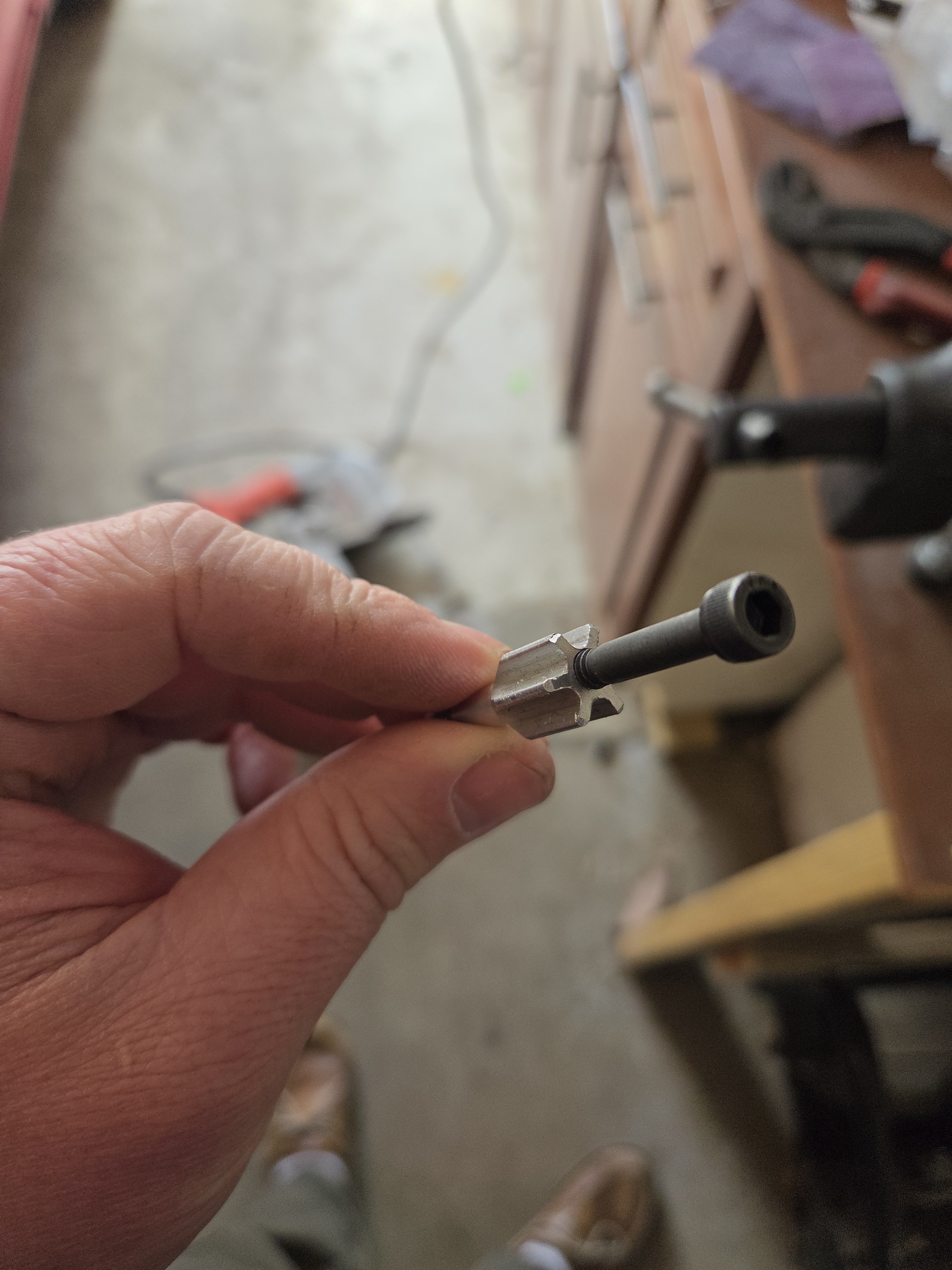

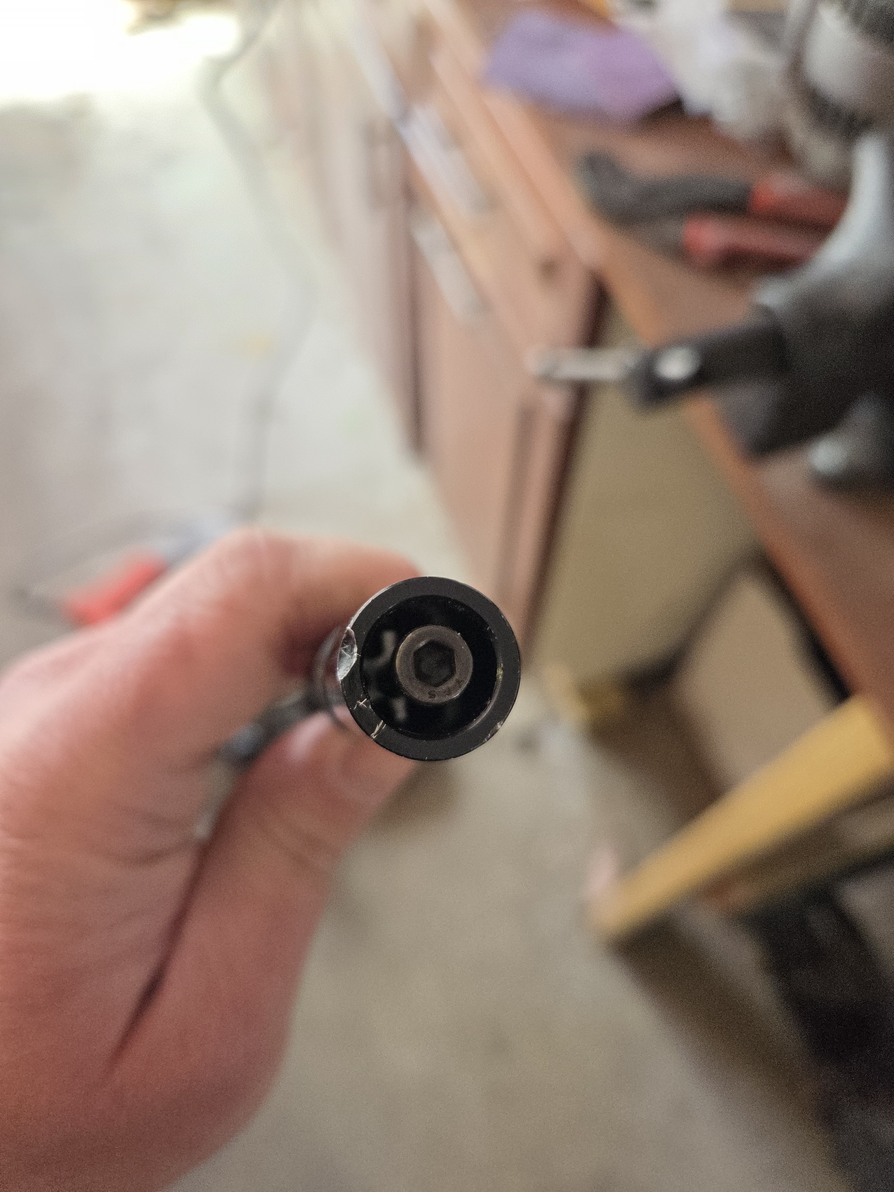

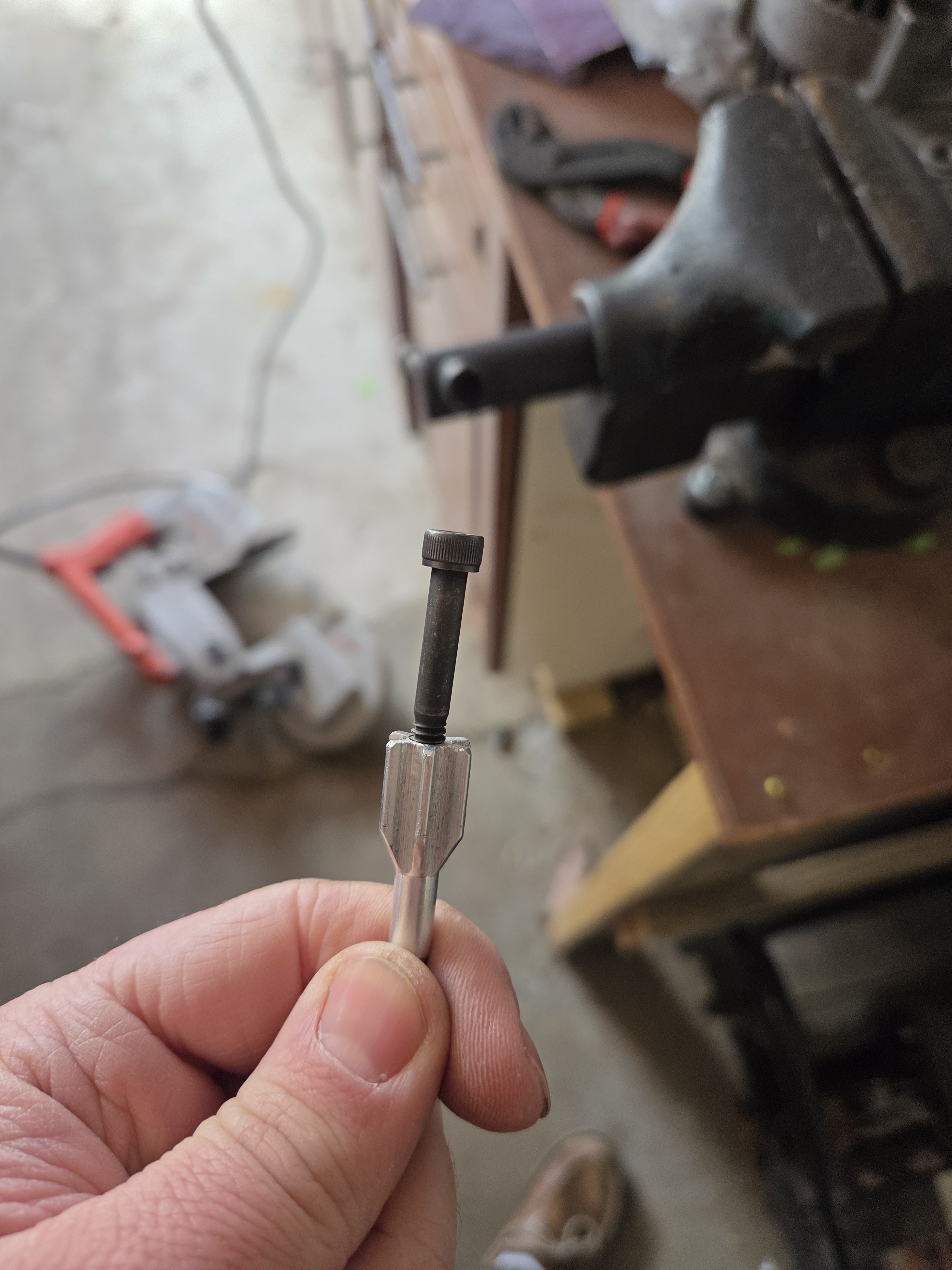

    3/22/25 Roll Back Prevention
    I had an idea while messing with the venturi last week. I thought how could I prevent the ball from rolling so far back into the bolt face? Then I thought what if the venturi was longer? So I got the idea to drill a hole in the front of the venturi and then thread it to accecpt a rod or bolt long enough to be flush with the bolt face.
    After a trip to the hardware store, I ended up with a 10-24 x 2 socket head bolt and a M6x1.0 x 75 shouldered hex bolt. I wanted to try the idea with the socket head screw first in order to keep the venturi in the mix. I drilled and tapped (poorly) the front of the venturi and cut the bolt down to size till it was flush with the bolt face while installed.
    It looked good but unfortunately that didn't cure my ills. I shot a few and velocity looked similar to last time. So far so good. Then I decided to shoot a long string as fast as possible and that's when it chopped at about 20 or so shots in. A definite stack clip as there was paint in the breech and feedneck.
    Back to the drawing board but for now here's some pictures of my handywork.

            #23

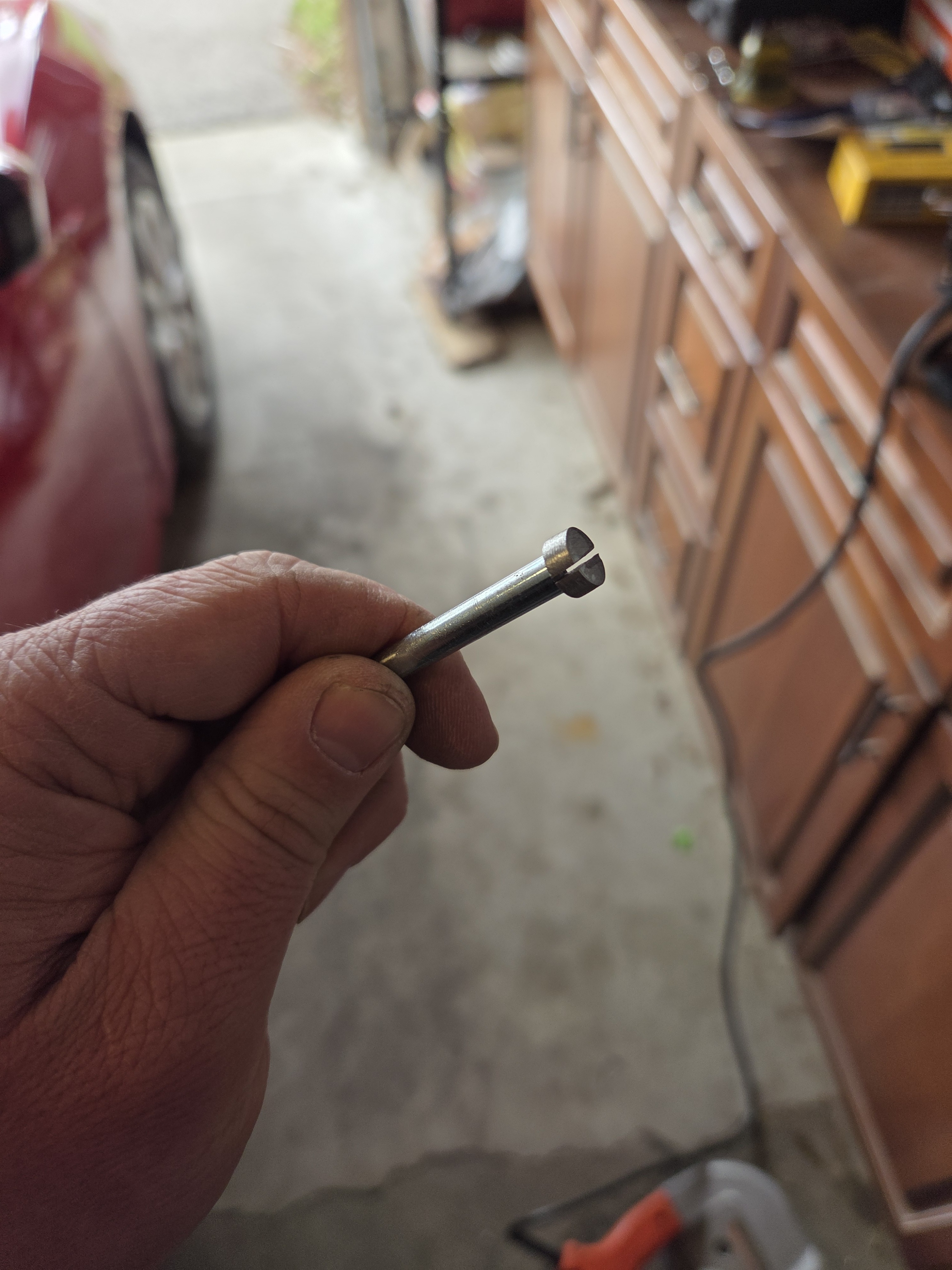

            Anti-rollback venturi v2
            This is somewhat of a refinement of my earlier idea. Basically I chopped down a stainless hex bolt to length then chucked it up in my drill and rounded off the hex part then cut a slot so I could get it out again. I found some small rubber discs that happedlned to be the right size and glued one to the head of the bolt.
            It looked good at first but testing didn't go so well. I shot a couple handfulls using a gravity hopper with no chops. However, using the Vmax once again made the gun a blender. Back to the drawing board.

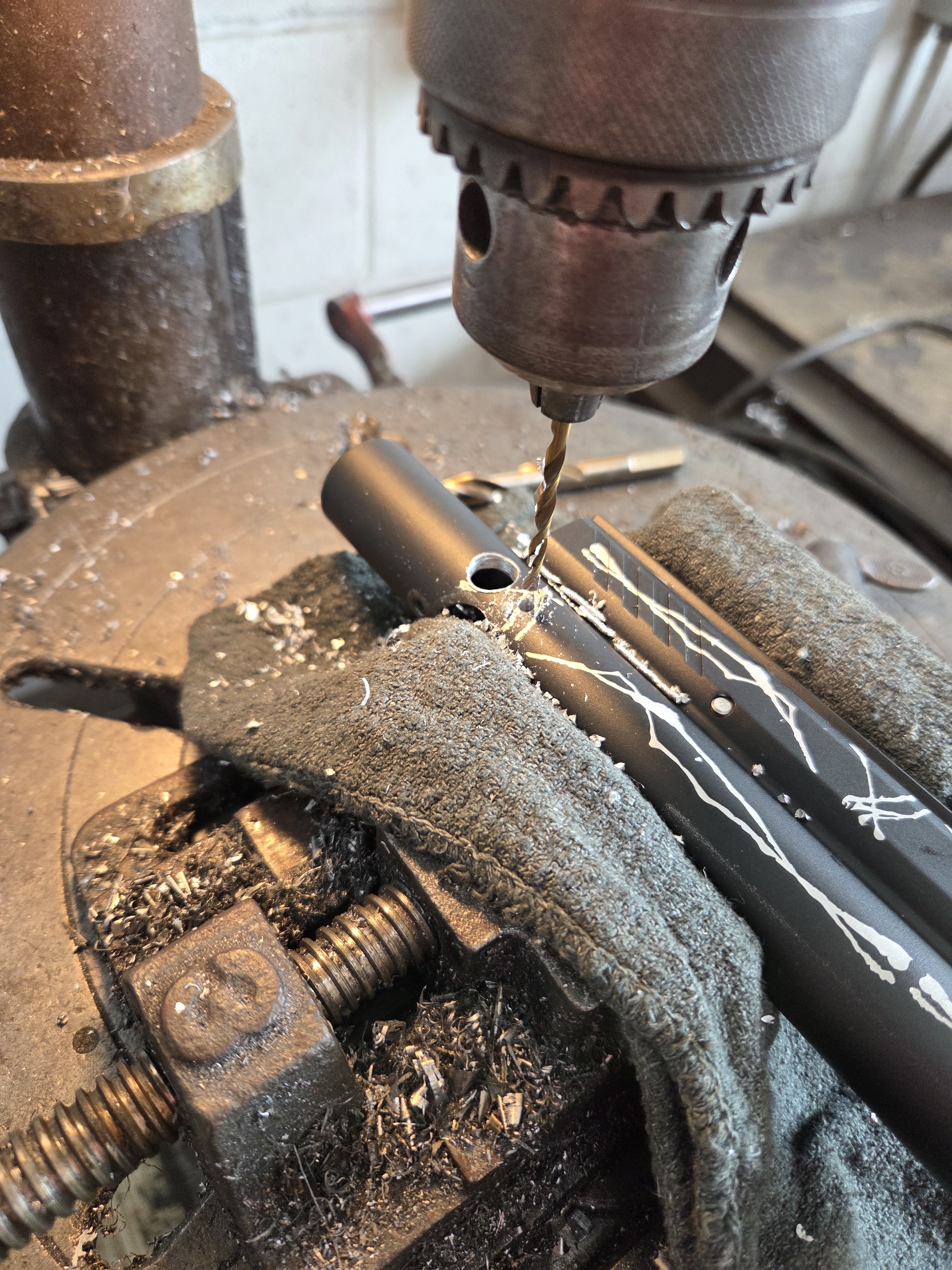

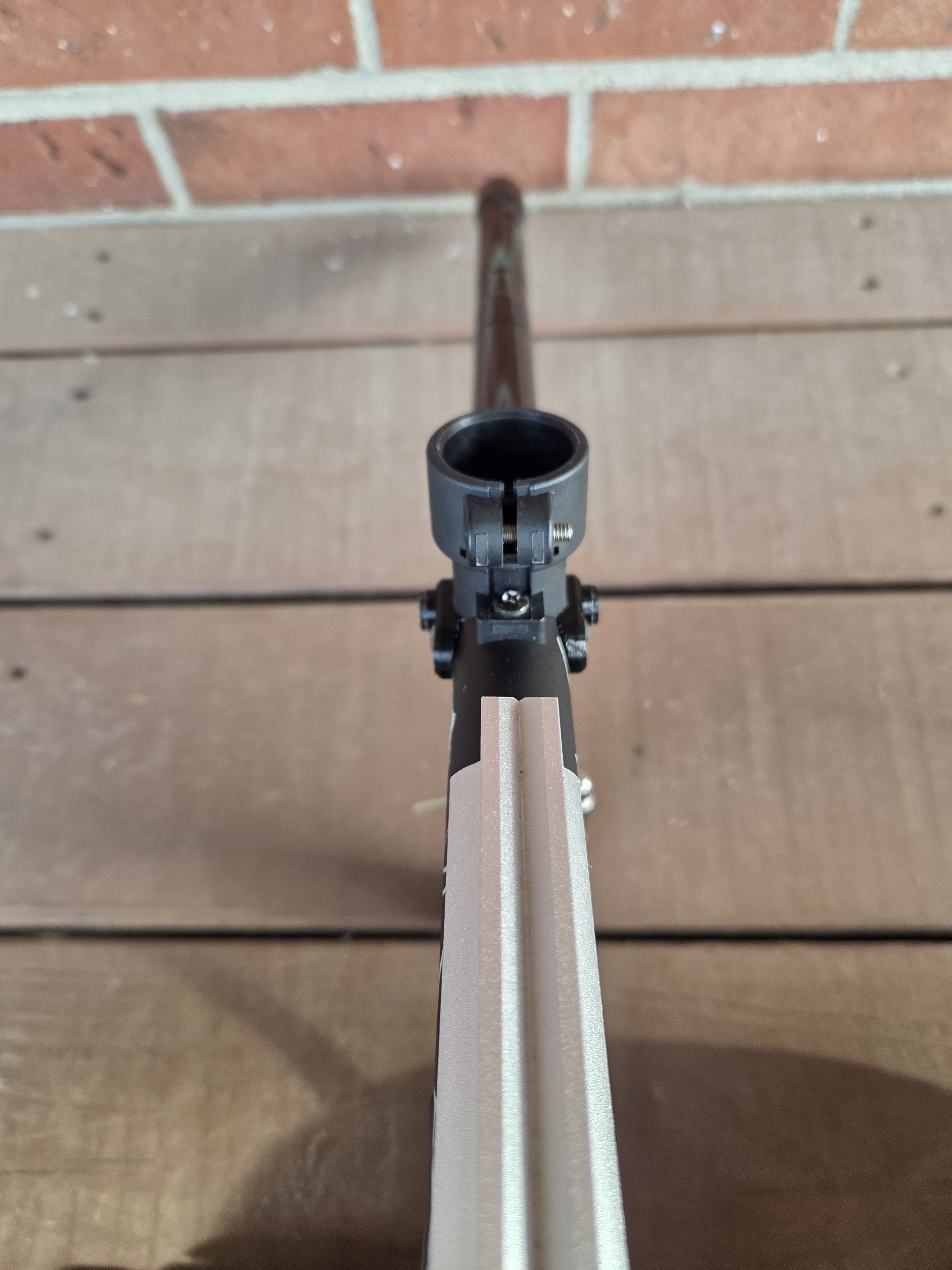

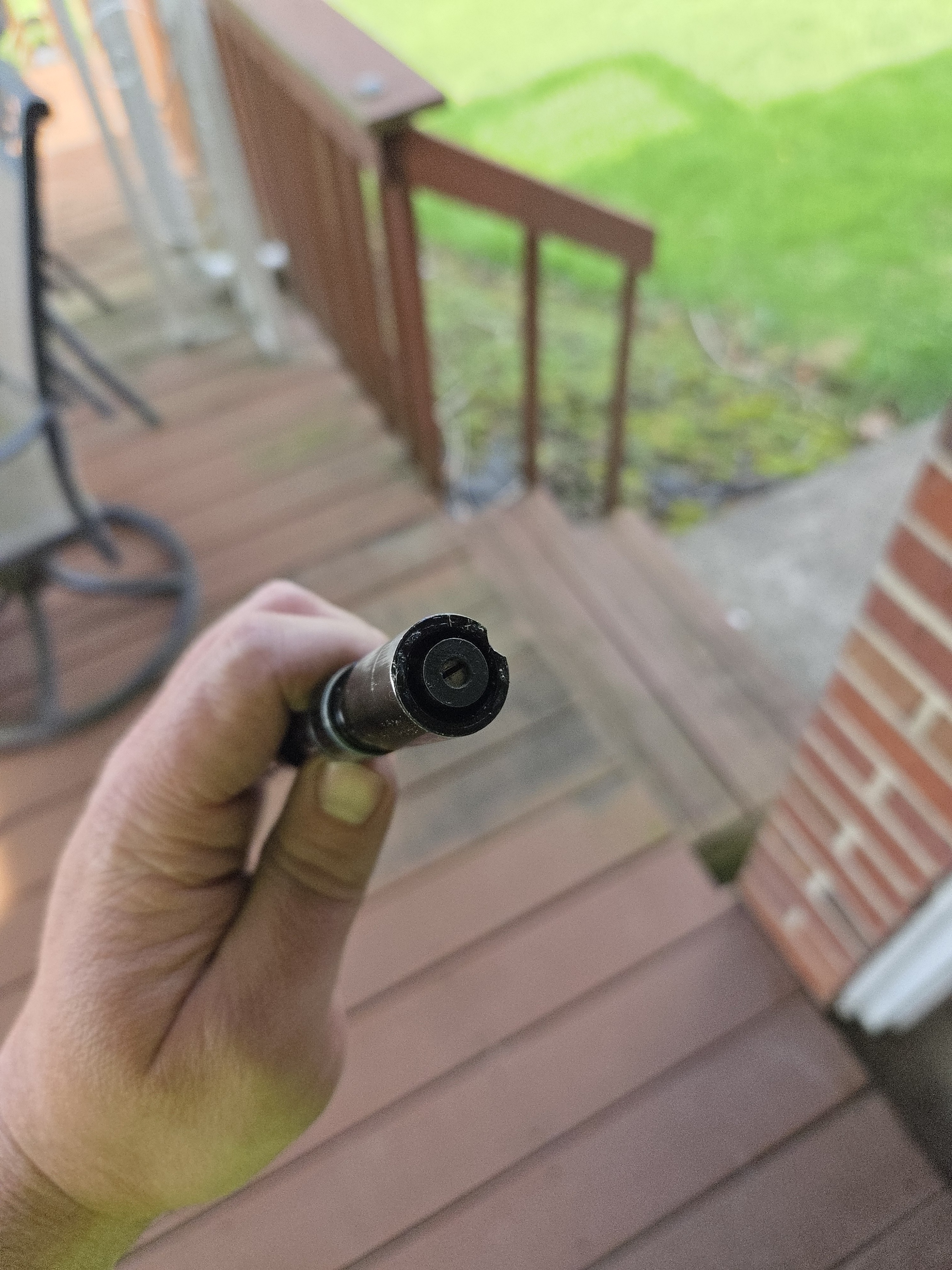

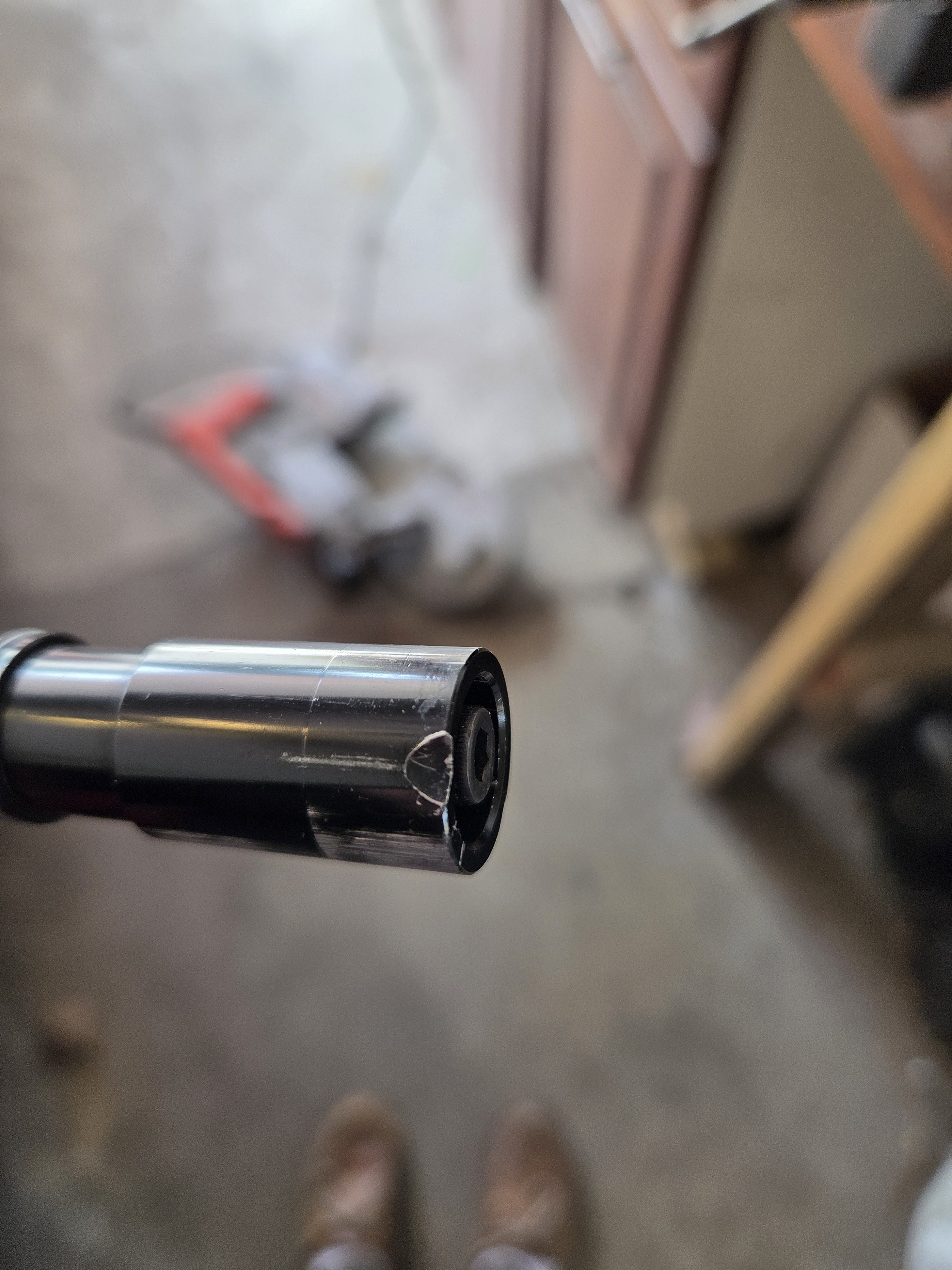

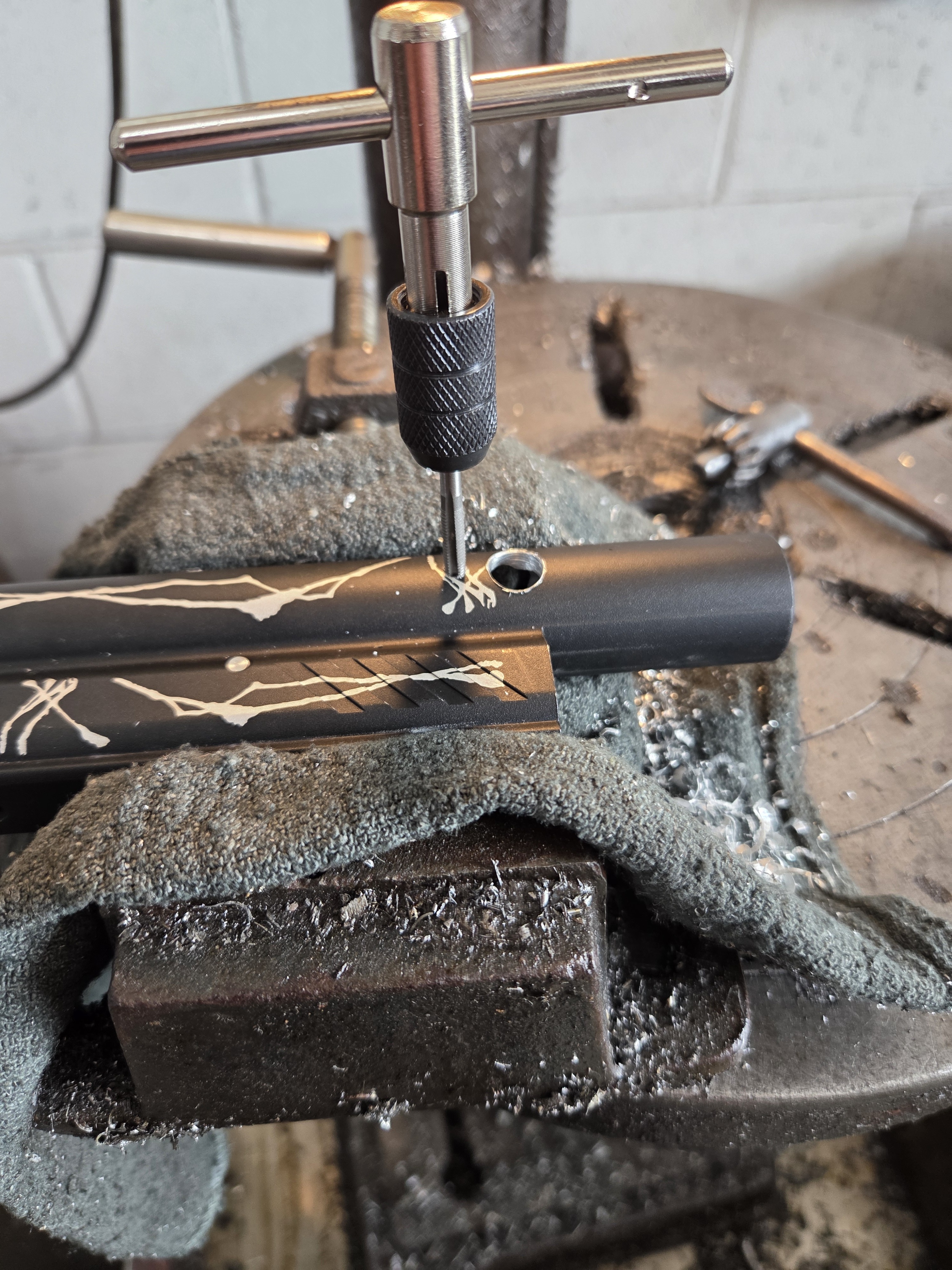

              4/21/25 Dual Detents
              This is an idea I've been thinking about for a long time. I've noticed that sometimes after a chop and I remove the barrel, there'll be a ball halfway fed past the detent. I believe this is the source of my chopping woes. So today I finally got up the courage to put the body under the knif-, um, drill press. Using the existing detent hole as a guide, I used a 25/64 bit to drill the hole for the detent. Then I flipped it over and used a #30 bit to make the hole for the screw. I tapped it for M4x0.7 and installed the second detent.
              20250421_160314.jpg 20250421_160933.jpg Top view
              20250421_184454.jpg Full view
              20250421_184406.jpg Borrowed the Stabilizer from my Trilogy for tuning purposes and threw on this mangled on/off and Shocktech 0 rail after getting a Kingman to Standard adapter. Also picked up a sweet Lapco Autospirit to replace the stock barrel.
              I ran about half a hopper through it in this configuration on full auto and had zero chops. Excellent. I'll need to tweak some more but this result is promising. I'll update once I settle on a final configuration but it's pretty dang close as it is.

                #26
                I think dual detents for older spyders are almost mandatory at this point. Today's balls are just too small. They make different durometer nubbins too but I haven't tried any of those yet. I've just been using the small black ones.
                Have you thought about enlarging the air passage holes in the front block?
                • RhoXi
                  RhoXi commented
                  I have but going off Otter's LP spyder guide my passages are already the right size and there's not much meat left to drill out. ANS has a Taso low pressure front block for cheap that I might give a whirl.

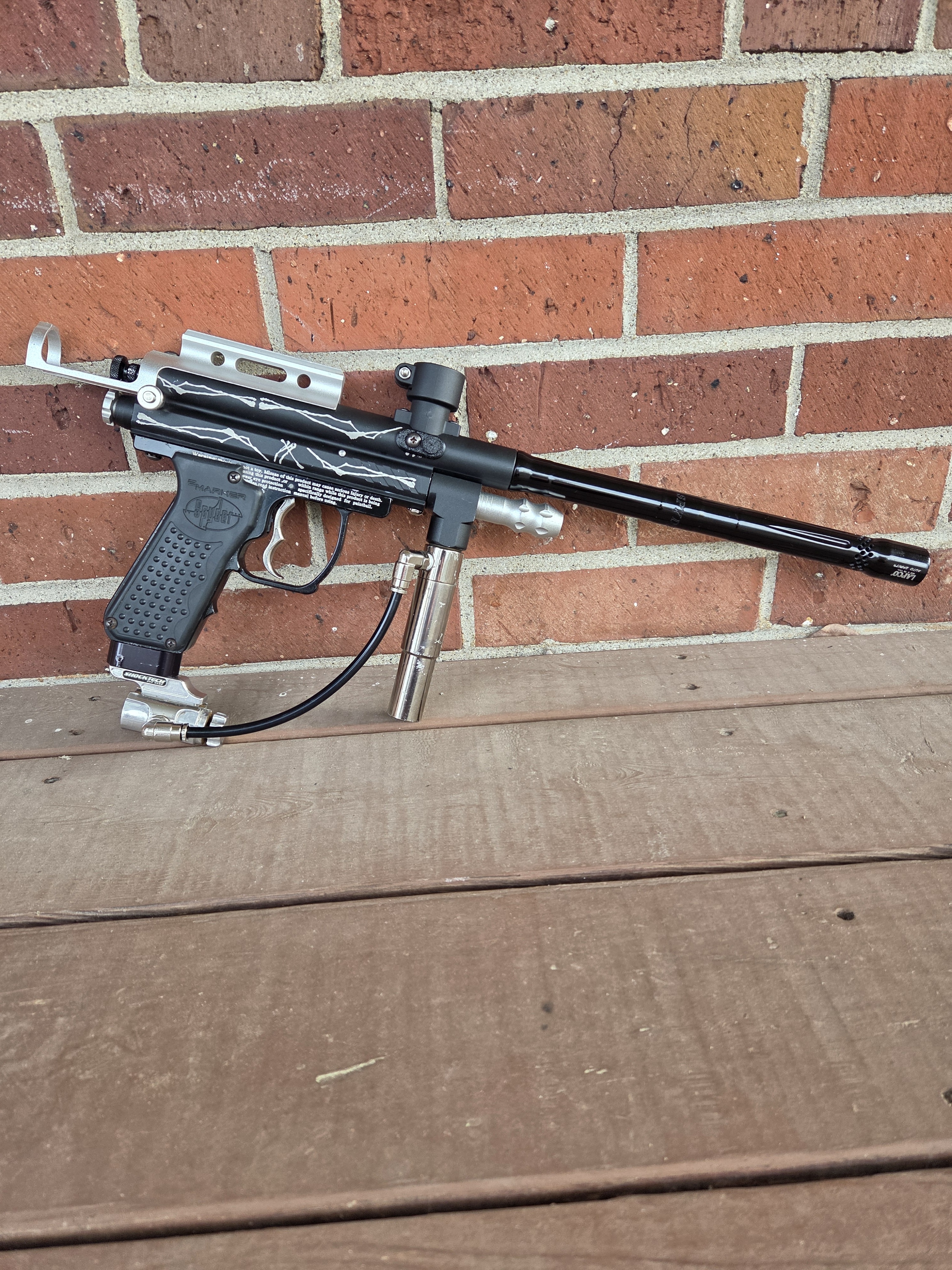

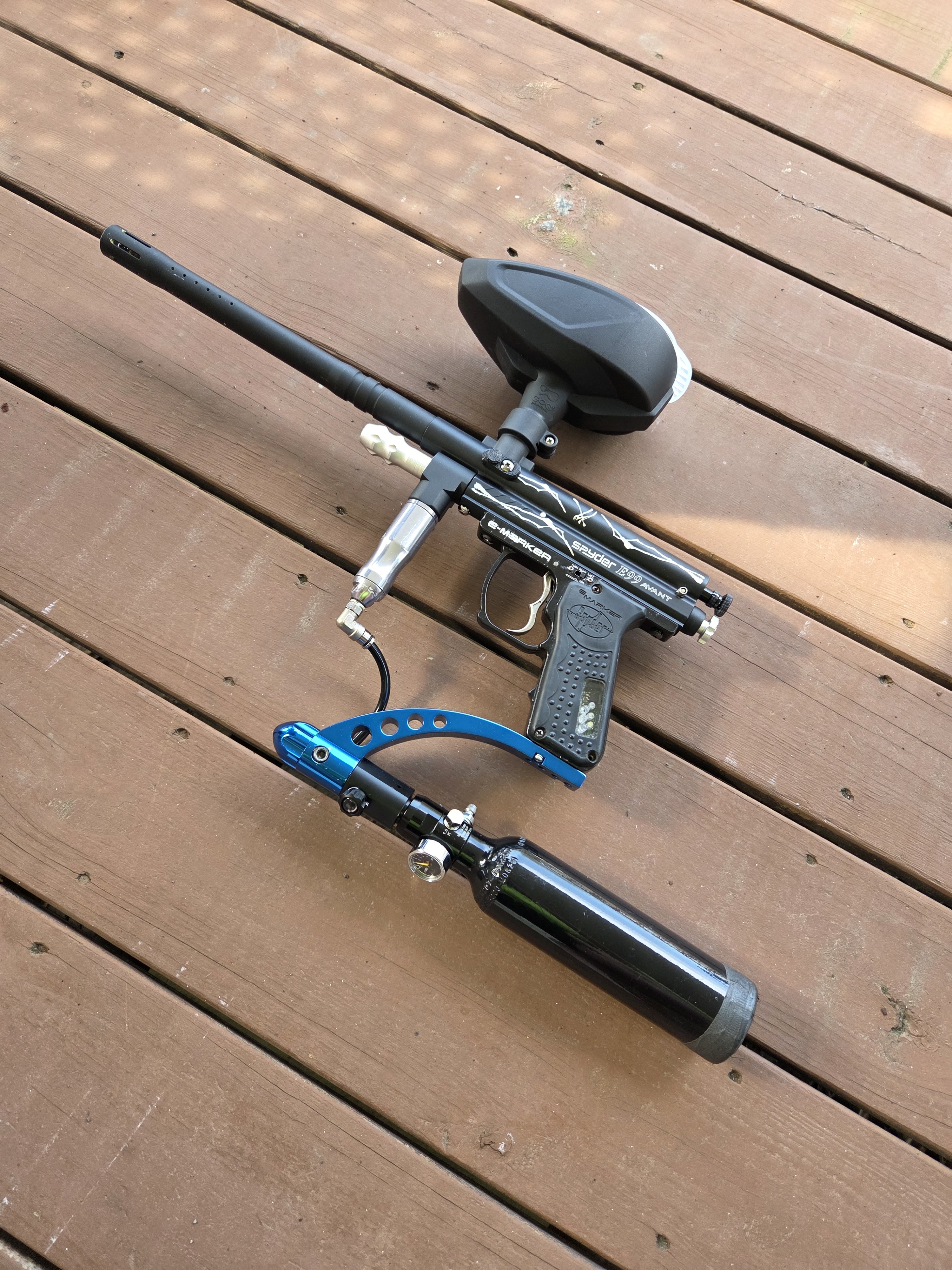

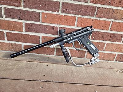

                #28
                *cough* Pretty dusty in here...
                I've finally come back around to this project. It got shelved while waiting for some parts then forgotten about. I finally got the last couple of parts this past week so here's how it sits:
                -Stock bolt, no venturi
                -Dual detents added
                -modified EKO valve
                -warrior springs; black valve spring, silver drive spring
                -Azodin feather striker
                -Taso "low pressure" front block
                -Air America Vigilante
                -Lapco Autospirit barrel
                Right now I am getting mid 290's fps with generic re-balls at ~500-525psi with the velocity adjuster all of the way out. It cylces fine on re-balls but will not re-cock while dry firing.
                Shot quality wise, it's very nice for a blowback but I'd like to go to the black (light) drive spring with the hopes of being able to pinch a paintball instead of chopping. Right now I'm looking into filling hole in the bottom of the body as I've heard that's what some people have done when persuing low pressure but I'm not sure if that'll let me use a lighter drive spring. Going that route will increase blowback pressure which might be counterproductive to my goals but would allow lower preasure. Or a full-weight striker might allow the light drive spring but it might compromise the shot quality. This requires more thought.
                The Vigilante is a nice companion for this build I think. It came to me with a bad reg seat and was a big part of what held the build up. I searched for a good long time for a replacement till I finally gave it a closer look. Turns out an Automag reg seat works perfectly.
                I'm hoping to pick up some paint in the next couple of weeks to tune this thing properly so I can hit the field with it this year.
