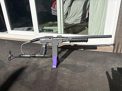

    Meet The Snipper Riffle, my slowburning project to make a lightweight, accurate dedicated FSR marker that will eat ammo at a rate I can afford.
    Someone on facebook wanted some data, so I figured I should post it here for other builders to see.
    Current setup is:
    Deadlywinds X8 with 687 insert
    WGP Basic reg @~600psi
    ICD Leverchanger stock
    Stock springs, extra detent removed
    APP Clear grips from that blowout sale lol
    FSR is pretty old
    From my virtue clock- 26 shots, for some reason in reverse (last shot listed first, first shots at the end) like 65 degrees and overcast, terrible 12ie weather. Also I tried to use up all my fsr with fin damage, no idea how much that hurts.
    225,246,264,271,282,278,281,278,281,281,280,281,27 8,273,269,281,273,276,284,276,276,270,277*,253,259 ,270
    I gave it a small velocity bump at the *
    Even in bad conditions that’s 3 7 round mags and couple slower shots. Not great efficiency but I’m really happy with the consistency and weight

    my hammer7 has been shelved for the time being, but ive made peace with mine being "roundball" only (modified nelson internals, ~8 cf20 mags at 280s on a 15/4500)
    the modified bolt doesnt like fsr, but the consistency and better efficiency is worth it to me. running down the magfed guys that dont know about autotrigger is fun with these

      Jim did you try takeing the stock hammer and filling the bottom with JB weld. I had good results with FS on my DamHammer. I ran stock springs and just fed it 1k psi from an air rifle reg. Shot FS like a boss!
