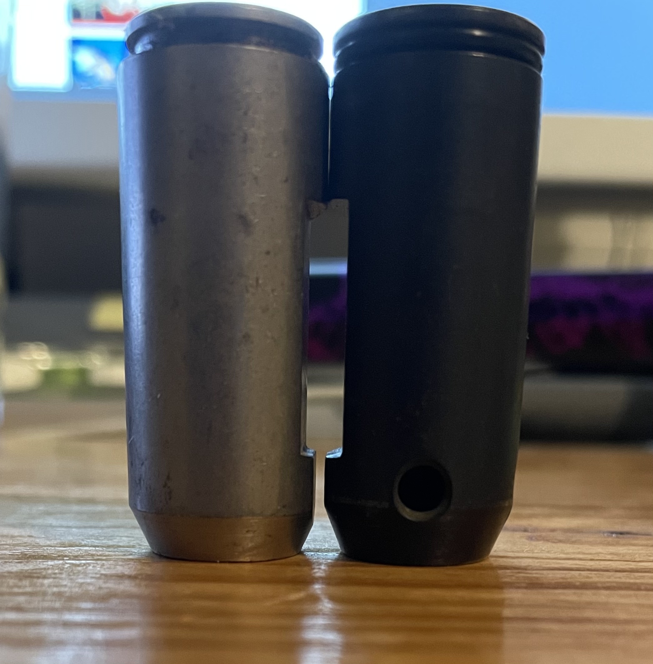

    I dug out all 4 slim strikers and 2 fatty strikers I have in my possession and they are all different. I’ll get pics in here soon but the 2 fatty strikers are off by a pretty wide margin. Seems like getting the right striker in your particular spyder could go a long way to achieving a magical trigger pull.
    pic of the fatties.
