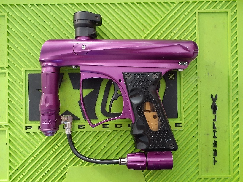

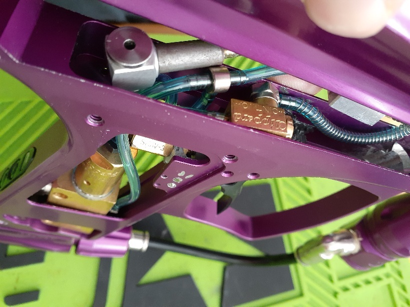

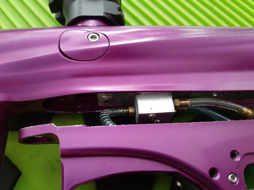

            Teaser shot of a mech Clone I'm working on for Alexndl...
            Sent from my SM-G960W using Tapatalk
            • Meleager7
              Meleager7 commented
              very cool, how does it work?
              Jordan commented
              It's a balanced spool with a dump chamber that gets isolated during the firing sequence, so I really just needed a 4way to operate it... I used a SMAV3 3way to operate an actuator that moves a 4way valve, which controls the bolt movement. It was tight in there but I managed to squeeze a couple of QEVs in there as well.
              The trigger is really light because of where I placed the SMAV, and it cycles nice and quick with almost no kick... I think it's going to be a great shooter.
            • spikeball
              spikeball commented
              I would love to see this thing shooting once it's done!
              Please let me know how it works out! My VX is just sitting here...
              Bunker
                I. Am. Canadian. 🇨🇦
                • 3520
                Bunker
                My limited testing indicates it should work well... it's en route back to it's owner so hopefully there will be an update.
                  Awesome! I'd love to get rid of this 170R and go all macdev!

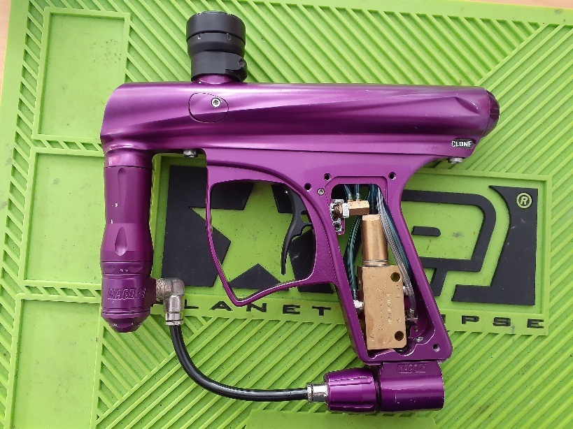

                            Here is my "MechDev" Clone
                            Mech work done by Jordan using a manifold made by Kit. There is some QEV crammed in there too.
                            This is my go to semi if I am playing against too many electro. Its almost walkable and very soft on paint. Did not chop any ball yet, even with a gravity feed hopper.

                              That's really special. Can you explain how it works? Is that piston attached to a bigger 3way valve?
                              Alexndl commented
                              All the detail can be fourn here.
                              https://www.mcarterbrown.com/forum/p...ech-conversion
                              Its a piston (clippard MPA3) activating a 4 way valve (clippard SMAV4)
