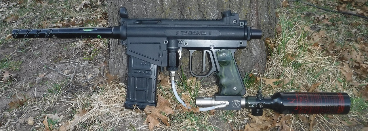

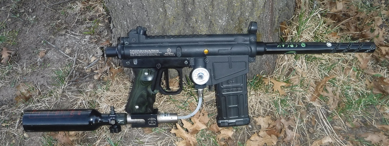

                      Here's my last A5 build...
                      So A lot of this is part of my own personal A5 build theory, a low bolt force, which is a lot like a low pressure build but concentrating on getting the main spring tension down as low as possible instead of trying to get the pressure down below some arbitrary number. So don't worry about the reg, rear velocity adjuster, extra valve volume, gold powertube, etc. That's me doing my usual overkill.
                      Also the rare .45 grip for the A5, I just couldn't help myself.
                      Anywho, lets talk just the magfed stuff. This body is the bit older version. It came with the mag well that took the older roundhead magazines, so called because the part that balls came out was, well, round. Which meant no First Strikes. So I had to order the updated Dmag mag well. These magazines are honestly not as nice, and you got to give them a bit of a smack to make sure they're fully seated, but they're simpler, much cheaper, heck they're available in bulk sets (I bought a box of 10 of them), and can work with First Strikes. In theory, haven't gotten to test that yet. The mag well was "almost" a simple drop in. Had to do a little dremeling to get everything to fit just right. I went with 14 round mags on this, which are 7+7. You have to flip them around half way through. Which works for me, my goal wasn't to get as close to a hopper fed in use, but more like a semi-auto stock class. You got to play with it like a SC Phantom or Sheridan, really make every shot count, but you can squeeze into positions where you might not be able to work a pump.
                      So all the stock parts (what few I used) dropped right in. The grip frame, being an aftermarket part, had some fit issues. The stock A5 grip is a little bit loose out of the box, so I think the body was made a little thicker there to tighten it up. Well the aftermarket frame was made a little bit tighter for the same reason. So the two together was REALLY tight. Had to dremel off all the paint under where the grip frame attaches.
                      Now the body I used was made before they developed the loc-bolt, which is an extra backwards facing detent that locks the bolt open when there is no ball present. Nifty, nice to have, I'm not worried about it. My other regular mag fed choice (T8) doesn't have it, I just count my shots, or at the worst listen for the extra loud shot to tell me to reload.

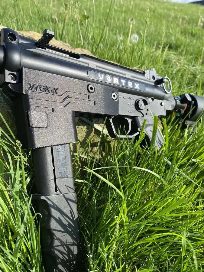

                              so if youre inyerested, i have this 3d printed conversion that bolts on where the cyclone feed would typically go. pretty straight forward. i can send me some pictures later today. id also have to find which mags worked with it. PM me if interested. ill let it go cheap as ill never cross over to the dark side lol
