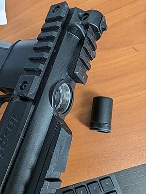

    Inspire BFG feedneck threading
    For the life of me i just can't seem to figure out what size/style threading for this feedneck. I know it's not ION or 2k2 timmy. I've heard guesses that DP g3 feednecks fit it, but i'm not sure. anyone know?

    are you trying to find a feedneck for that? i bet you could slip an empire spec feedneck over the top. Do you know the outside diameter?

      Inspire got a licence to manufacture the DP G3 under the name "Inspire Nano" before they came up with the design of the BFG, so it might very well be the case. In fact, the owner of Inspire was an absolute cheapskate, and cut a lot of corners with several of the Inspire products wherever he didn't understand that it would make a difference with the end result.
      Anyway, I know the designer who worked for Inspire at the time, so I'll ask him and get back to you.

        Yep - Dangerous Power G3 confirmed.
          was it linus kallstrom? he's in this spyder group on fb, i asked him about it and he never got back to me lol.
          thanks for the help!
