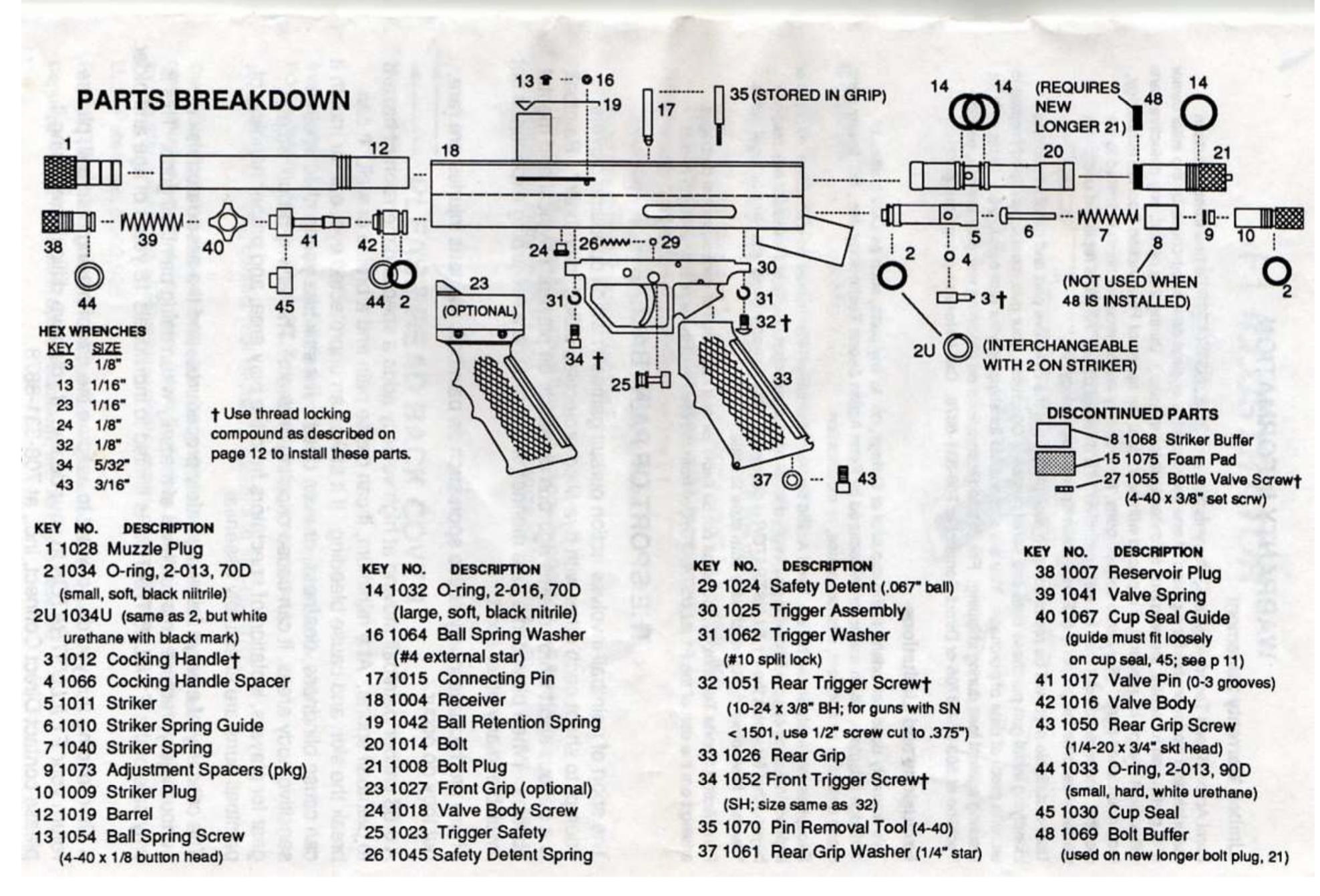

    Just wondering if anyone could help me with the size/duro/material of the orings for an Illustrator (I have an F4 but I'd assume all generations are identical).

    Here is a pic from an F1 manual. The F4 manual doesn’t say the actual sizes or material of the orings. These are pretty much the same as a Raptor. I just use either 70d or 90d buna orings. Using the 90d ones on the striker and the valve usually.
      This is what I've used to get ORings to keep my F4 (ACI) running.

        Use the white urethane 2U 1034U o-ring on the striker. I hated how often the black nitrile nicked.
