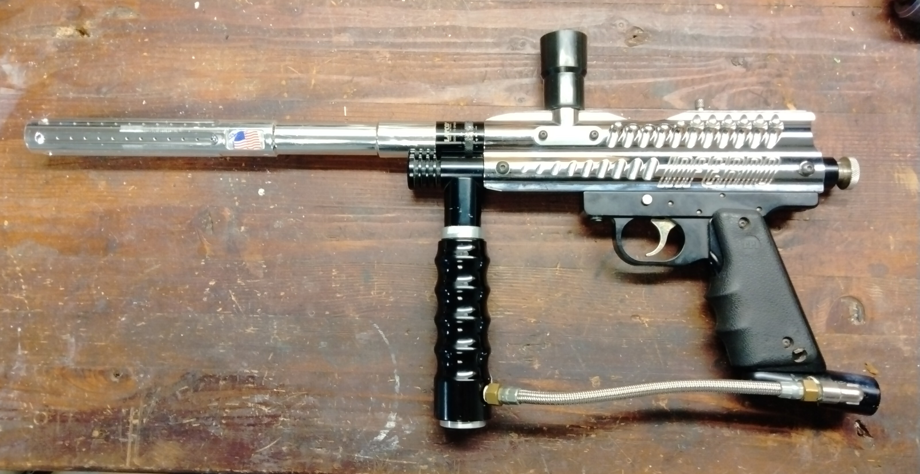

    I went along to the thrift store with my wife last week. Behind a glass display they had this for $15. My wife's first question was, "Do you actually need that."
    "Yes I need all paintball guns."
    I've never had one of these before and understand why people say they are a step above Spyder for a STBB marker. After a quick rebuild it's shooting and holding air. It could use a trigger shoe before taking it out on the next day I play.

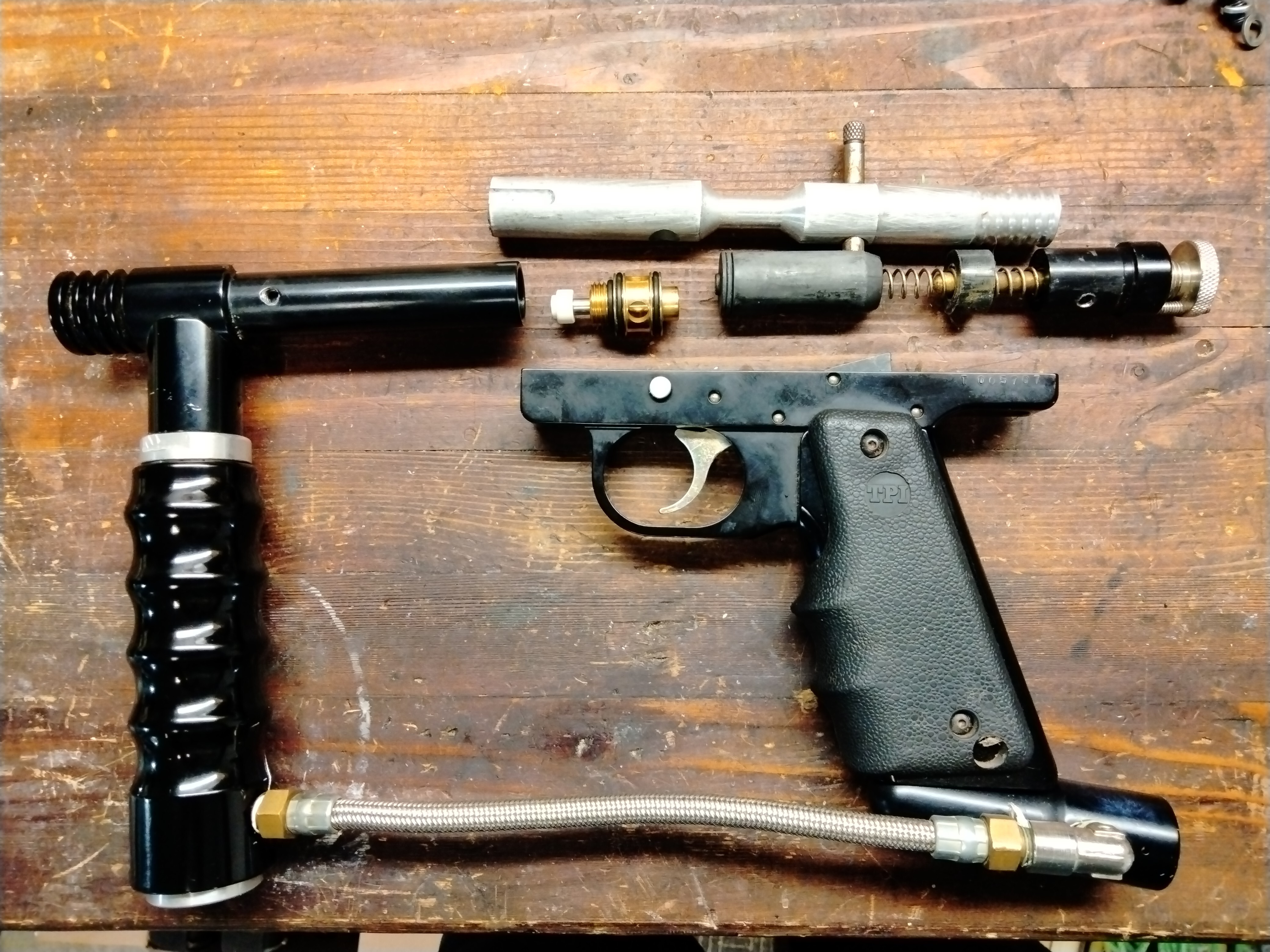

        Arrow Precision Inferno. I'll try taking an exploded view later. These were common field markers in the UK and I think this one is from around 2000.

            It's got a Lapco cocker to spyder adapter and Eagle Works (Rainmaker) barrel. They just put a flag sticker where the old jewel used to be.

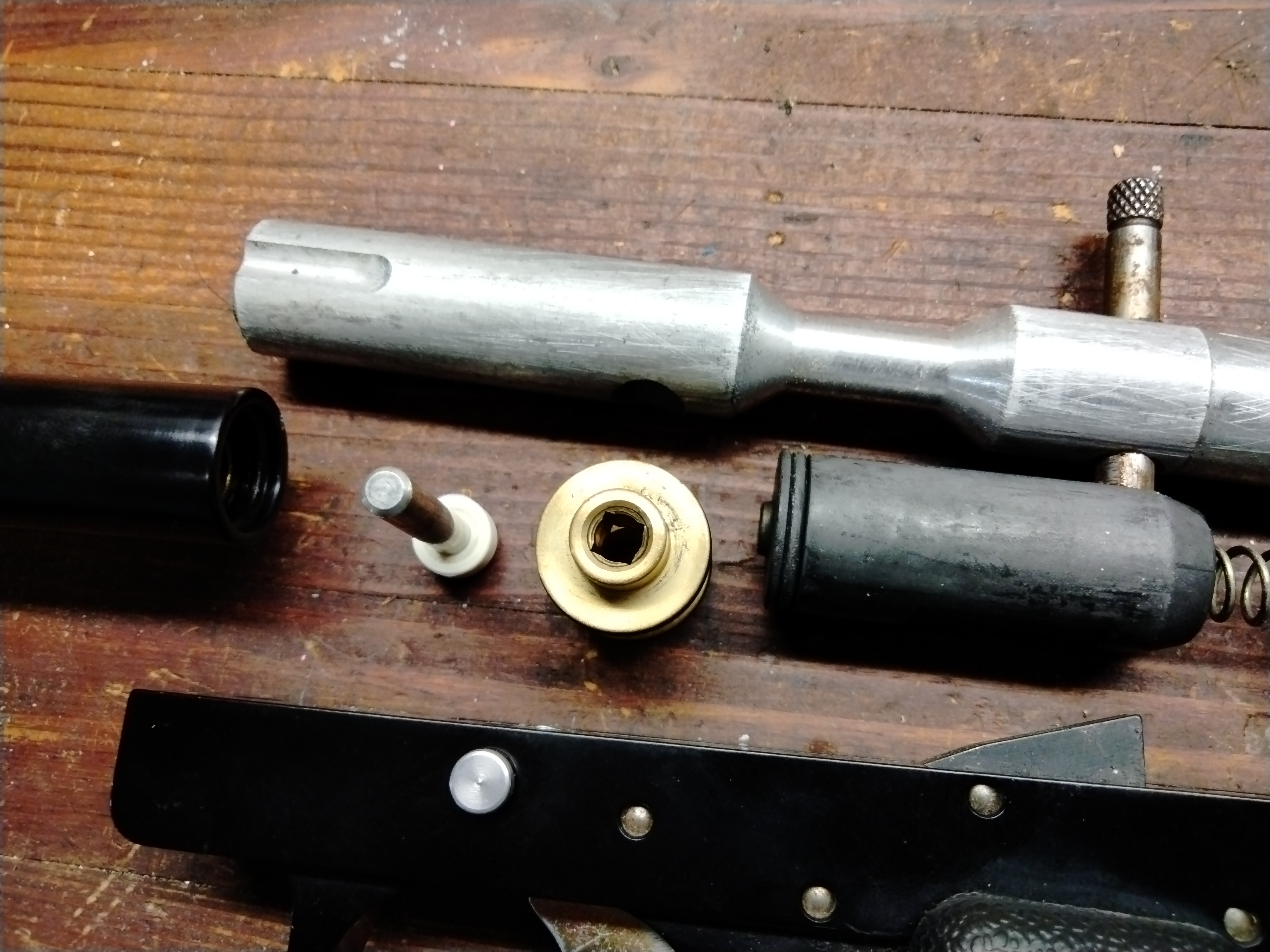

              The valve screws into the front air chamber and ASA. The valve body has little broaches which let gas by for recocking. The body looks like it was an extrusion but the gripframe appears to be CNCd and not cast.
