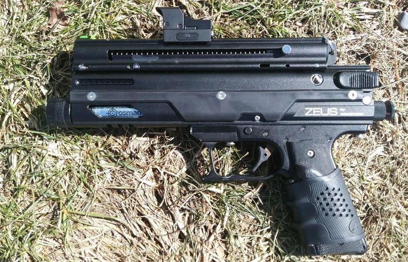

    Armotech Zeus ISO VALVE SPRING
    Got my missing co2 cap figured out, now I find out that my valve spring ("cup seal spring, #44 in owners manual) is about 6mm too short. Anyone have a parts kit with a spring I can snag? Or know what equivalent I could use? It's about 30mm now, and as above is about 6mm too short. I have checked the parts diagram, I am not missing any parts.

    Update: found a spyder spring, the medium pressure one i think, cut to 56mm will seal the valve in the Zeus. Not ideal, as the spring area is only 36mm long. Testing the next time I go play will tell me if the spring will hold up or if it's going to shrink like the others. hopefully even if it does shrink, its still has enough power to hold the valve shut.
    I have no idea on velocity yet... one step at a time!
      Side question, did armotech just not make enough markers to have their own section, or...?
      A Tippmann m98 or A5 main spring and guide will fit these,you just have to cut the spring down. I've been doing heavy experimenting on these guns lately and those definitely work. also if you get an Autococker spring kit or a Nelson spring kit that has the longer valve springs ,they will work in a Zeus.....I have one in mine now and it works well.

        I played with the spyder springs for a little bit, and i got one to work, but by the time i went out to play with it, it was no longer strong enough. ill look into trying a tippmann spring, thanks.
