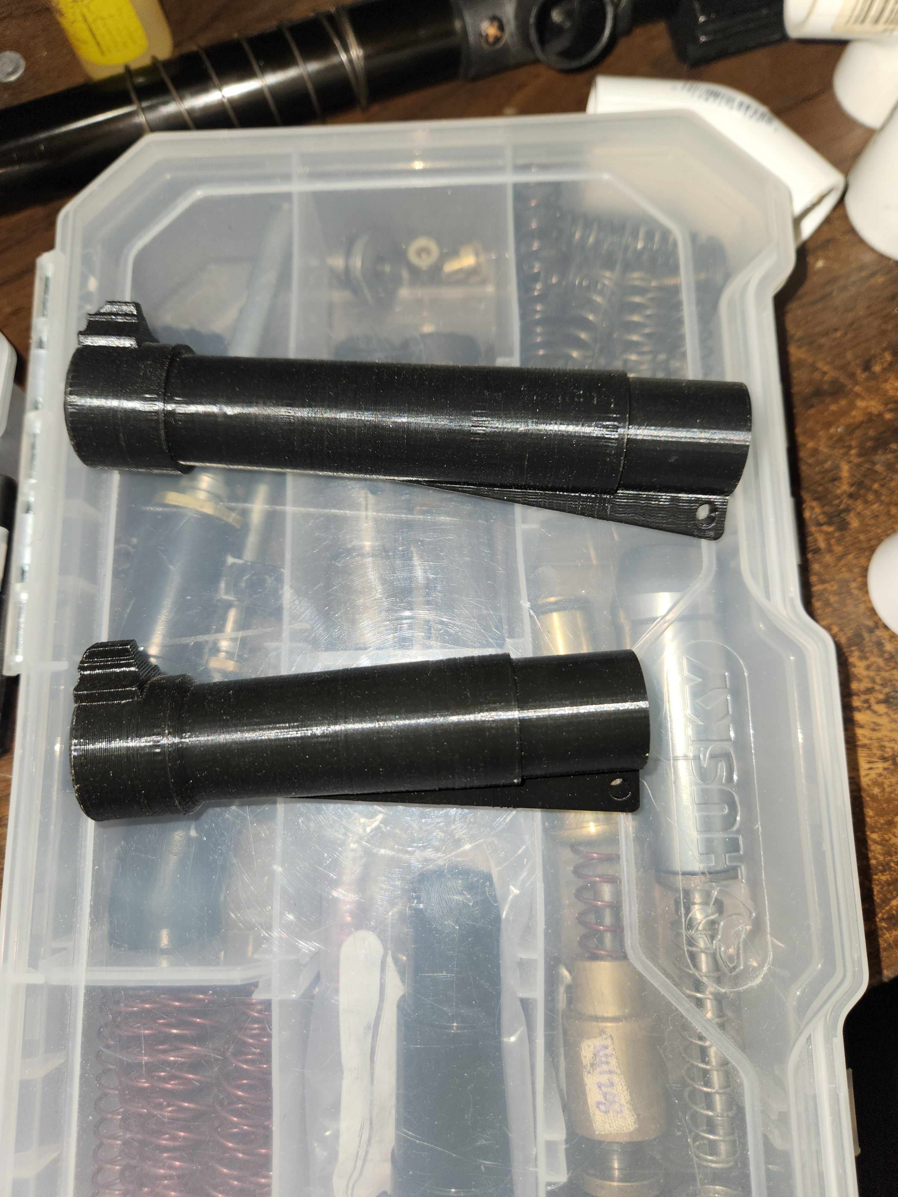

            One of our fellow MCB'ers was 3d printing some of the parts for Splatmasters and Rapides. That person should chime in, and sorry I've forgotten your name. For the Rapides, he made loaders, loader plates and 2 length Rapide barrels that take freak inserts.

                I would love to get the stl files for those barrels.
