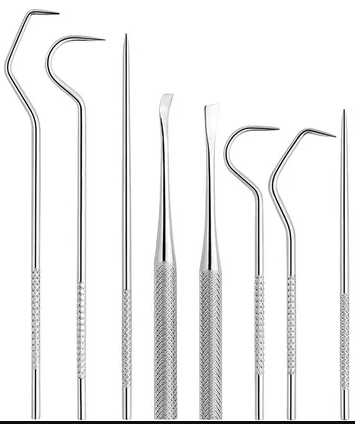

      COB Have you tried using 1 or 2 dental picks, to slide past the treaded portion, to help avoid the chance of flawing the o-ring upon installation? Is that the issue with nicks/chips/etc?

        No, I have not. I'm not sure you have enough space as the O-rings in question are very small to begin with. However, I will try your suggestion, since my way has not worked. I'll update on the outcome.
