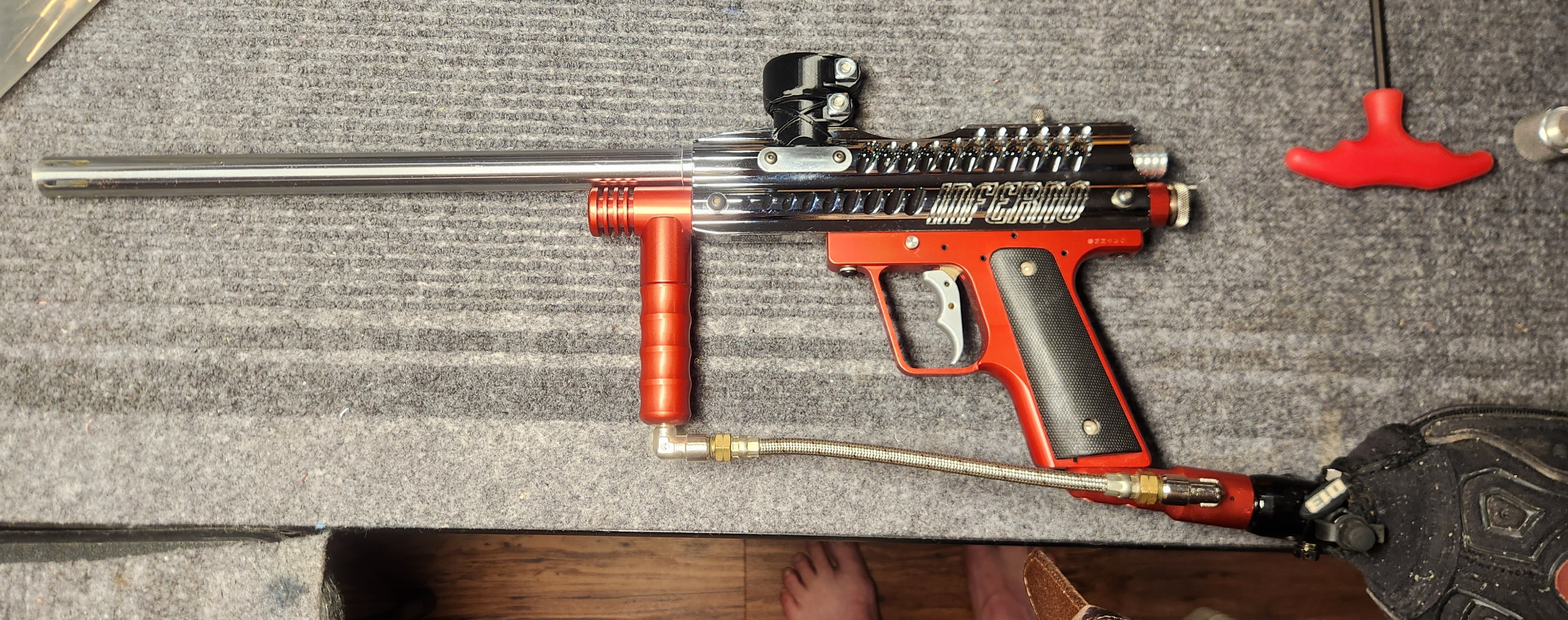

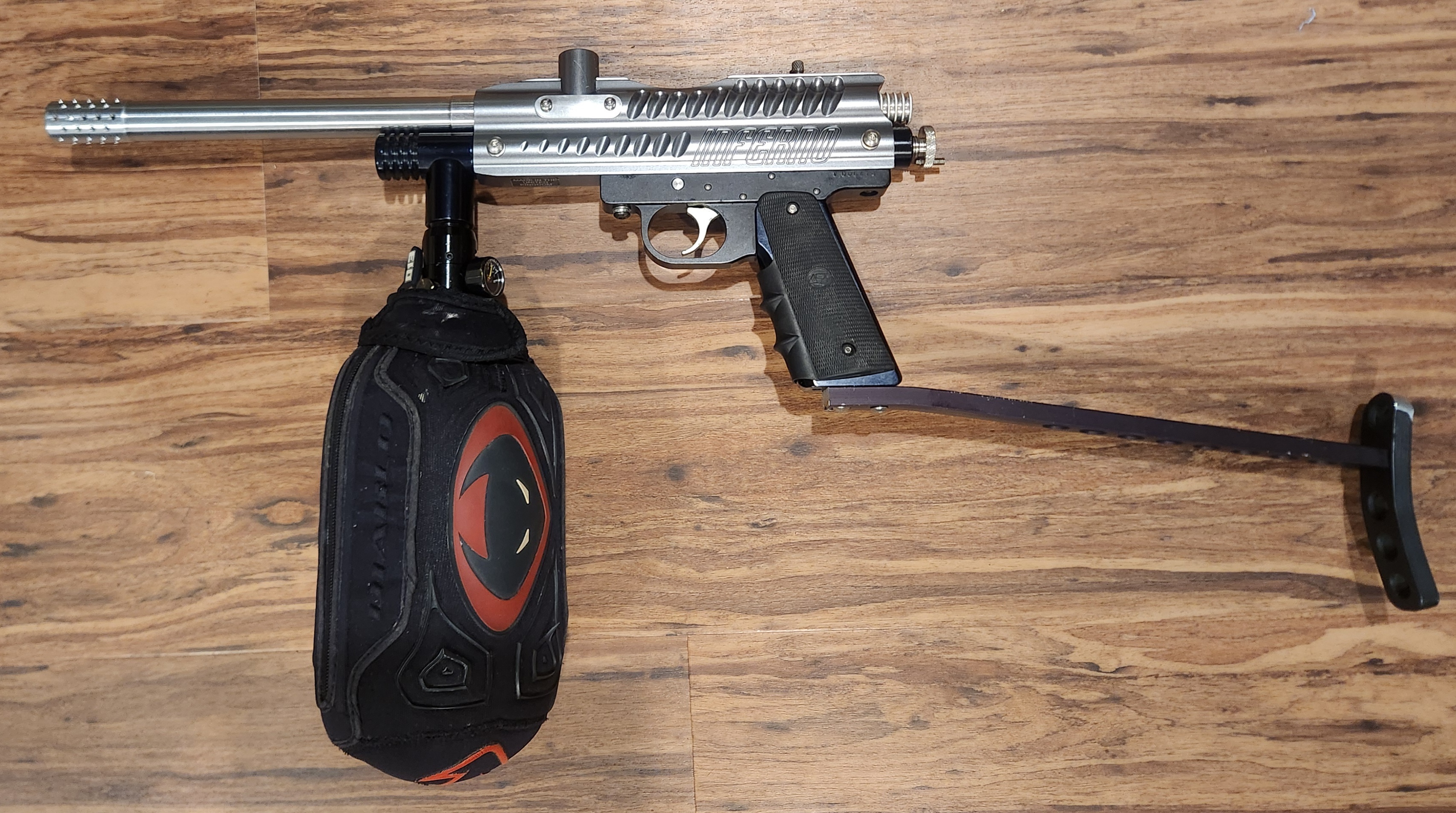

    I owned a Sterling and loved it. When I found out about these Infernos from them, I wanted one. Got this on a Goodwill auction for $32.00 delivered. Disassembly was a rubber mallet and dowel rod job due to all the broken paint from many years ago. All the rubber had turned to sticky goo. Underneath all that was a damn well made marker! I put all new orings in, and used a couple 1/8" thick orings to replace the bumper. She sealed up immediately and cycles with authority. I used one of the spyder detents that Doc sells for his Mag adapter. It doesnt fit the round cutout for the base, but the cover smushes it right into place and it works just fine. This will be great for days where I am playing with all rental players.

    Looks like a Check-It barrel on it.
    • Calvin
      Calvin commented
      It is. Truth be told, I found that at the local shop last weekend. I knew this was coming, and I have a thing for stainless tubes. At the price he was selling it for, it was a no brainer. Short n' handy.
    • 4213
    Has the T stock been altered so that it is more of an L stock? Looks it.
    • Calvin
      Calvin commented
      Yes. I like to cut off about half of the top of the T. Keeps it from hooking on your armpit when raising the gun. Still gives plenty of stability. The really nice Lapco T stocks did this, but they are very hard to find now. Sadly, I only have one. Always on the lookout for more.

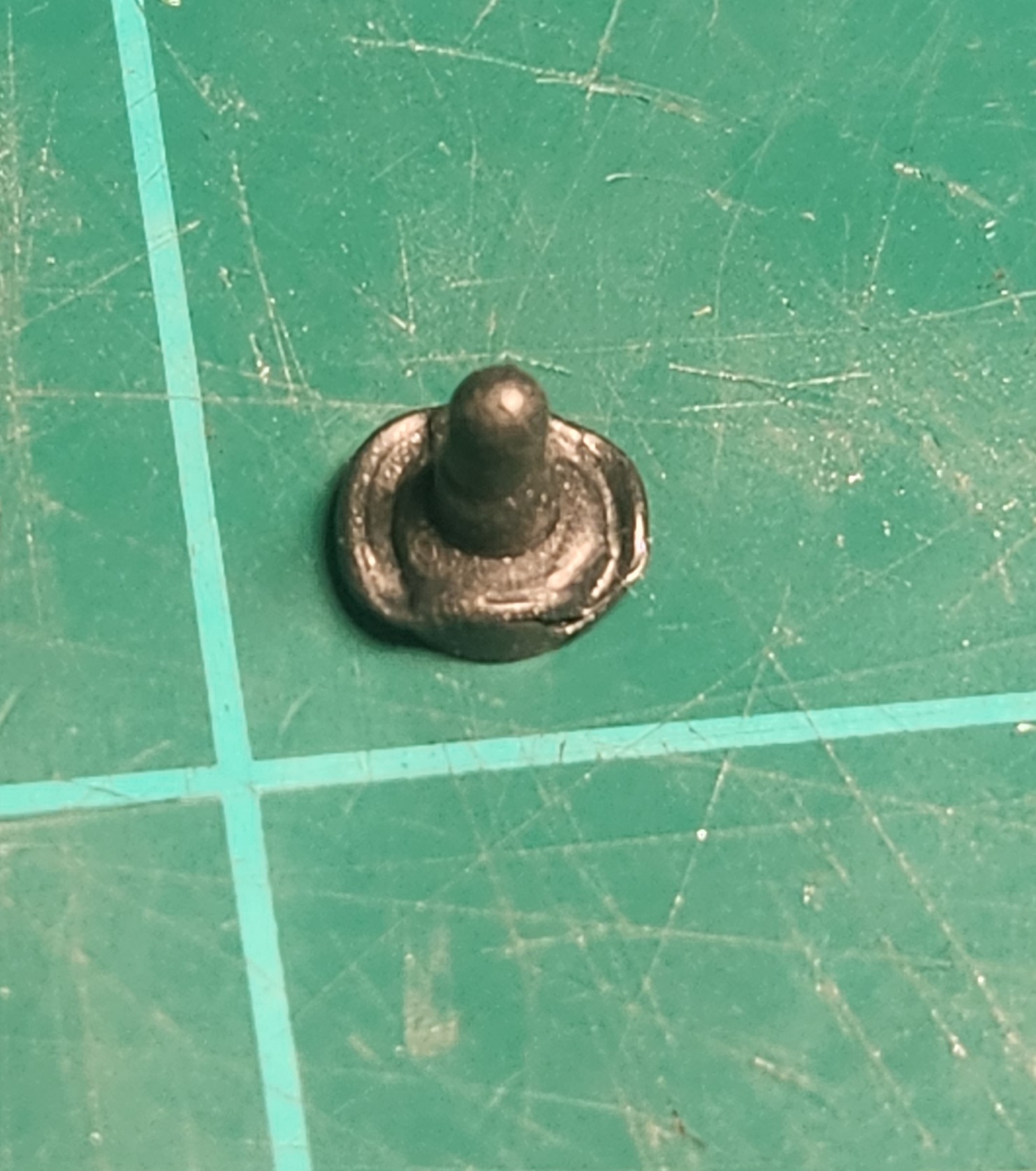

          Doc's Spyder detents are very soft and high quality. A harder version might not be smushed in the same way. I think careful xacto use could make any Spyder detent fit in perfectly, as the smaller base is the only difference.

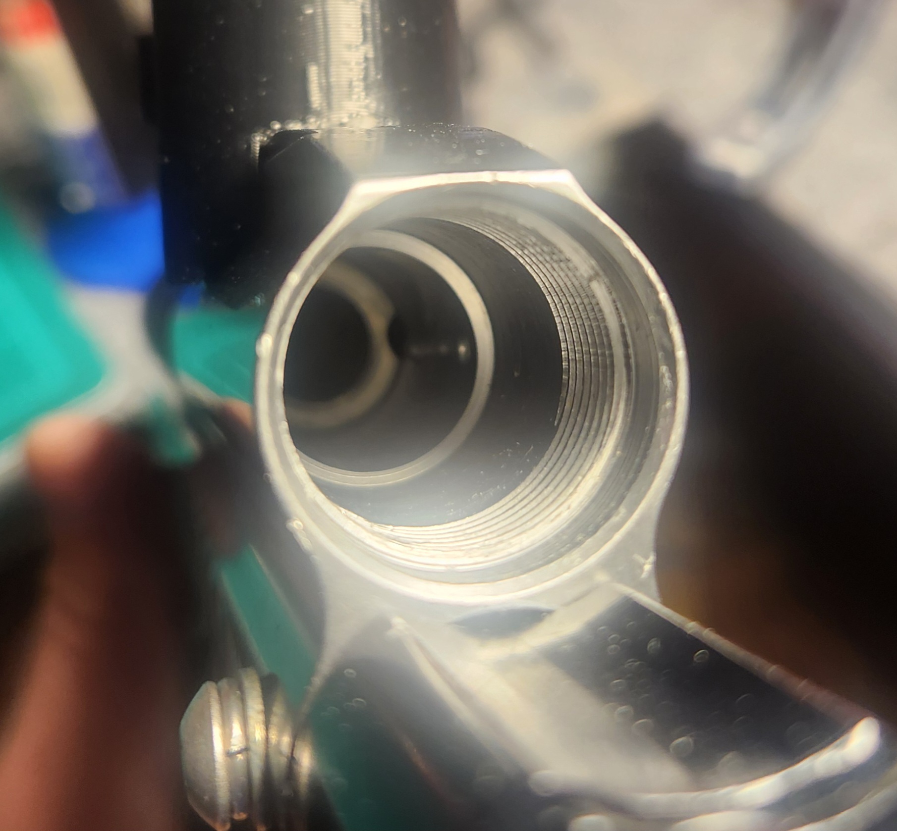

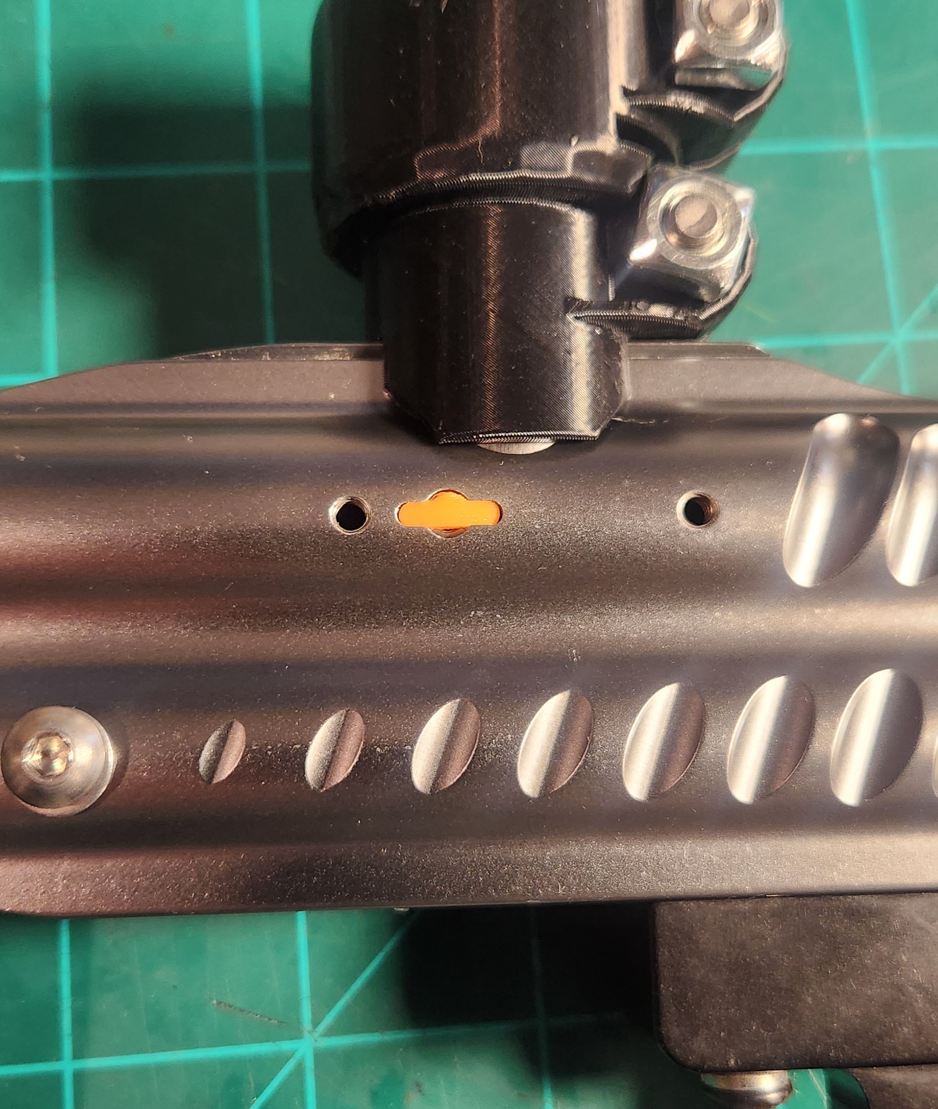

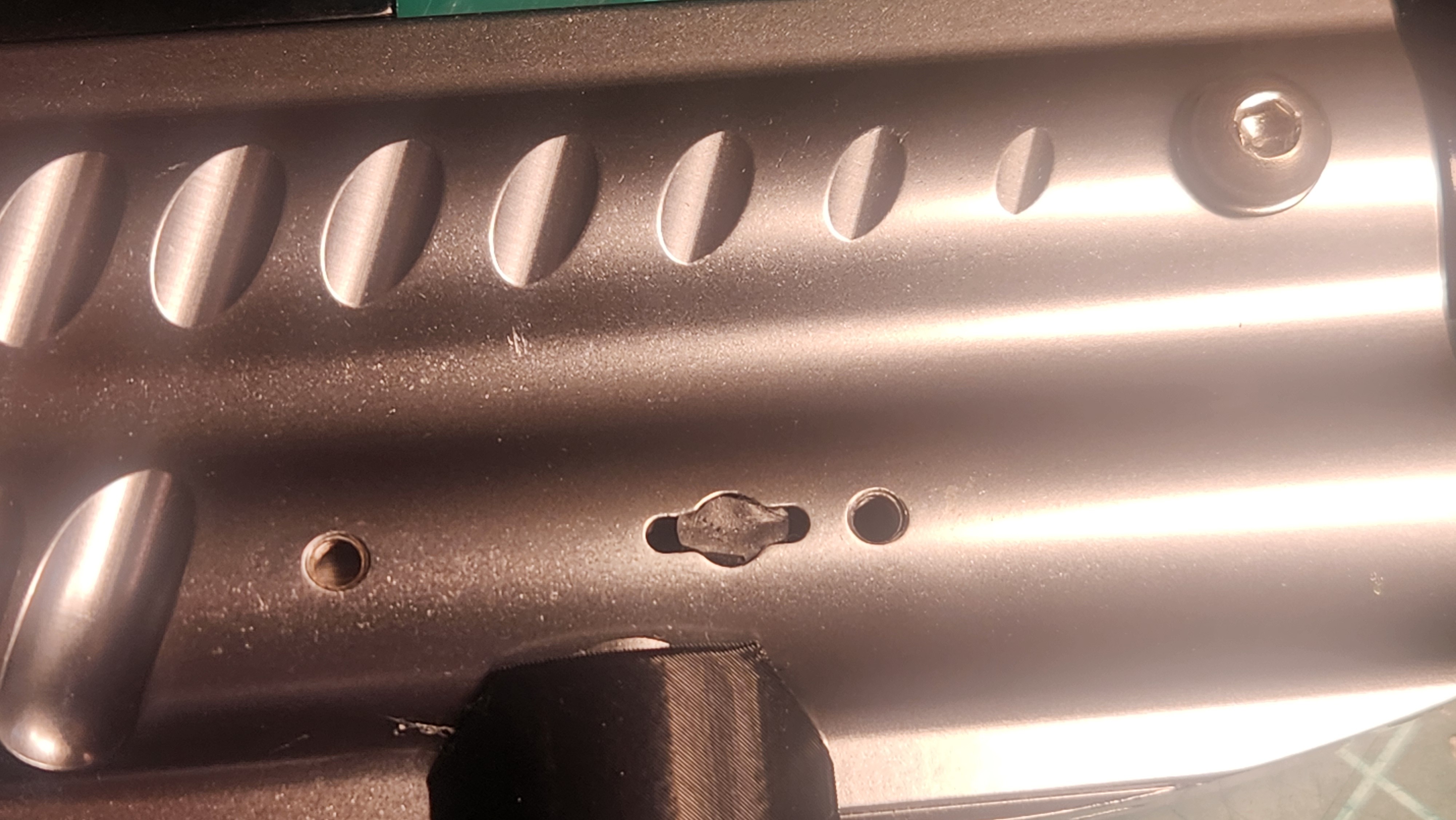

        I pulled the cover off and, sure enough, the pattern of the detent hole had been pressed into the detent.
        20 seconds with an Xacto, and it fits perfectly into the body.

        This does give a bit more extension of the detent finger into the chamber, so it's worth doing.

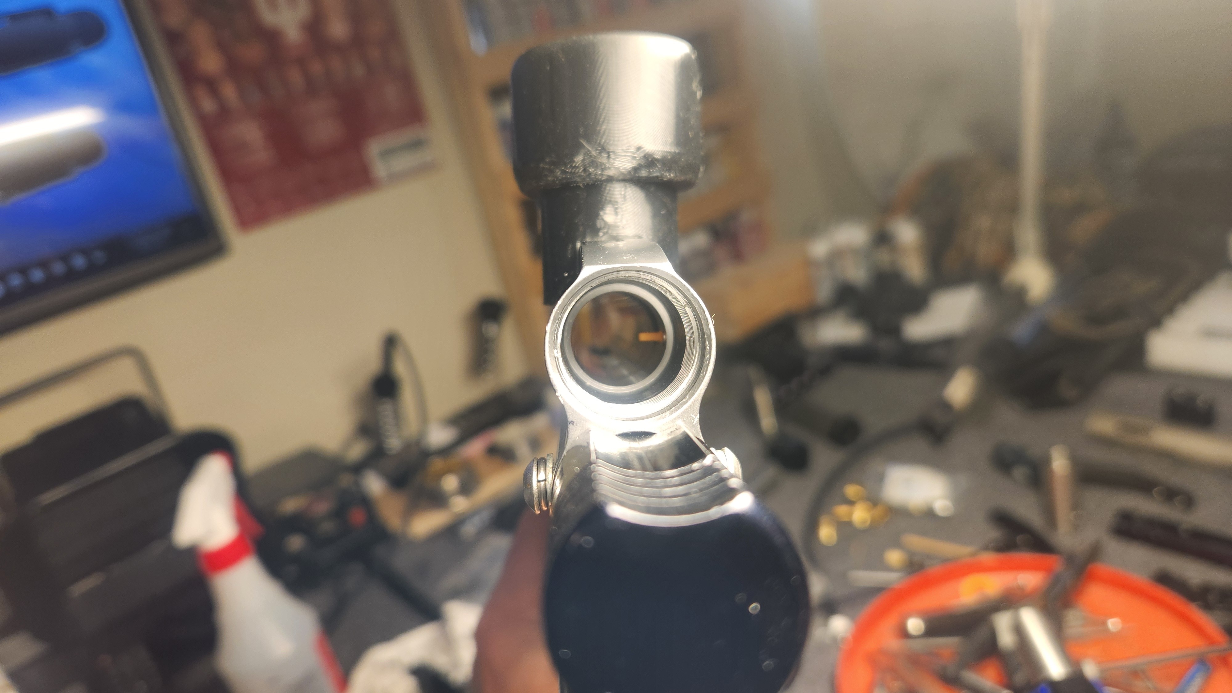

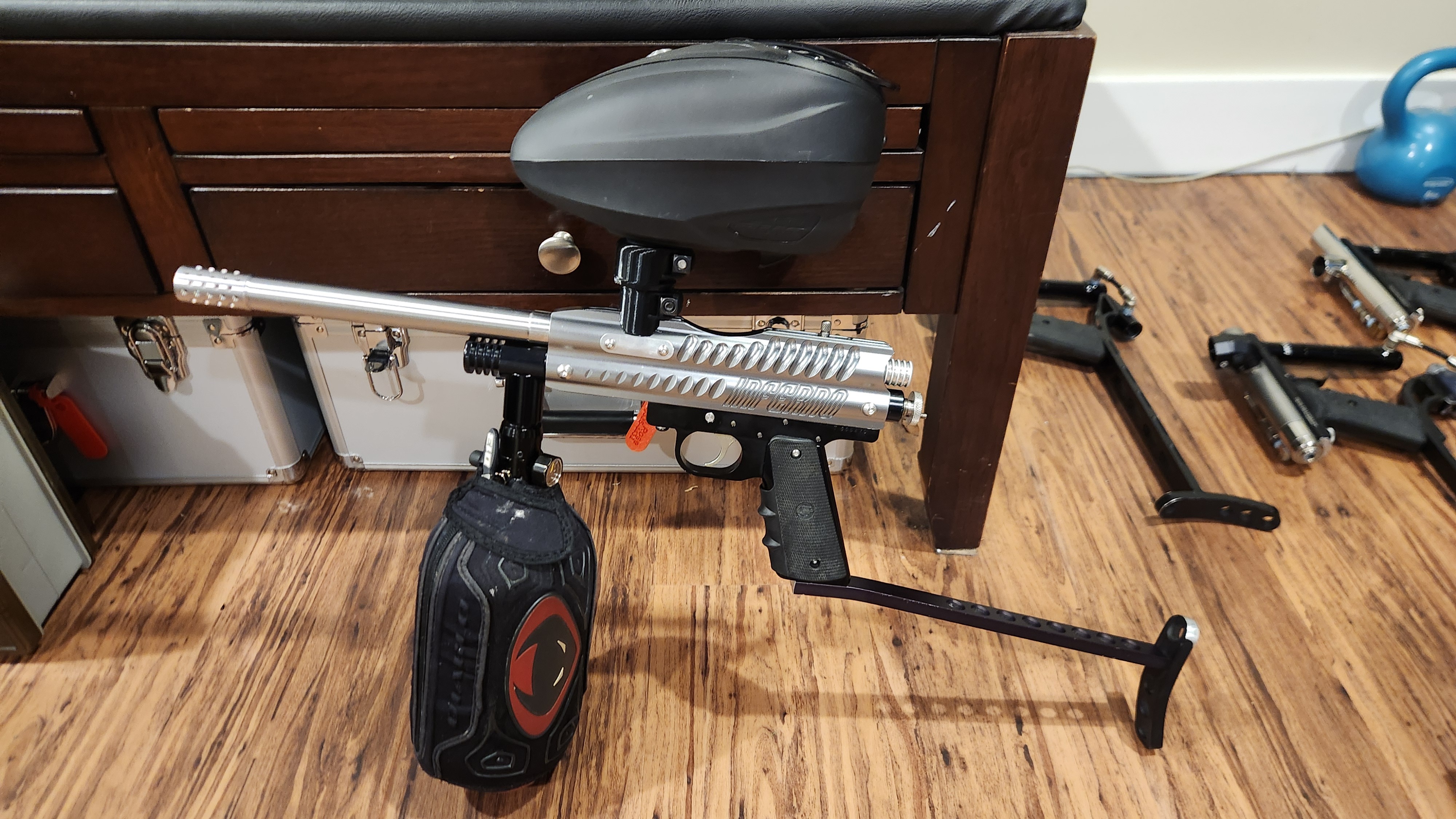

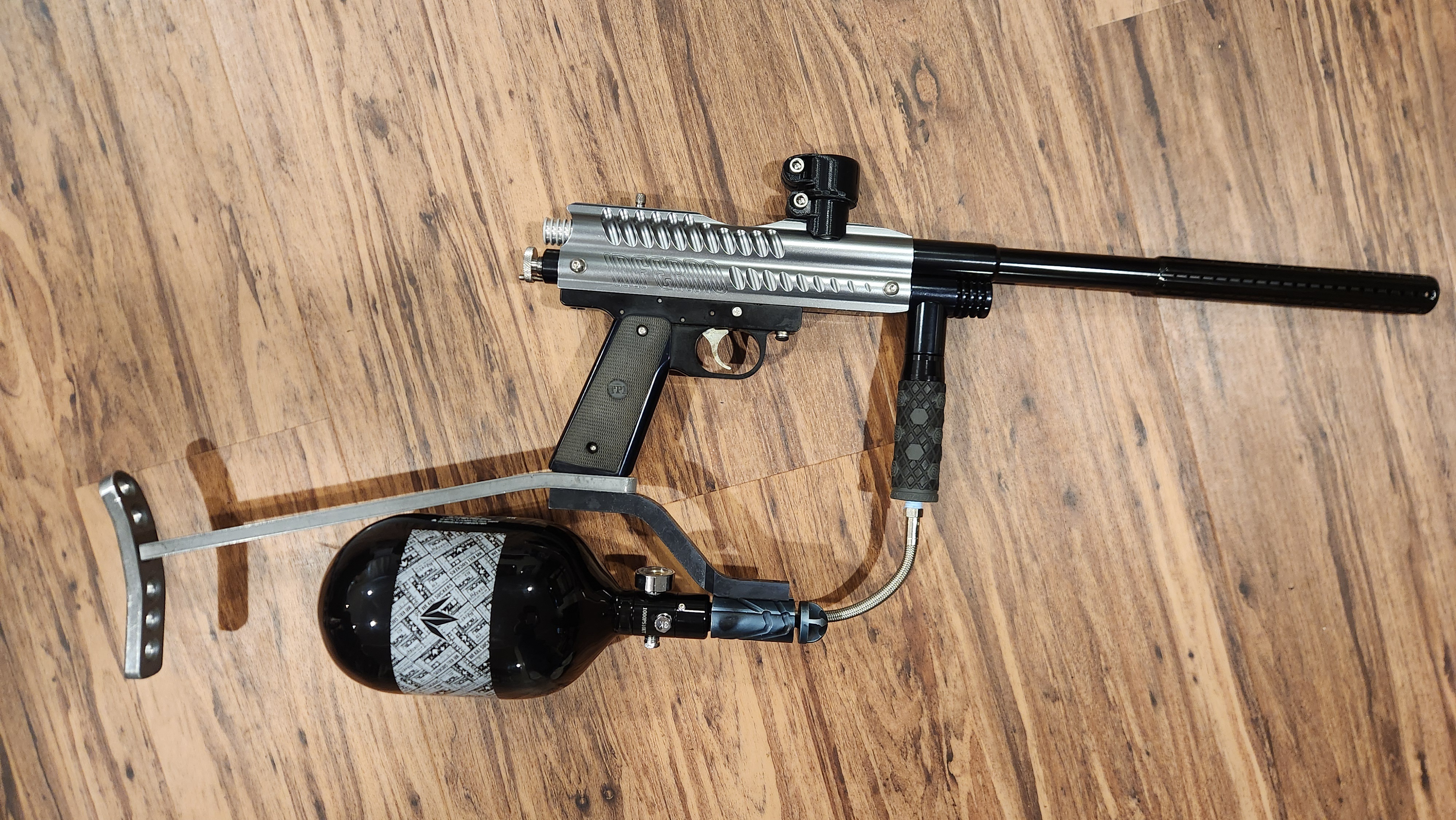

        I picked up a second Inferno a few weeks ago from another member. I had made some finger detents for them that had proven capable in testing, but this was the first time both infernos were used in game.
        Both guns ran spectacularly well. My favorite part is their loud barking report. Anyone that has a chance to get their hands on one should. These are quality items and have very few points of failure.
