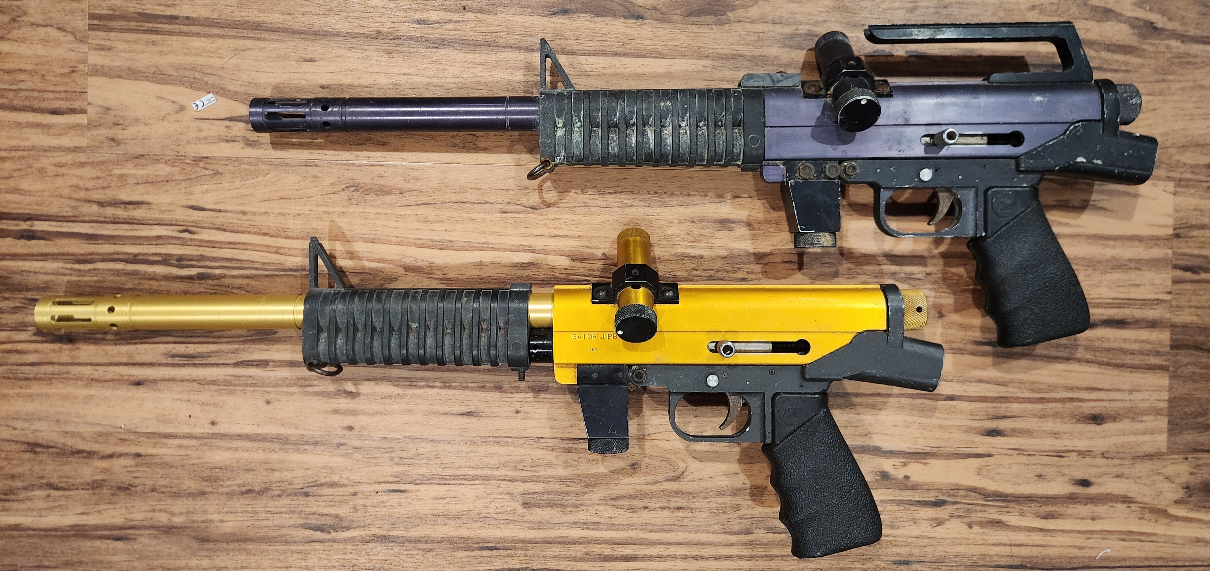

    I dug these out of the local field's storage closet.
ID:	822697 I never owned or fired one. There were two guys in the 1995ish local outlaw group that had them. One was a combat and one was a master. They seemed very happy with their purchases, and I don't remember them futzing around much with issues. I will start with the beat down one. Just hit it with penetrating lube on the exposed bolts. They look like trouble. Gonna get my run in and then see how they are in a couple hours.

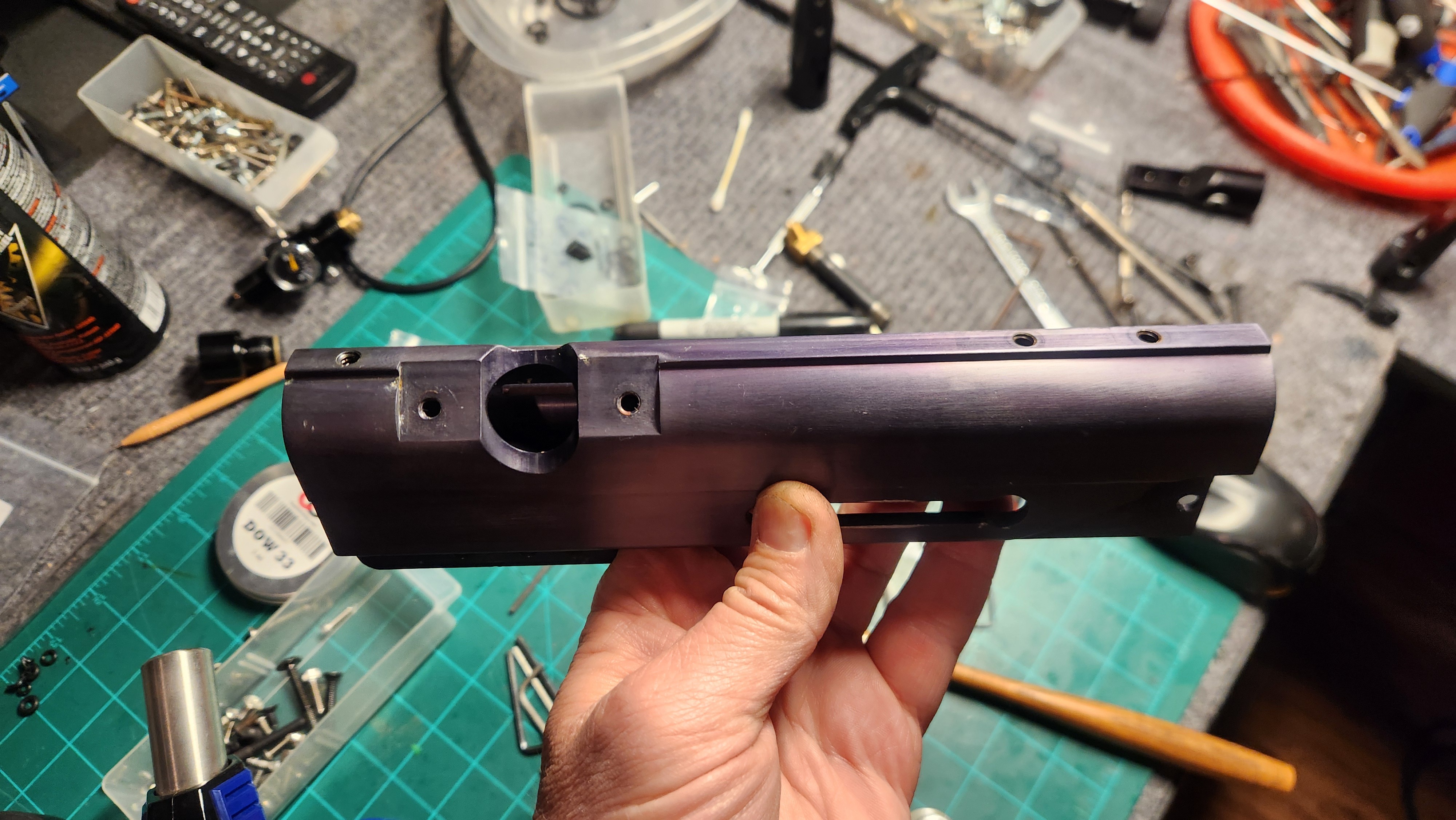

          What a mess that blue one was. You know its gonna be bad when there is still a paintball in the barrel. I managed to get all the completely rusted bolts out without damaging any of the aluminum. Very cool design, and I think I can get all the orings locally. I may have to make a new cup seal, so that will be fun. The main reason for my interest in these can be seen here:
          Click image for larger version  Name:	20260412_203503.jpg Views:	0 Size:	1.57 MB ID:	822826
          That 45 left feed area can let one do a ton of feed options. It also has the two threaded holes for the carrying handle sight rail. I'm thinking a back angled 90 fitting into 3 1/2" or so of warp feed hose going to a rear left mounted hopper feedneck in a bracket mounted to the rear holes.
