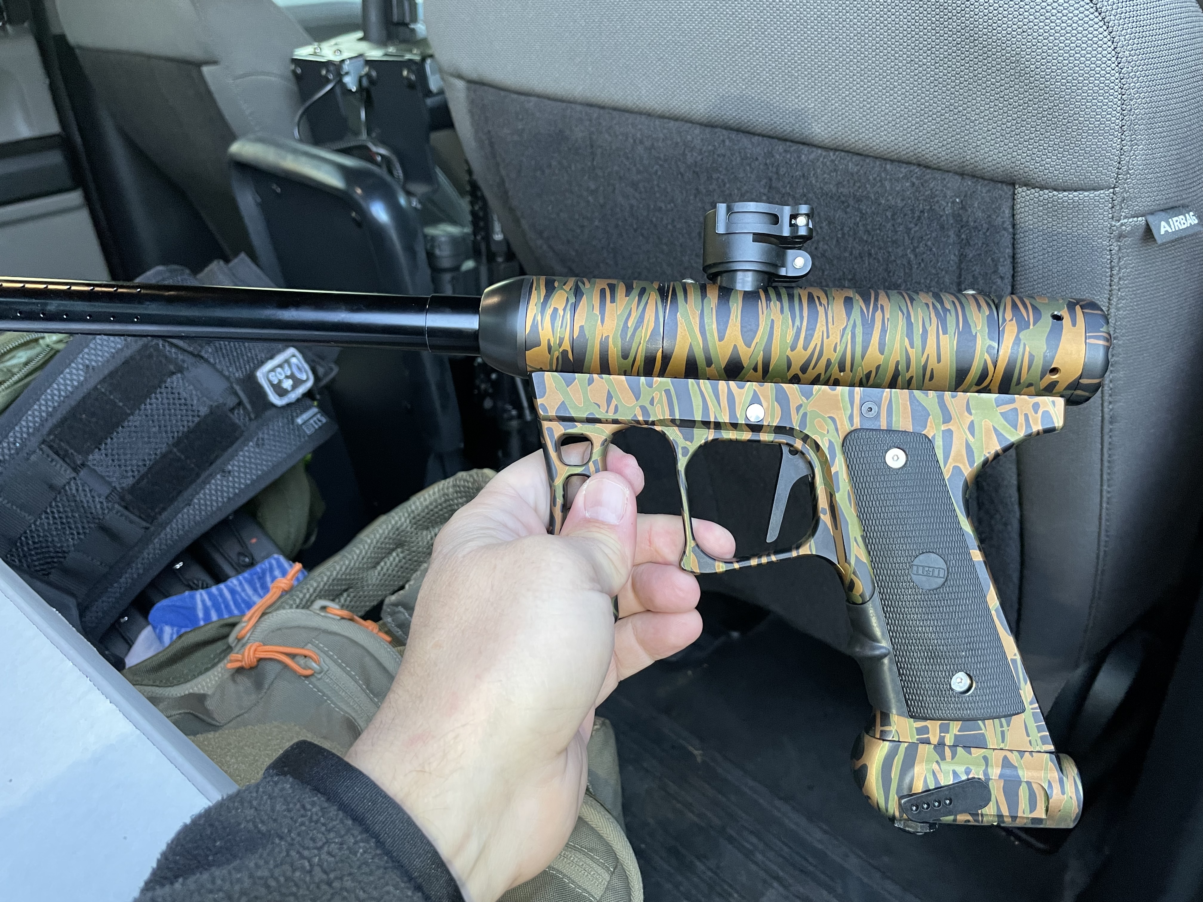

    Got my N3
    Feels good, nee to shoot it some. Trigger is crazy

            Any leaks or anything? I’ve read a few people have had some out of the box issues with the n3.

              no leaks. I did mess with the wrong adjustment screw and messed some things up. Reset it but still having ball breaks.

                I've got the leaking issues fixed with some modifications to the gun and improved the firing rate with a mod to the Rotor. You need to remove the actuation spring from inside the trigger assemble, then you need to install the new brass ring onto the spool valve housing, and finally change the spring tension on the ball detent and inside the Rotor if you have one, to get rid of any ball chops. I've posted a video N3 Trigger Repair - Upgrade - YouTube this shows how to remove the spring. The other parts should be available with the next few days and just contact me and we will ship the upgrades to you at no charge. Also this is T.J by the way.

                  I got the ring and the spacer for the detent spring. I’ll get them in Monday when I’m off.
