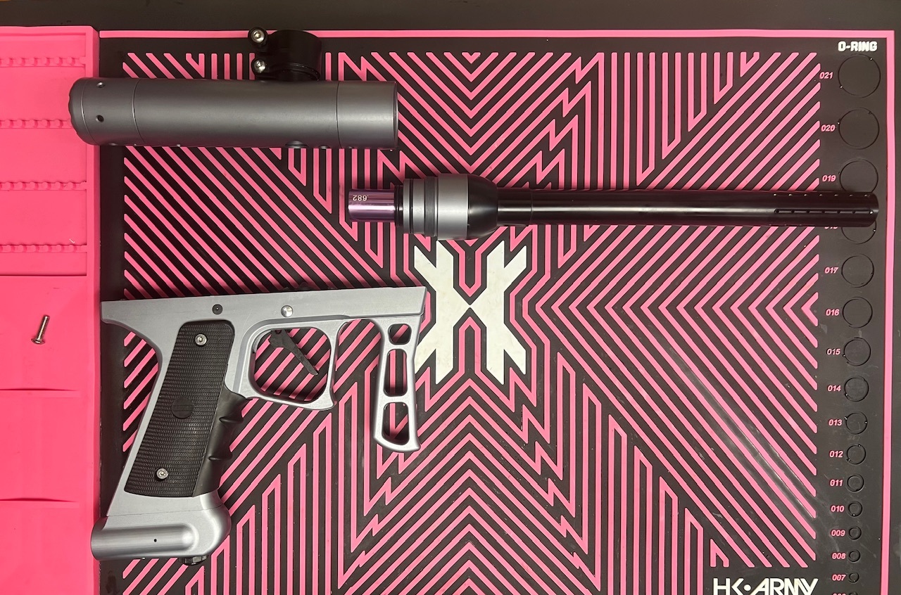

    And now the disassembly of a Nova N3 Hellion:
    First remove the front frame screw and loose the rear frame screw:
ID:	468050 Click image for larger version
    Then remove the front barrel assembly:

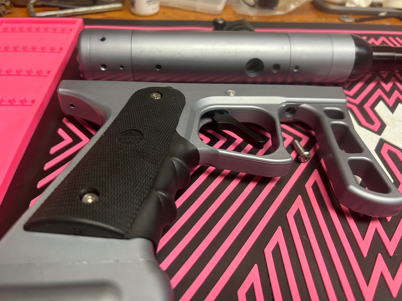

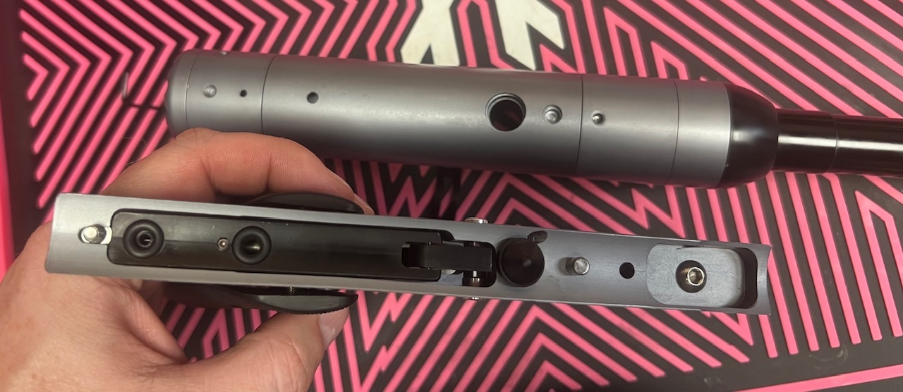

    • 4559

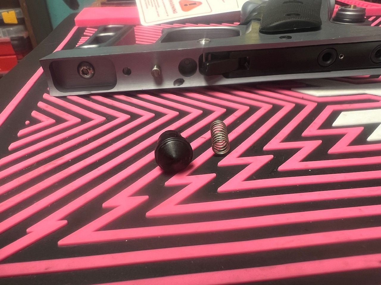

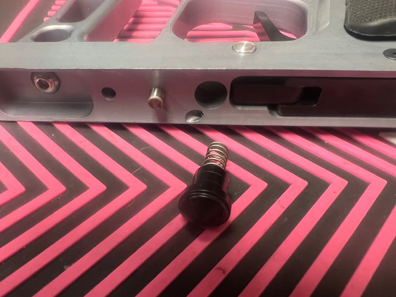

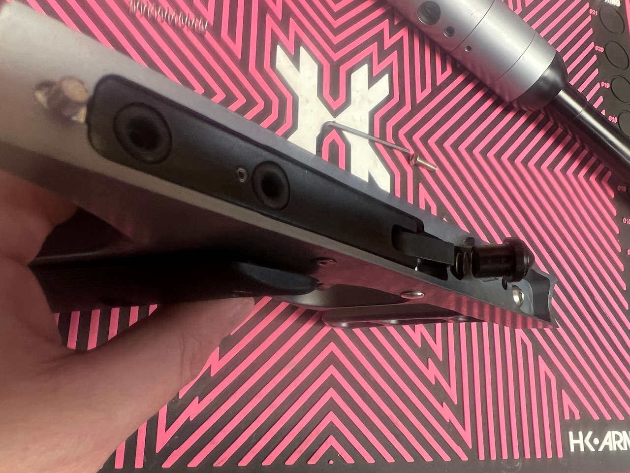

    Here’s a view of the trigger frame that shows the seals for the internal airway and the sear and the black detent (?). Note there is a spring under the detent.
    Angled view of detent and spring:
    And for clarify showing it outside the frame.
ID:	468099 Click image for larger version
      Cdn_Cuda commented
      Confused my springs in rebuild but have since corrected and update the information. The detent spring is the shorter spring, the longer spring is in rear assembly.

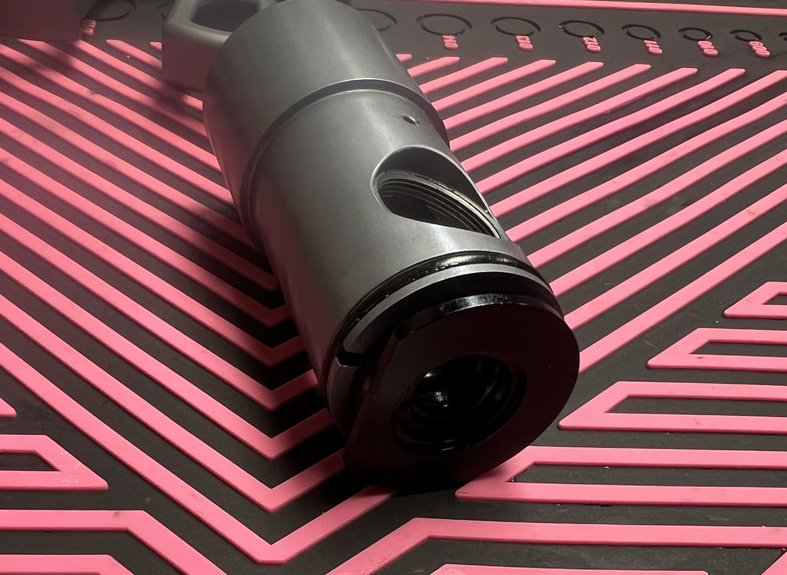

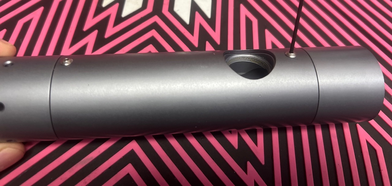

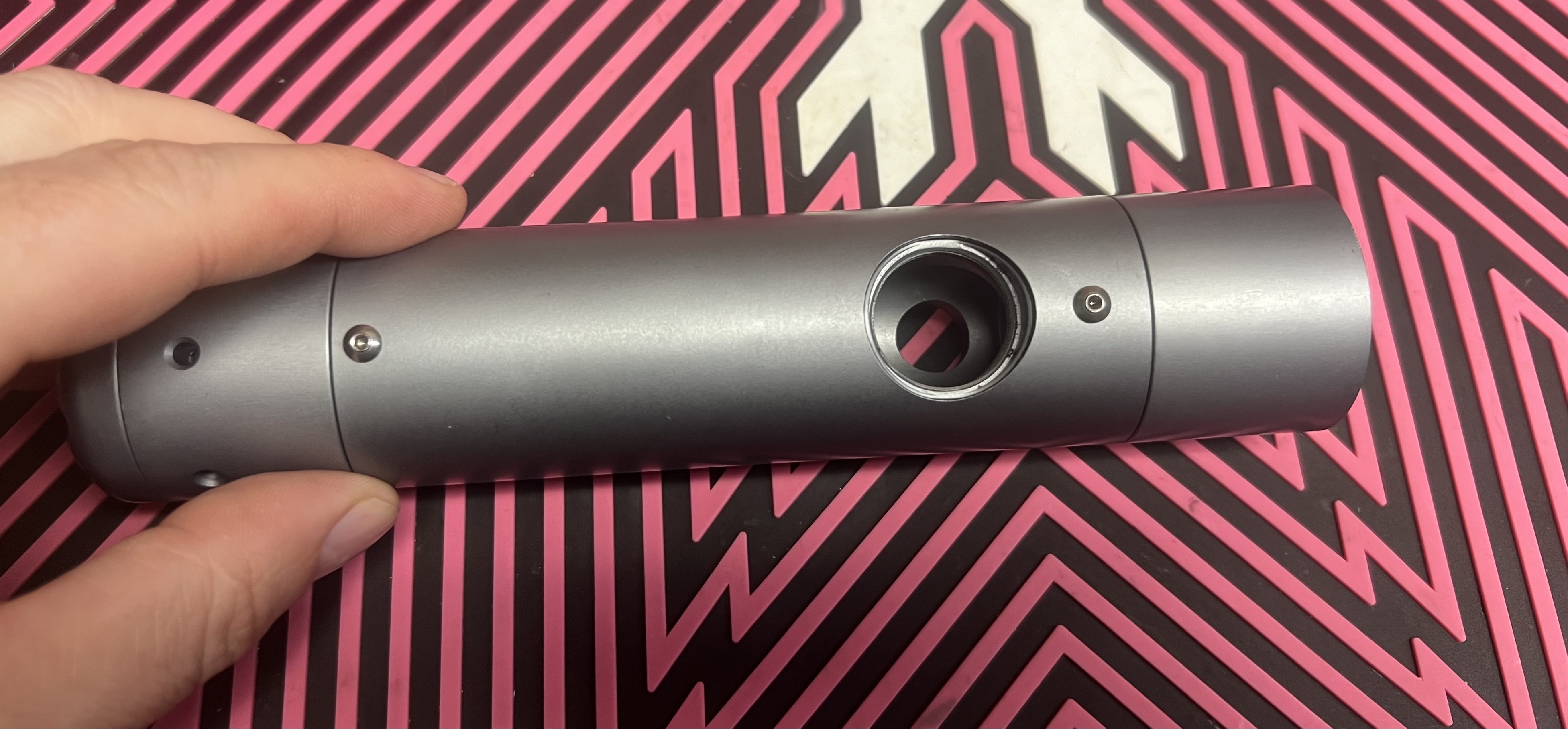

    Next we remove the feedneck:
    And remove the two small body screws:
    And slide the front section out of the main body:
    This reminds me of the lower tube assembly on a Palmer, just on a march larger and easier to deal with scale!

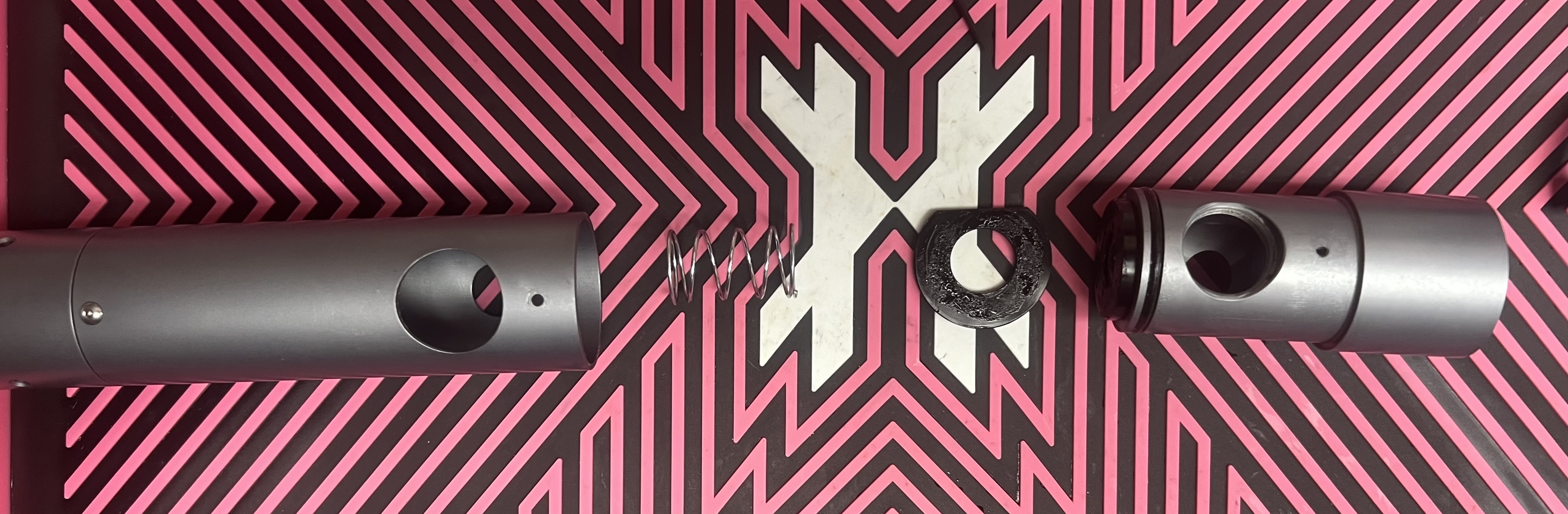

      • 4559

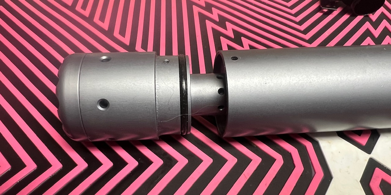

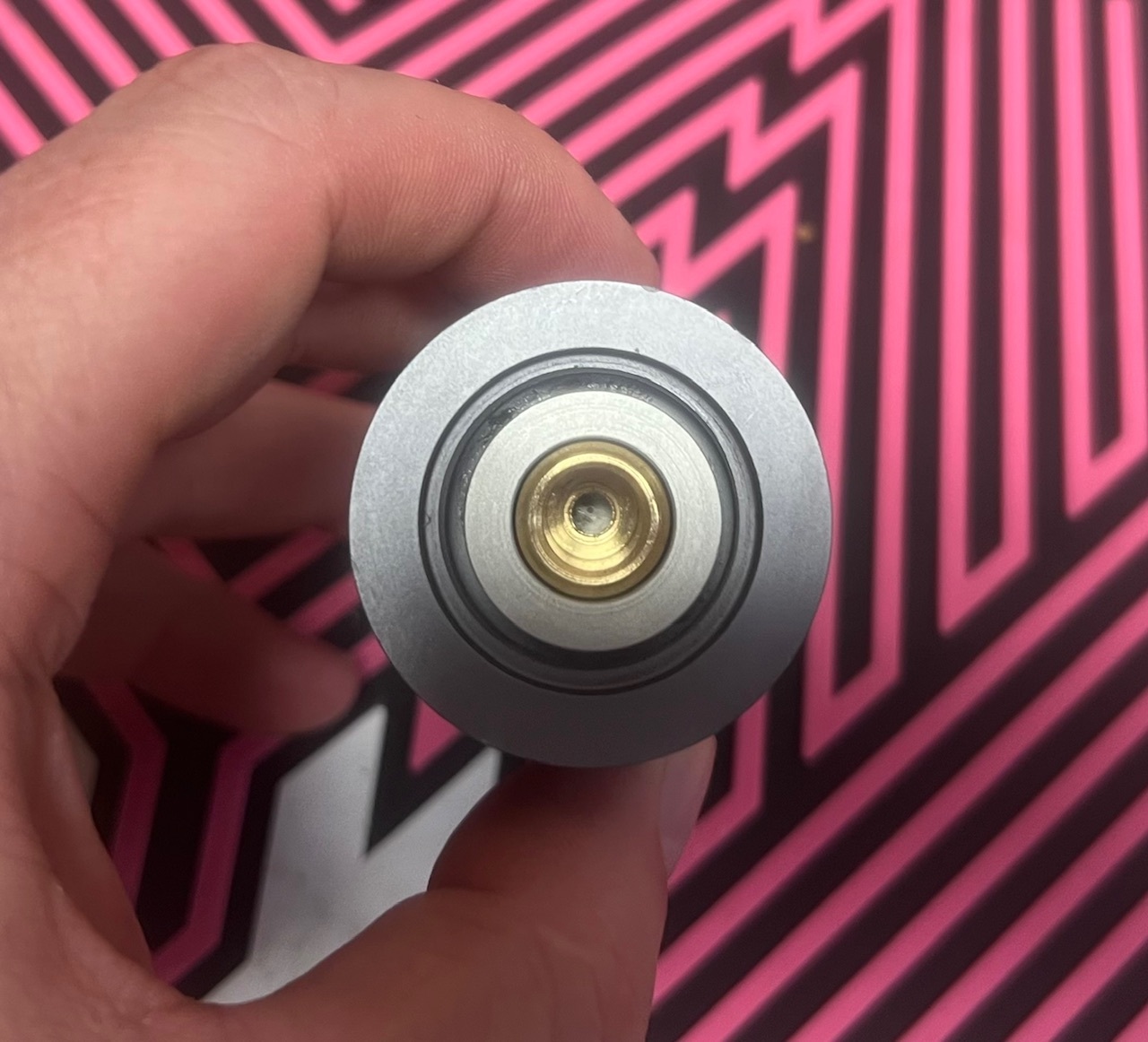

      Continuing to take the front section apart:
      There is a spring sandwiched between the halves and a mostly circular disc:
      And here is the disc in its proper position. I do. Not know if the flat spot needs to be in a particular place or not.

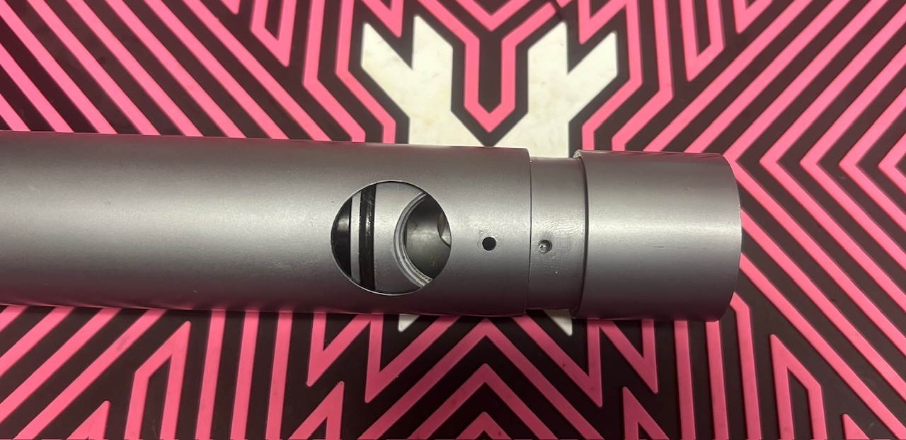

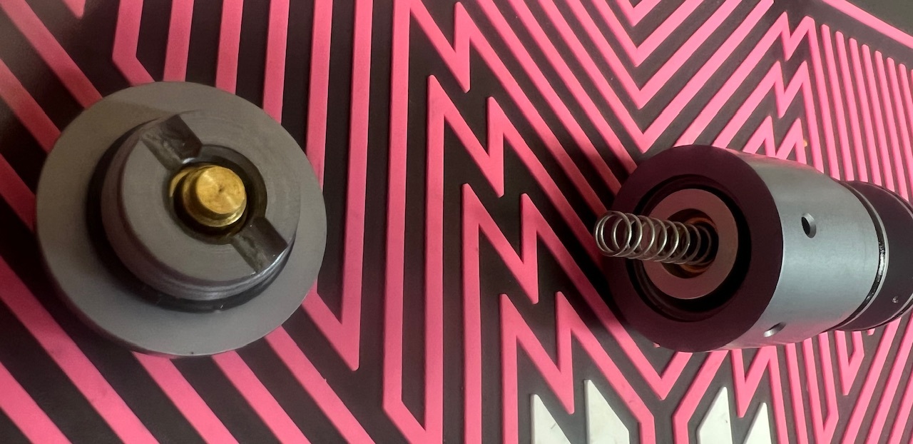

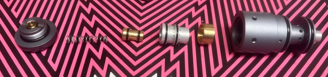

        • 4559

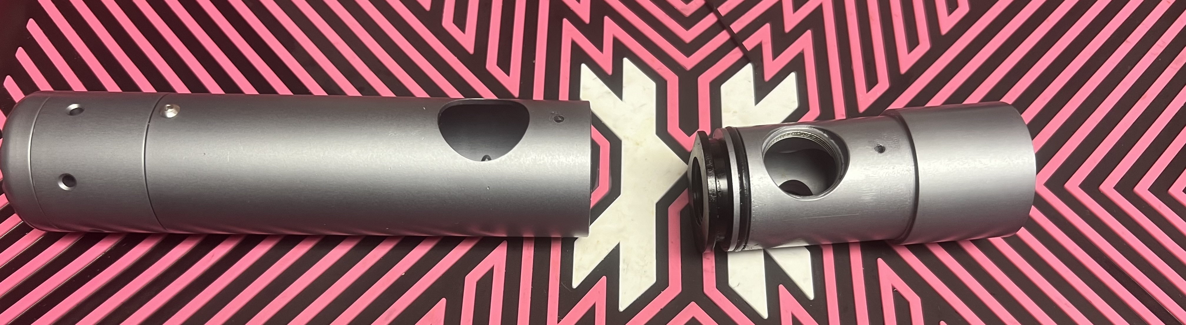

        And now to the back half. Let’s see that junk in the trunk!
        Click image for larger version  Name:	IMG_9646.jpg Views:	0 Size:	255.2 KB ID:	468114
        With the end cap removed and spring still in place:
        Click image for larger version  Name:	IMG_9674.jpg Views:	0 Size:	216.2 KB ID:	468115
        And the full exploded view with all the bits and pieces.
        Click image for larger version  Name:	IMG_9672.jpg Views:	0 Size:	152.5 KB ID:	468112

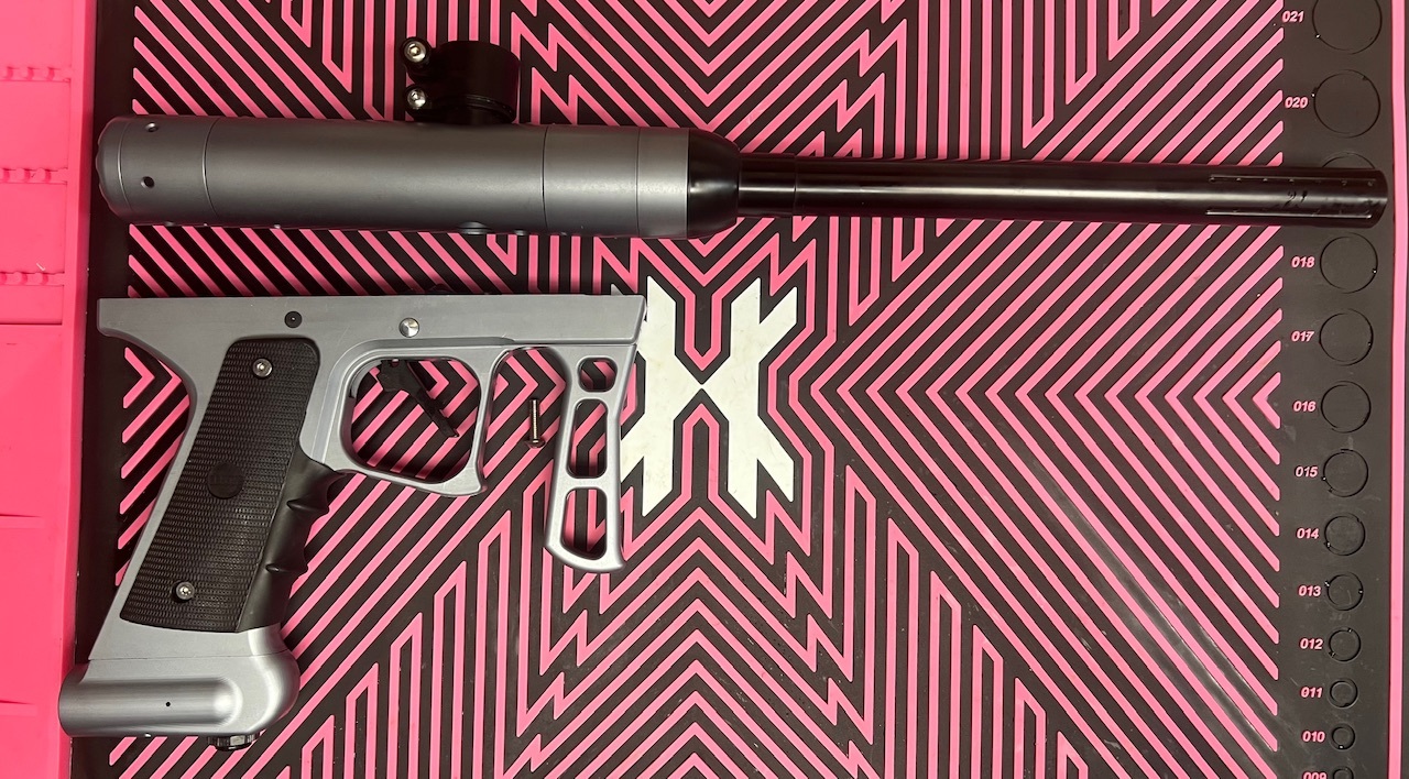

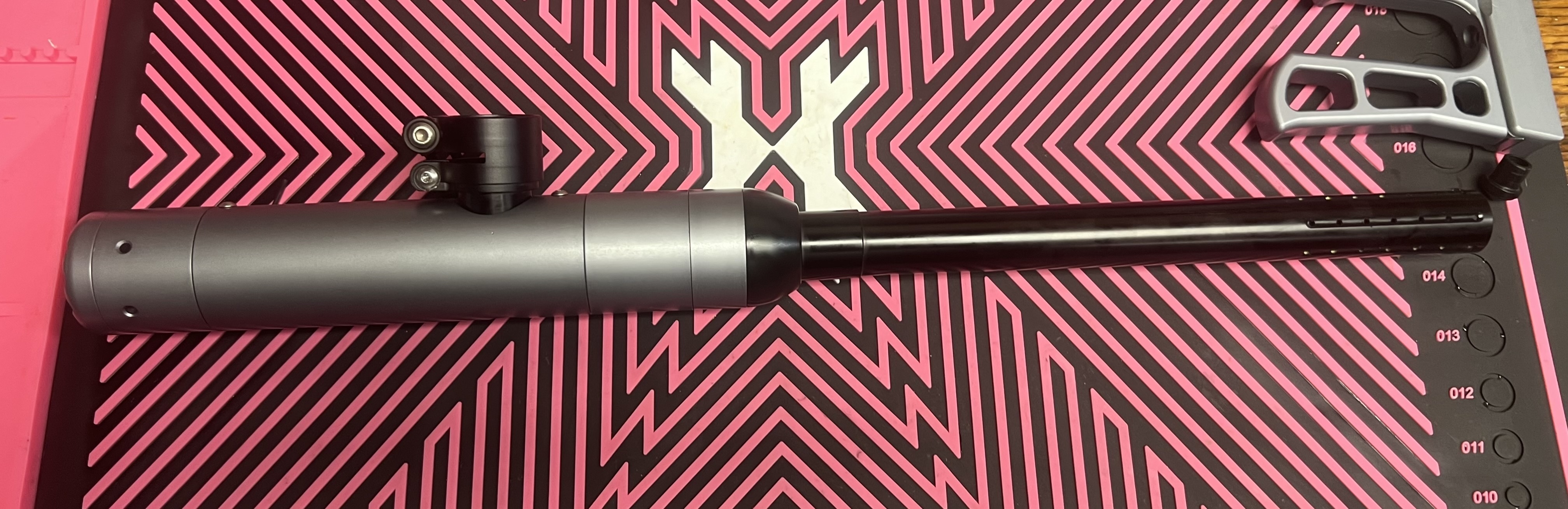

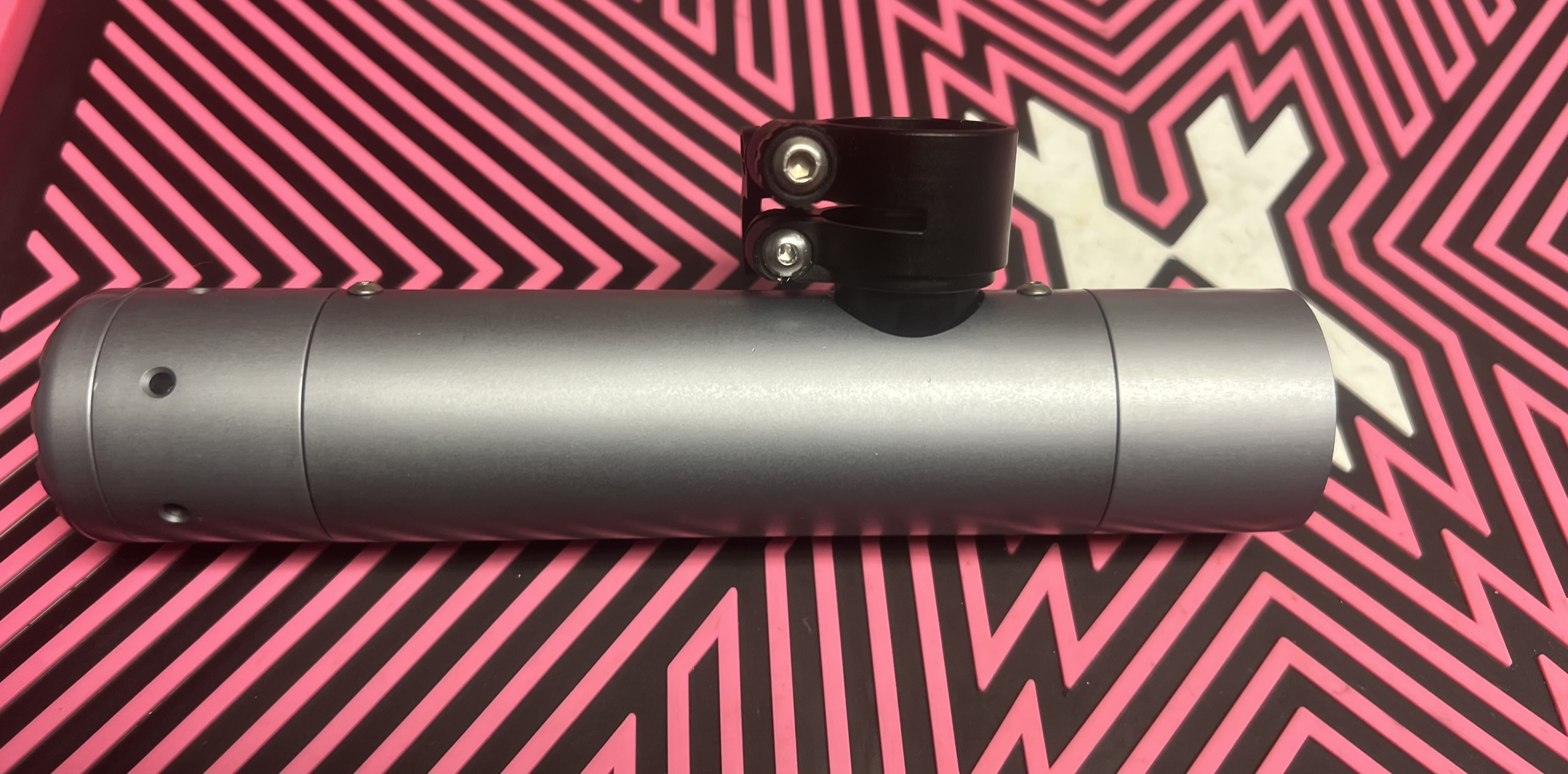

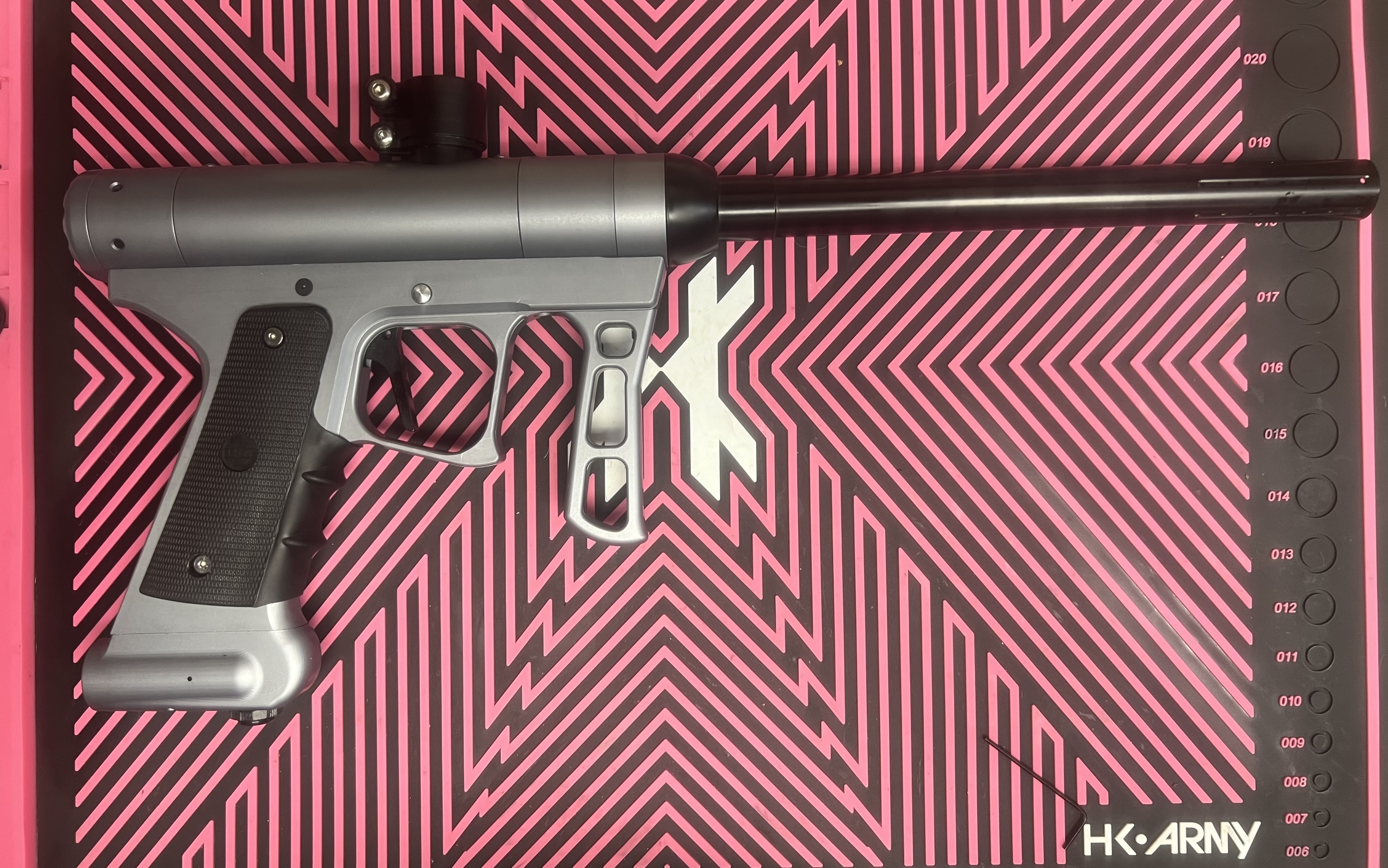

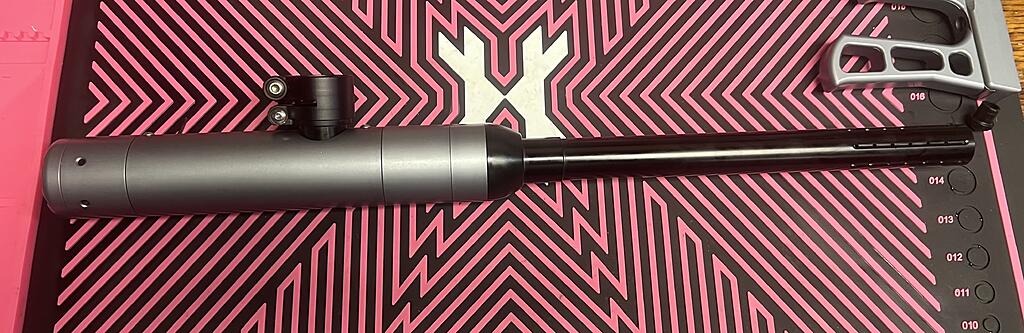

          • 4559
          Then you slide all the stuff back together, paying close attention to the screw holes:
          Click image for larger version  Name:	IMG_9664.jpg Views:	0 Size:	1.21 MB ID:	468121
          Then add the feedneck back on:
          Click image for larger version  Name:	IMG_9665.jpg Views:	0 Size:	1.28 MB ID:	468123 Put on the barrel assembly:
          Click image for larger version  Name:	IMG_9666.jpg Views:	0 Size:	1.13 MB ID:	468122
          And reattach the trigger frame.
          Click image for larger version  Name:	IMG_9675.jpg Views:	0 Size:	2.29 MB ID:	468120
