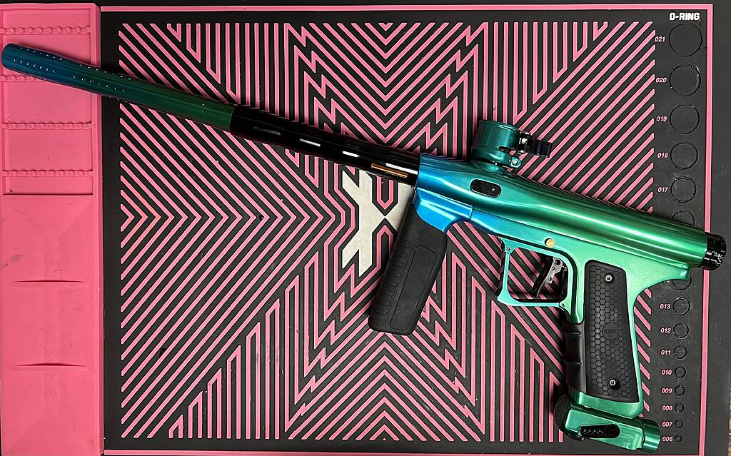

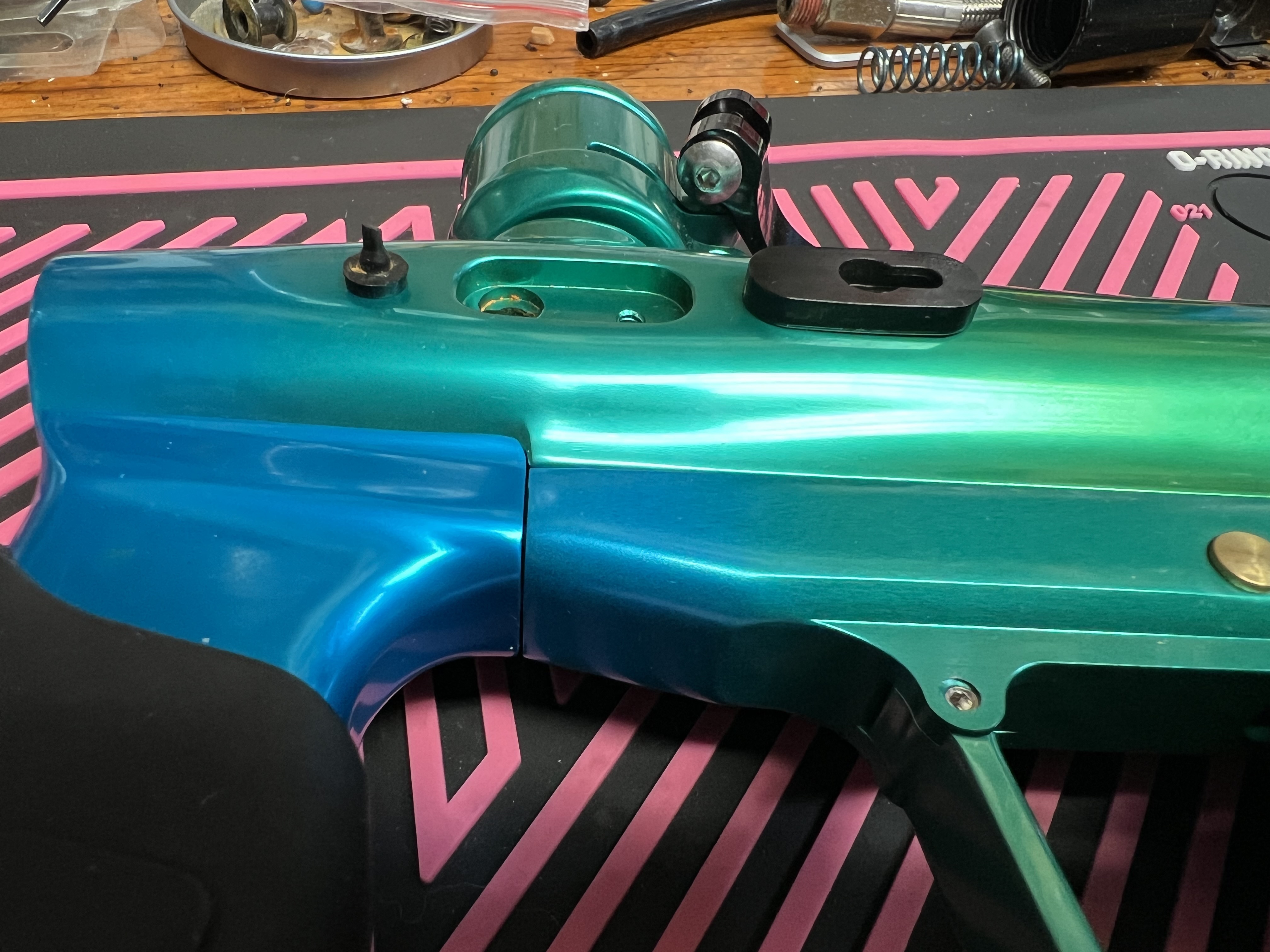

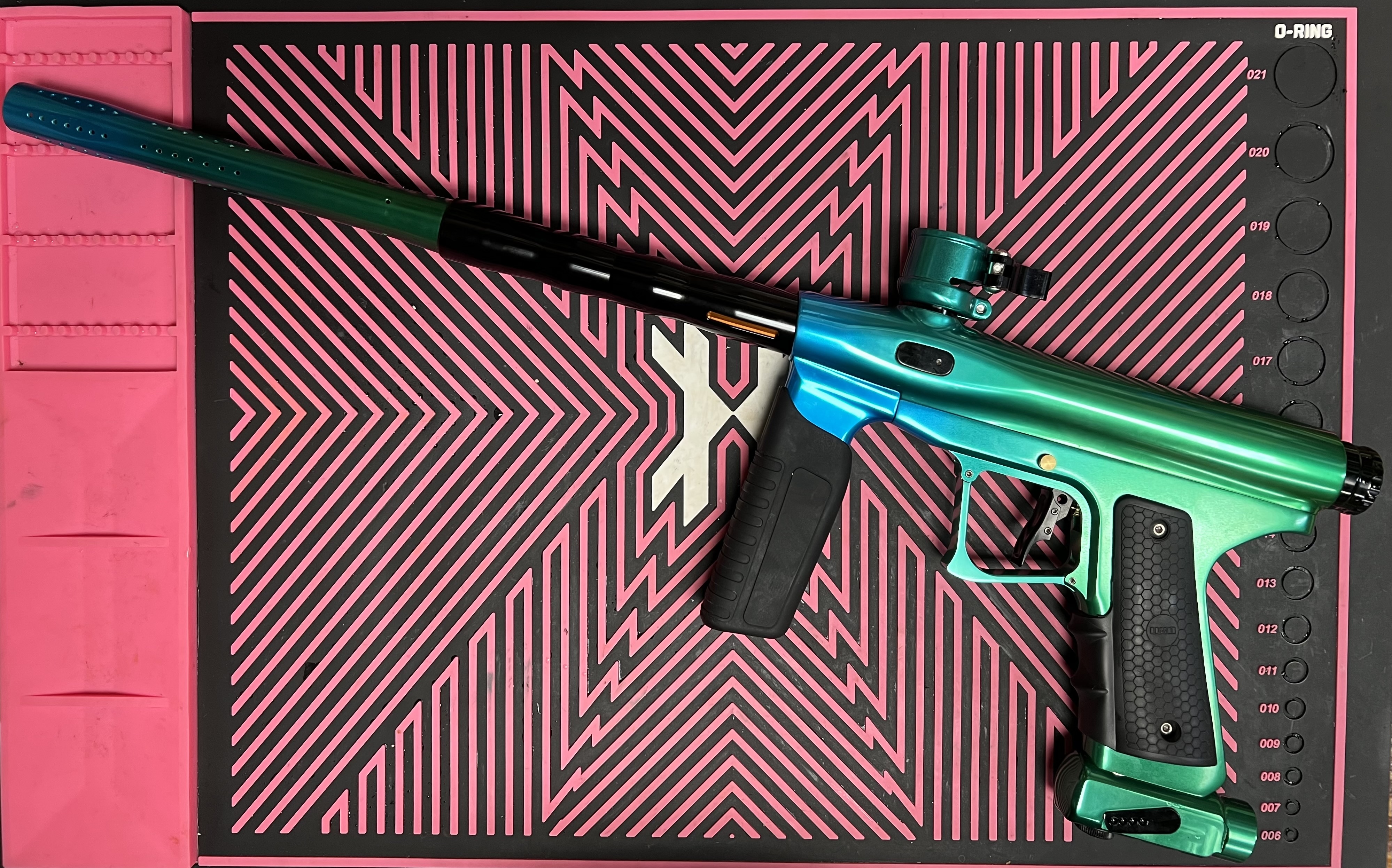

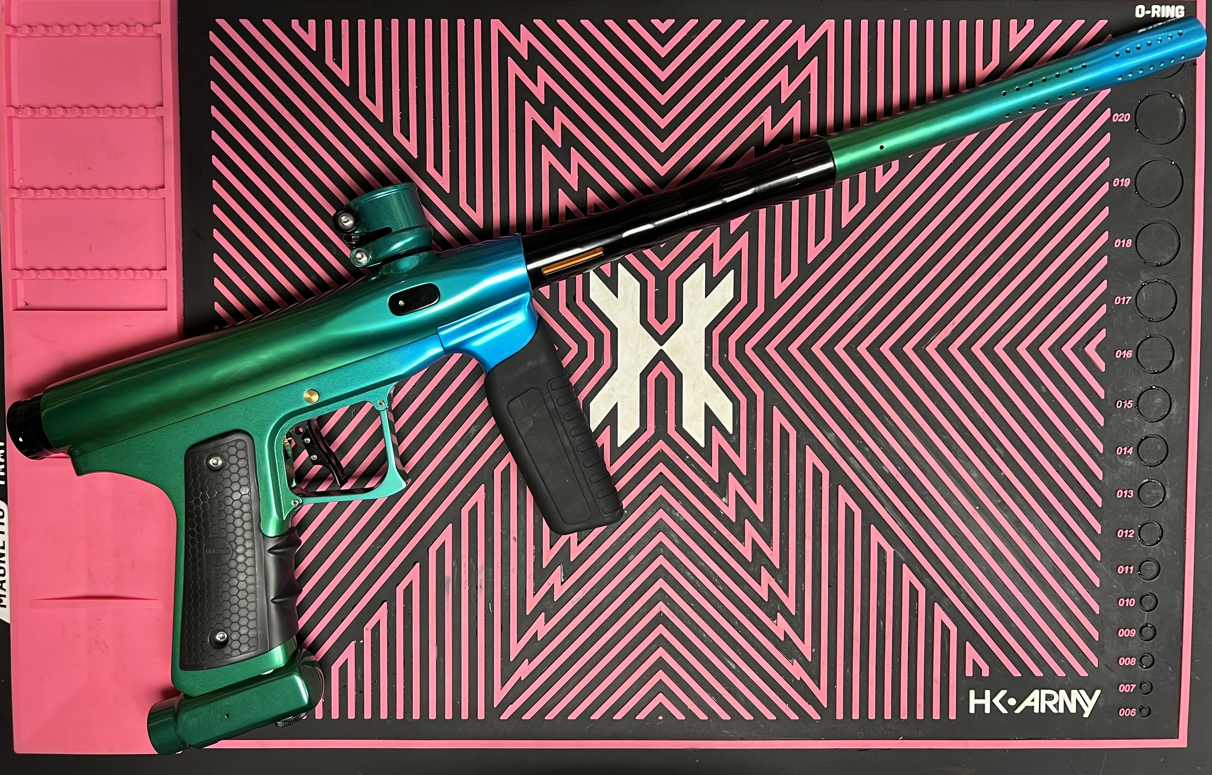

    Just picked a Nova N2 Dreadnought, so figure I would do an overview of its. Not sure I want to take it apart quite yet, but I’m sure I will get there.
    So to start, this is the updated version of the Nova N2 which features a different trigger frame and grips and colour matched barrel. There were some changes to the bolt as well. I have never shot an original N2, so I am ignorant on the changes. But you check out Jigs Salazar’s YouTube video on it as he does a lot with Nova. (Which will not link for some reason….)
ID:	747800 Click image for larger version

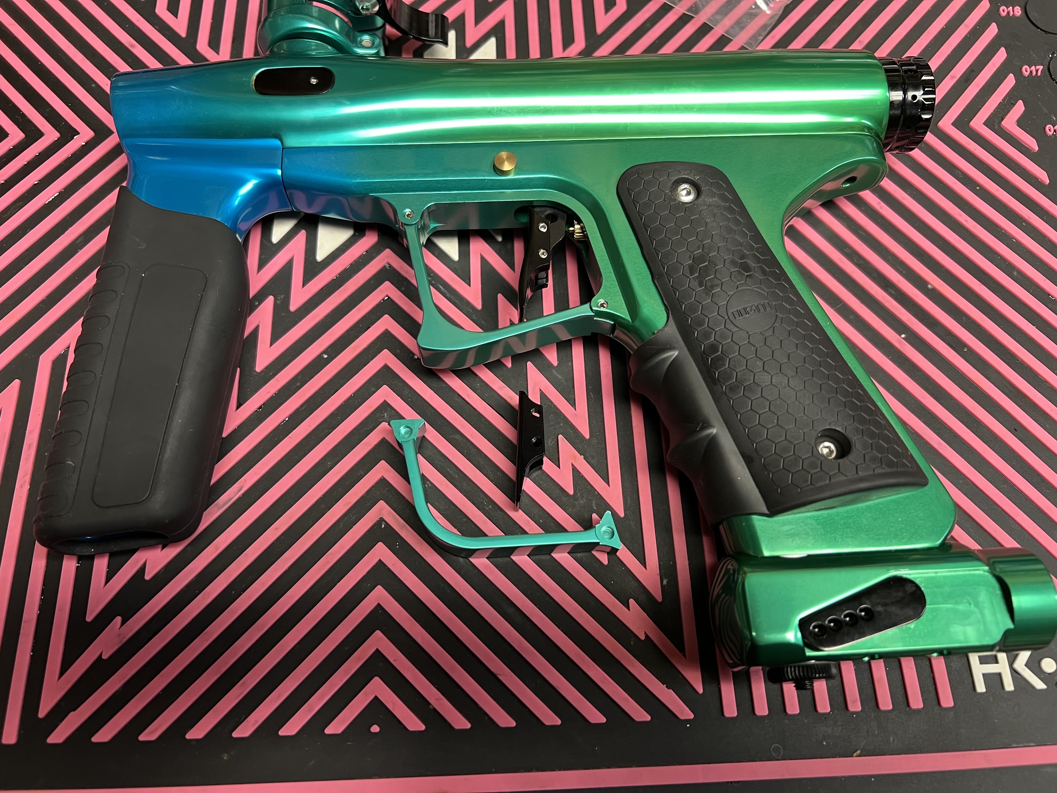

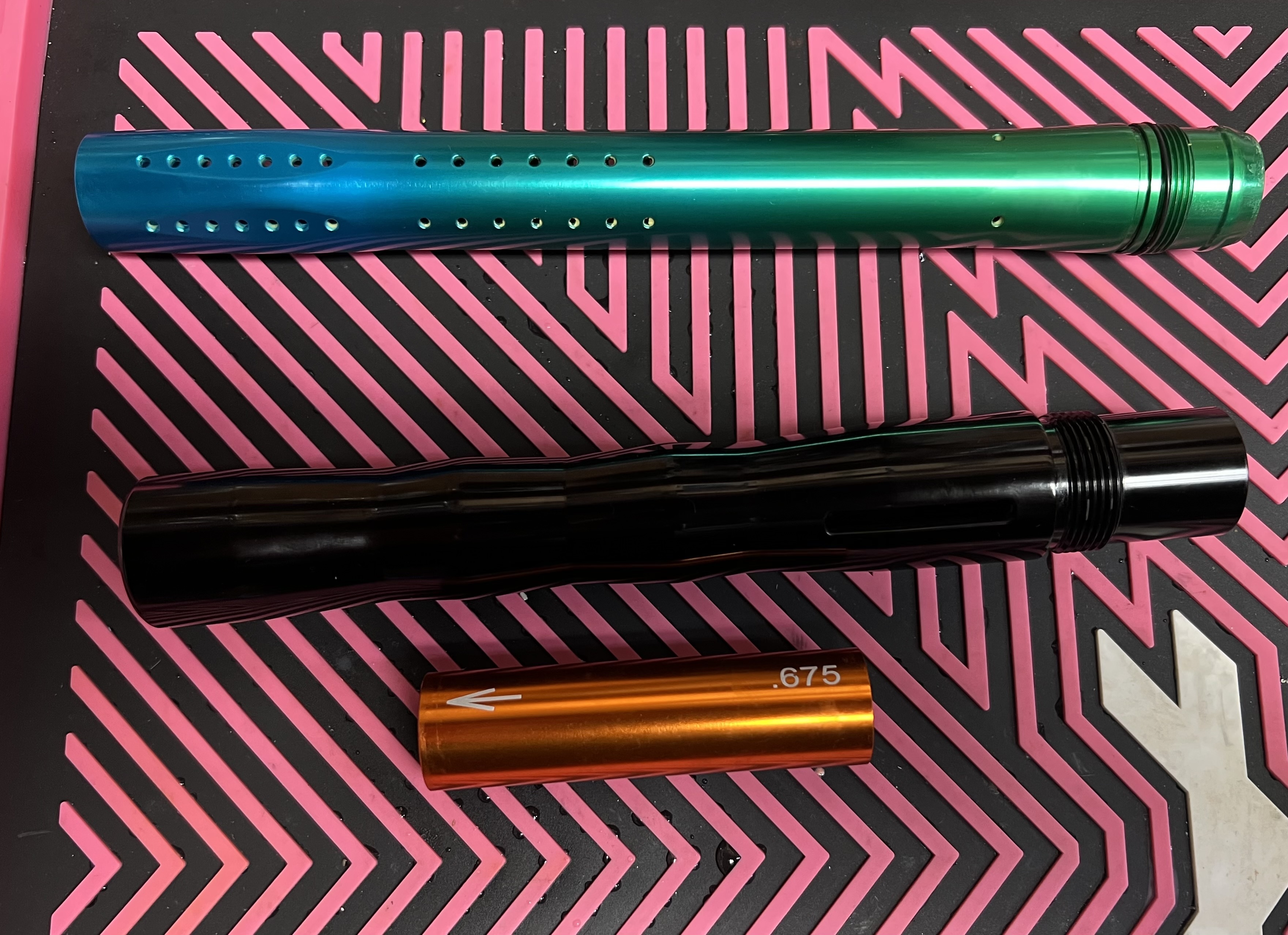

    So this came with a Nova case, full set of inserts and the optional single trigger.
ID:	747803 Click image for larger version

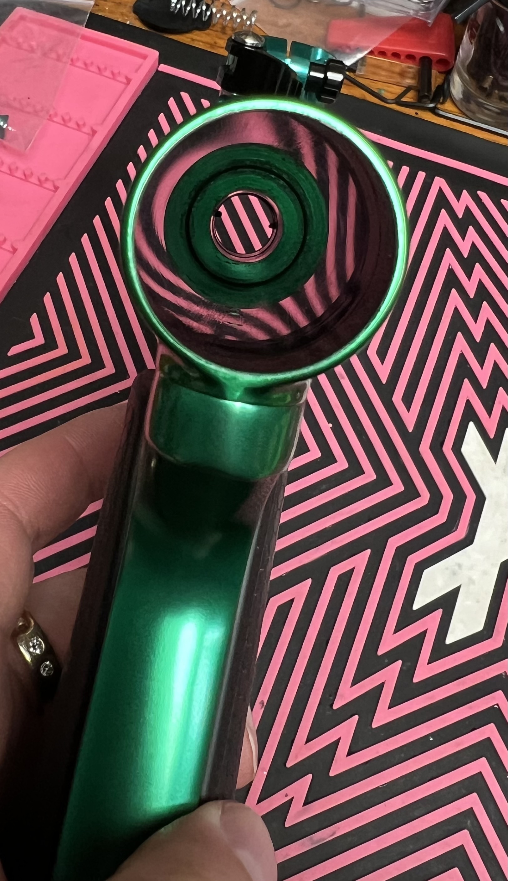

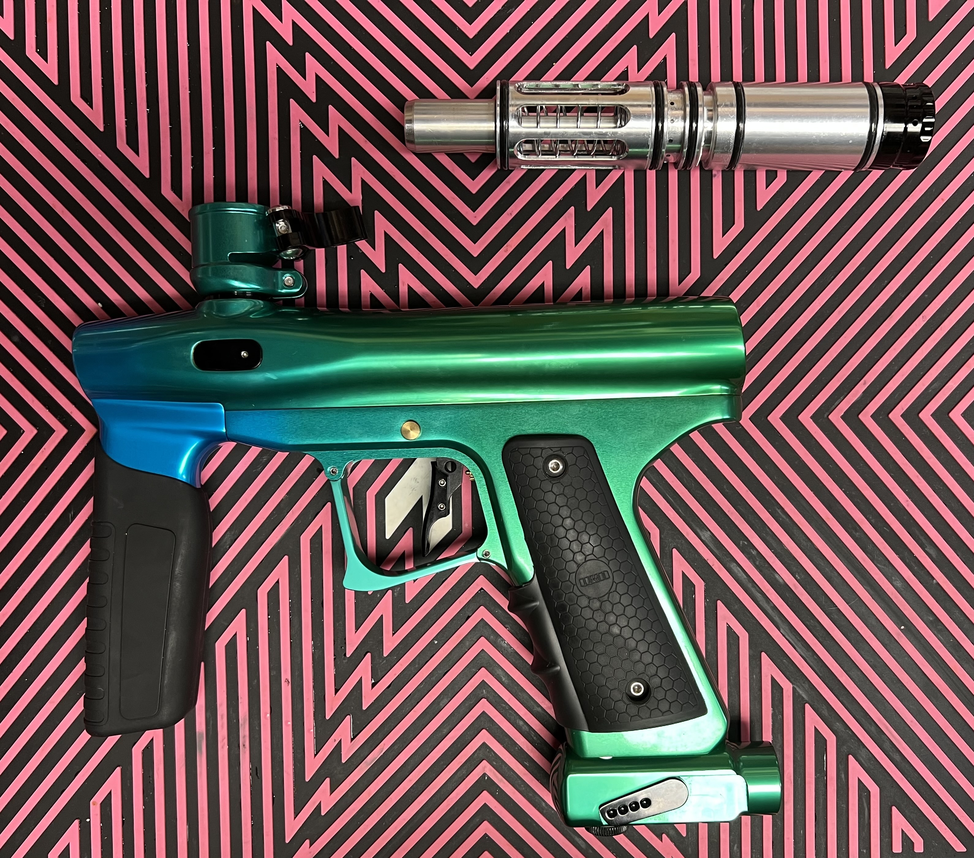

        Bolt easily slides out the back and you can see the two detents in the body:
ID:	747810 Click image for larger version

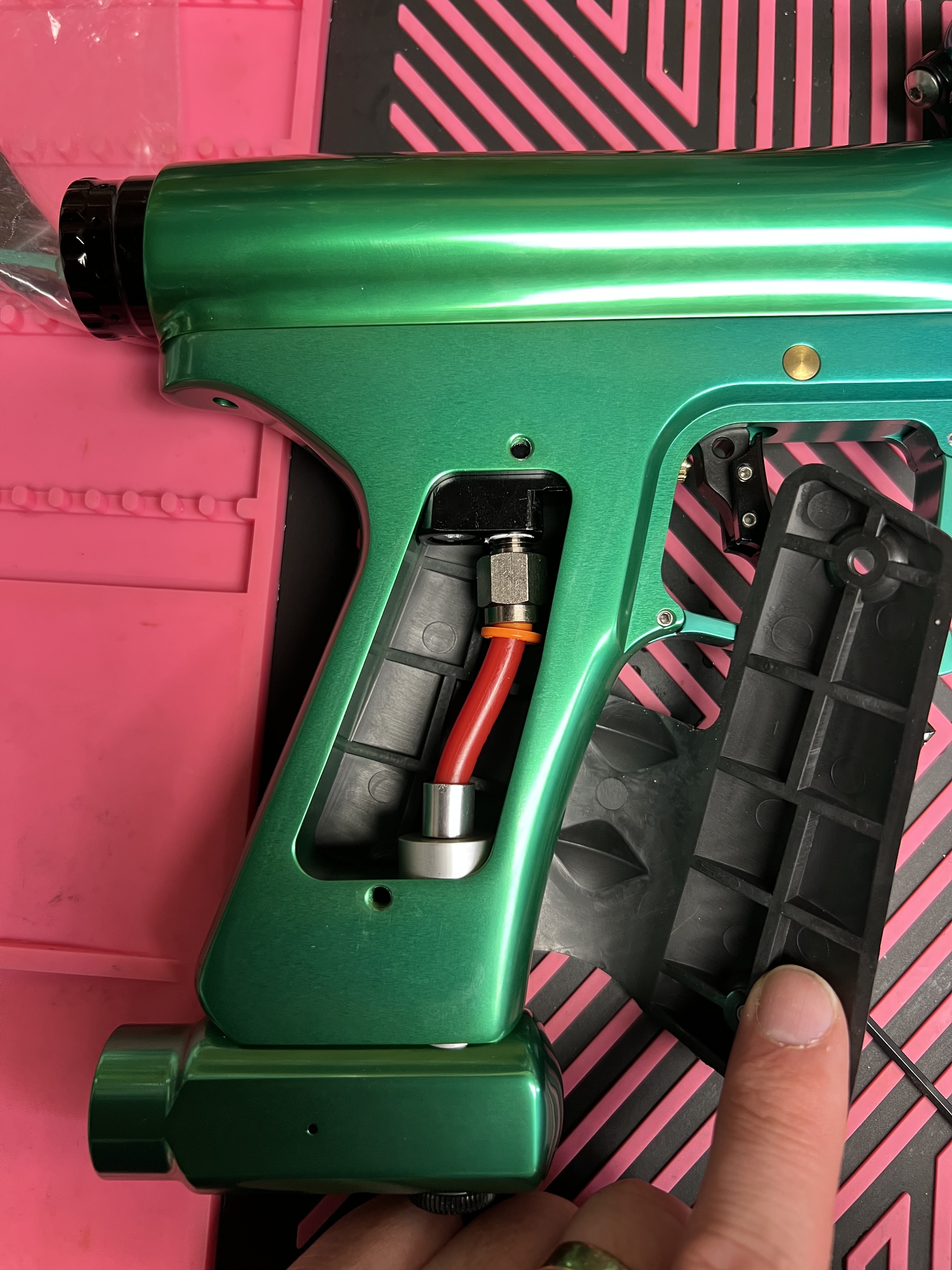

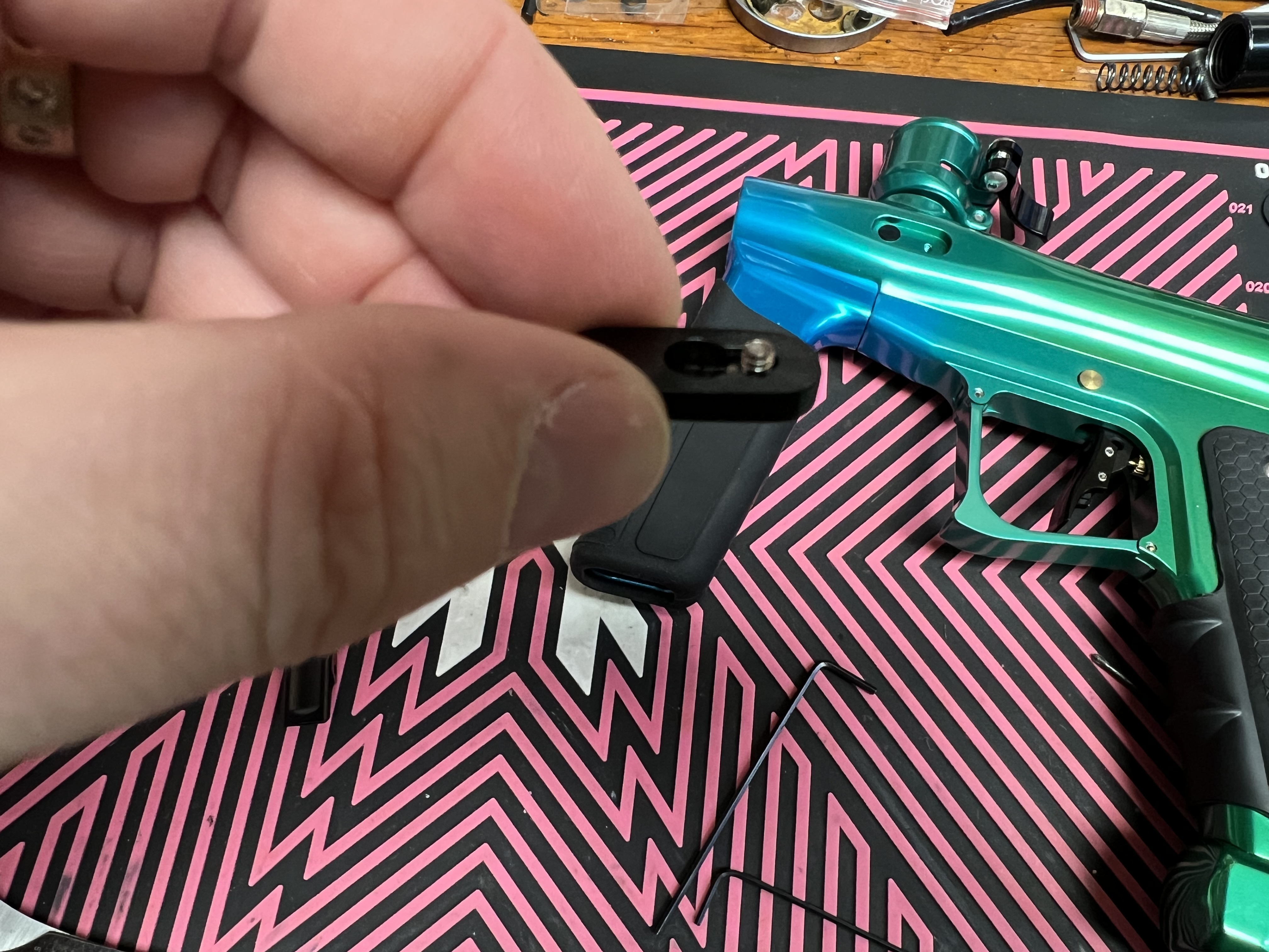

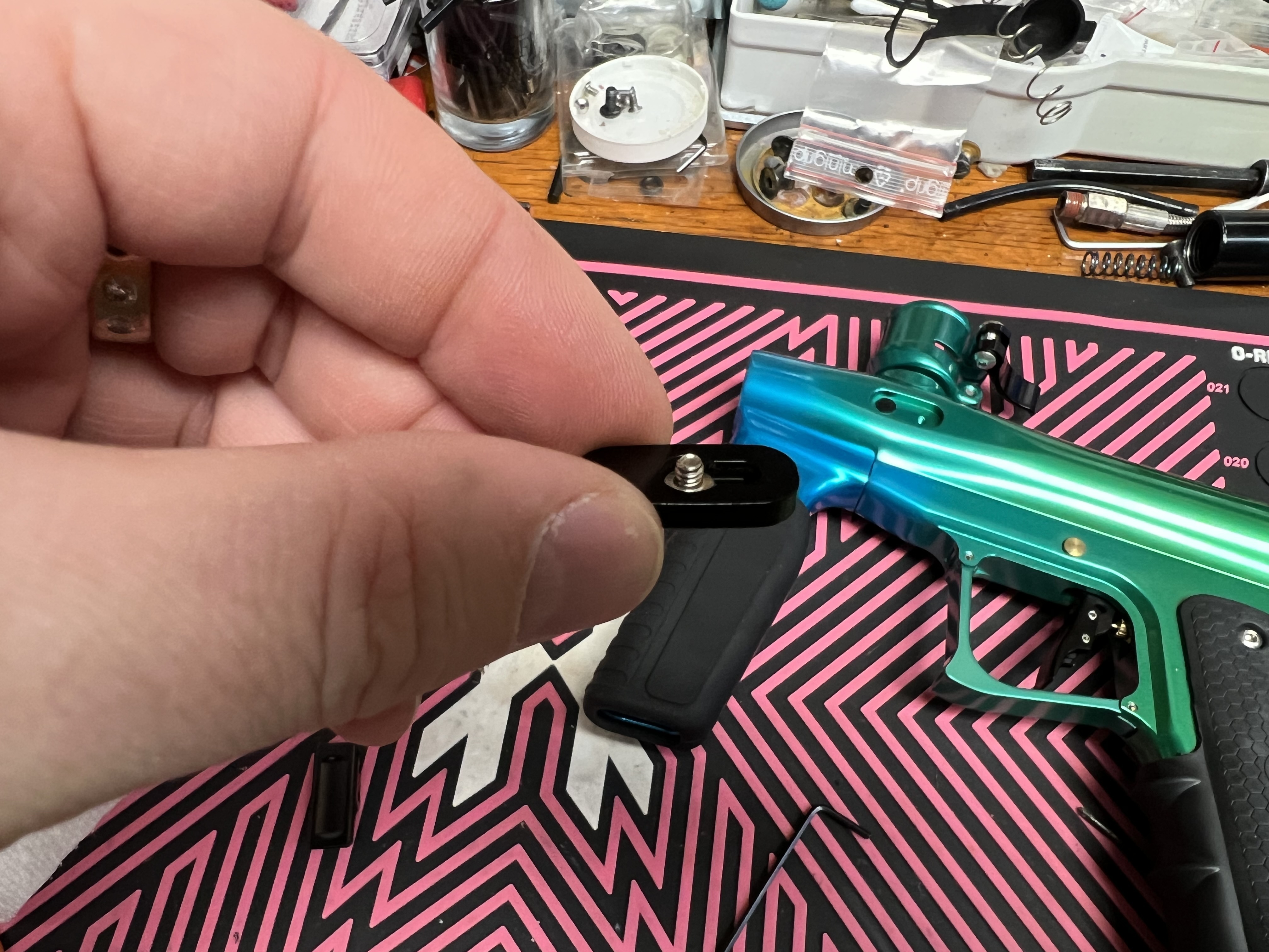

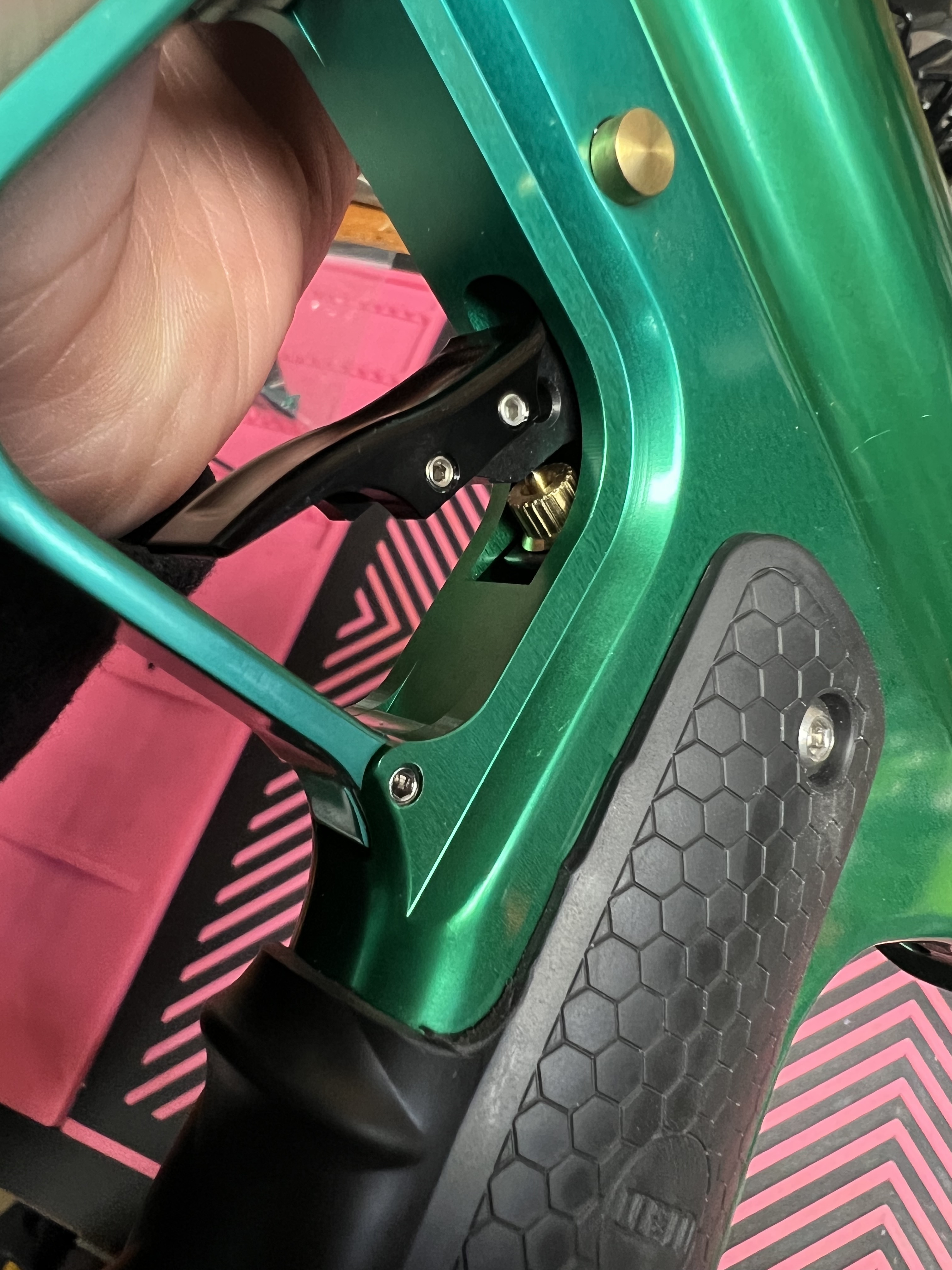

          Under the grips is the airline. And it comes with a replacement.

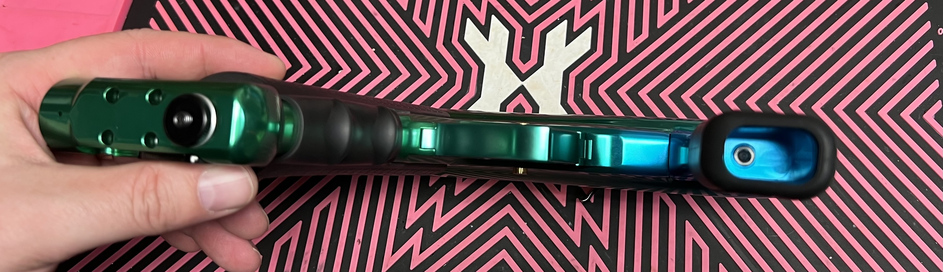

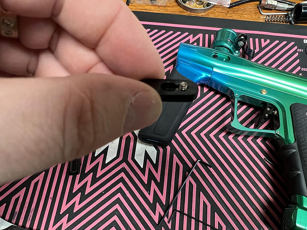

          The front grip is held in with a bolt and is hollow:
          And you can see the trigger valve, kinds similar to an Emek or Etha3M.

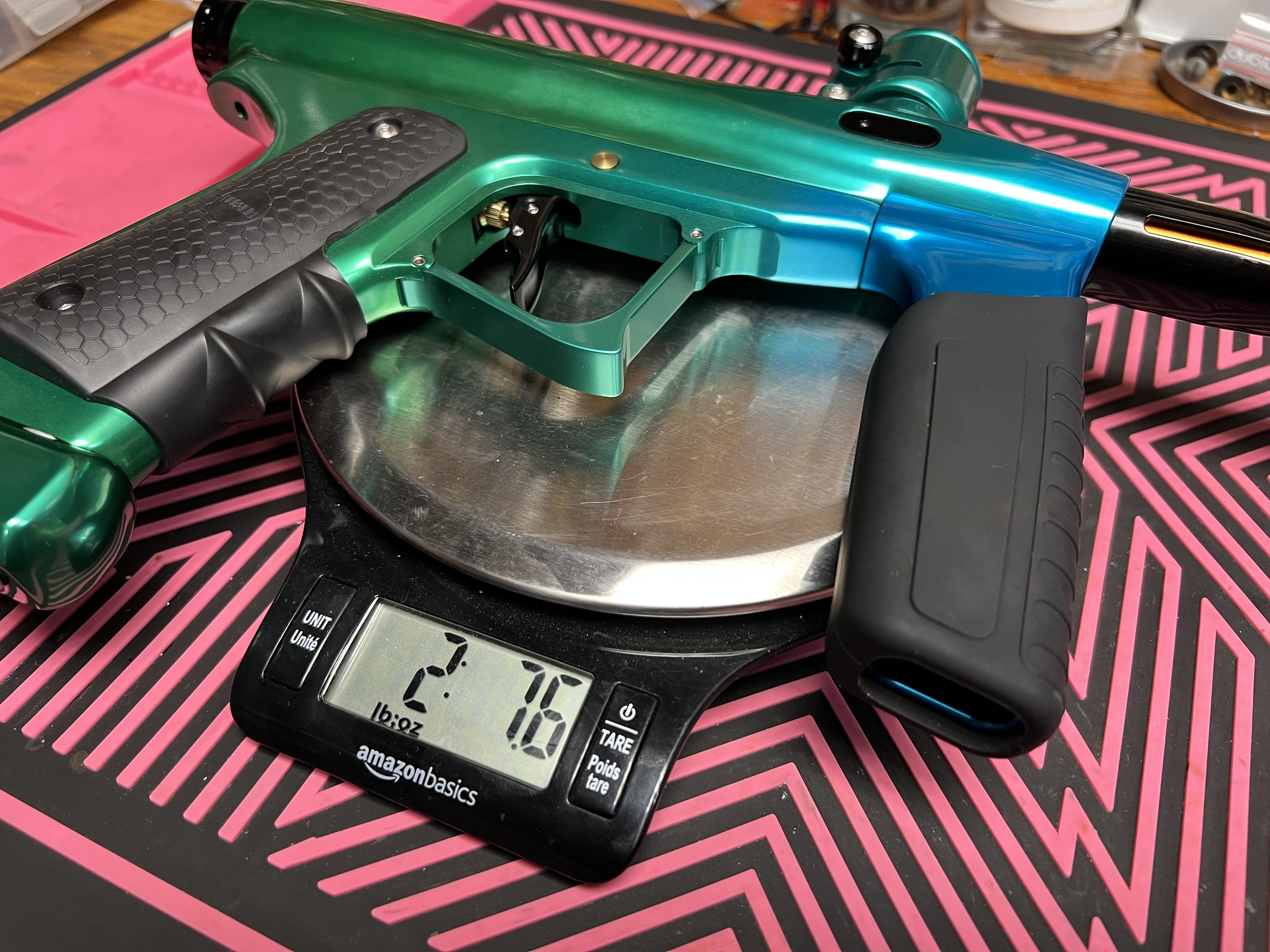

            And finally (for now) the weight on a scale:

              I did take a moment at lunch to shoot a few balls balls through the N2 V2 and damn it is fast. I’m not great on the trigger, but could easily walk the marker. And despite using crap paint, no breaks either. I used a Dye Rotor and a barely filled 13/3000 tank which shot almost the entire hopper.
              It feels nice in the hands, but the 45 frames makes it hard to reach the trigger if you have smaller hands. If you have big ol’ bear paws you should be fine. I have not swapped to t the single trigger yet. I can fit two fingers on the trigger, but again, those with bear paws may want to stick with the single trigger.
              The marker feels nice and light and with a great trigger feel. It felt like the only delay was the speed of fingers and not the marker. It is a true modern speed mech.
              I’m going to need more trigger time with the marker but I am impressed so far. Hopefully I’ll get a chance to hit the field before the weather turns. I would have loved to had this marker last scenario game.
