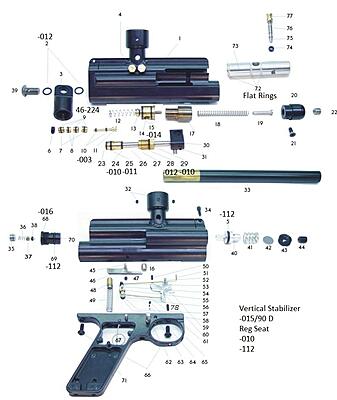

    Anyone have the 2k Blazer oring chart that shows sizes?
    Here is my diagram, I filled in the sizes where applicable. This is a 2K Blazer body, and the seals originally are all Polyurethane 70 Duro, however more recently with more people using HPA they have switched some static seals to Buna-90, and others to just standard Buna-70.
    If you're using HPA all these seals can be replaced with Buna-70 safely.
    The switch cup seals are a special size, they can be bought still from Palmers.

      Thank you! My ram oring went bad at monster game. I was hoping to pick up a few spares local.
