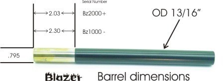

    Had a bit of a blast from the past today; a customer wanted a barrel turned down to Blazer spec.
    Haven't done that in a dog's age, and naturally, I can't find my notes with the old specs. That was from so long ago, that was before I really started cataloguing my data.
    As I recall, it was .0795" diameter by 2.300" long, can anyone confirm that for me?
      Doc.
      you recall correctly, but typed it wrong 😅
      Just measured mine at 0.790"OD by 2.300" long 👍

        Blazer 1k or 2k? If I could remember where my Blazers are, I'd let you know for both. I just know there is a difference between the two versions.
        -Pretty sure this guy has a 2K. Are there even all that many first-gens running around?
        -I was pretty sure, but wanted to check. Hard to put the metal back on, after all.
        Thanks!
        Doc.

          1K Blazer .795" OD by 2.300" Long
          2k Blazer .795" OD by 2.03" Long
