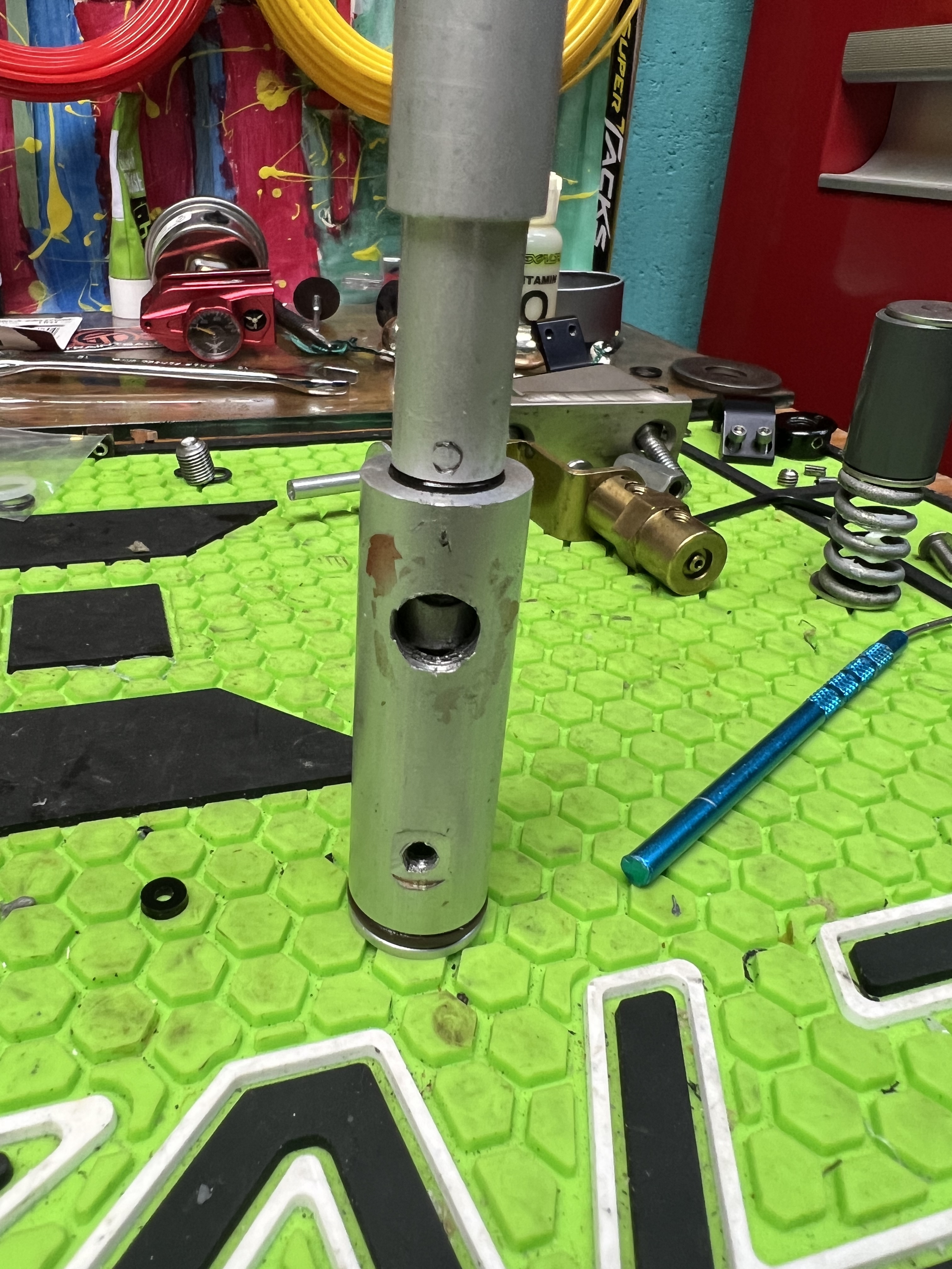

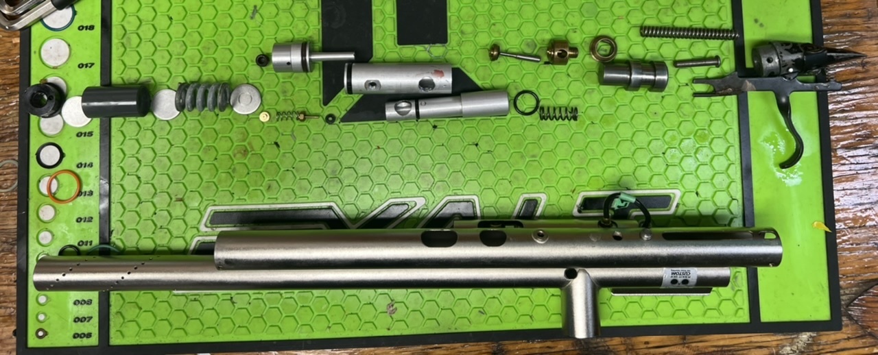

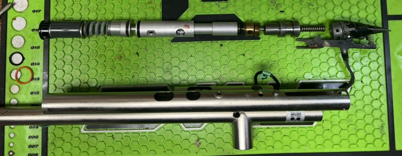

    And that brings us to the full exploded view of the lower tube:
    General overview of parts:
    Full explosion of parts: - this photo is inaccurate as I am missing pieces. Will update once I get these pieces.
    So looks like I’ll be able to start reassembling and hopefully the leak has been fixed. Stay tuned! And now’s the time for any special requests while it’s all in pieces. Ask away!
    Update: spoke too soon! I’m missing a few pieces so this goes back on hold.

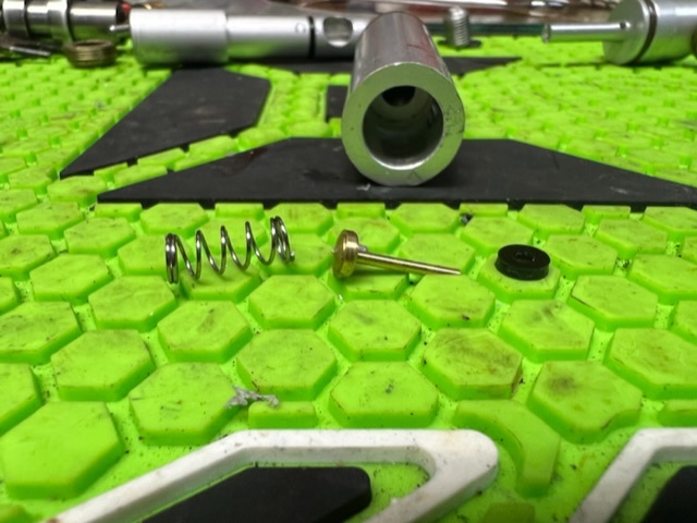

        Now I’ve got what I think are the proper pieces, let’s see about getting this back together.
        Missing parts (contain from a Rock rebuild kit):
        Now I’m taking a big of a guess from looking at photos in other sticky, but I believe black seal, the pin and the spring. My original seal is still in the housing, so just adding the pin and spring:
        And once assemble (inside the body) it will connect like this:
          Jordan commented
          Correct!

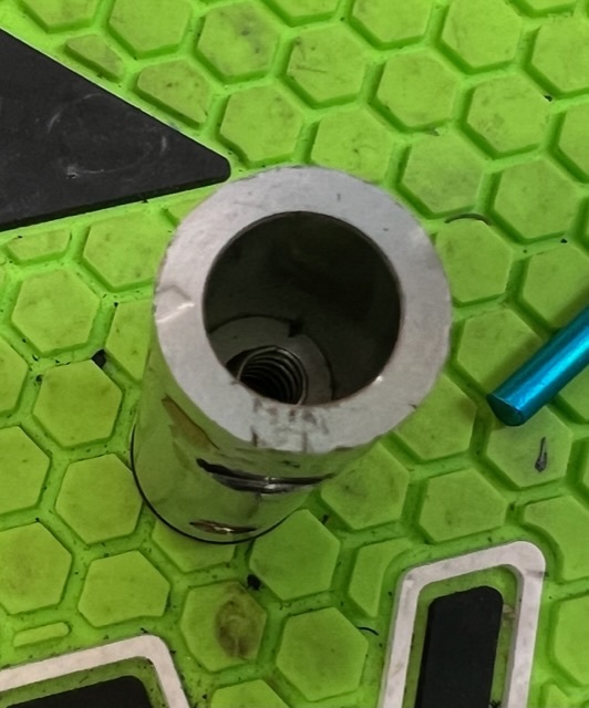

        Got everything back together and aired it up, only to leak out of the front tube…. Merde.
          Cdn_Cuda commented
          And further attempts continue to have the same massive leak. Going to throw the towel in and see if I can get this into the hands of someone who knows what they are doing.
        • 4576
        #21
        Just to wrap up this thread, this marker made its way to a Palmer guru who got it all up and running through some sort of voodoo! He change out some internal pieces and got it working without an issue.

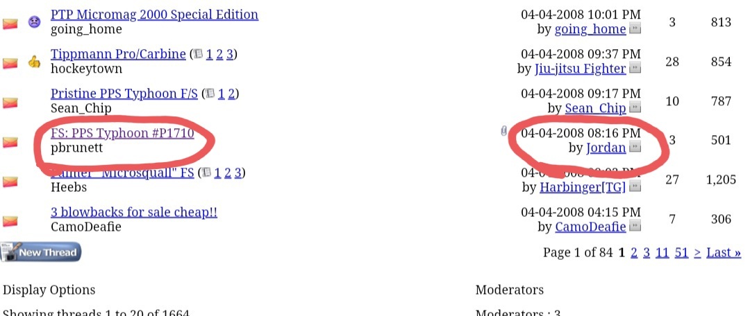

          Took some searching but I found it!
          Bought it 2008 (showed up with mud and twigs in the lower tube - so much for "works perfectly") and sent it to PPS to convert to a Hurricane. It had a full stock originally.
          Traded to Poisonpill for a Blazer(?) and cash a year later, haven't seen it until now.
