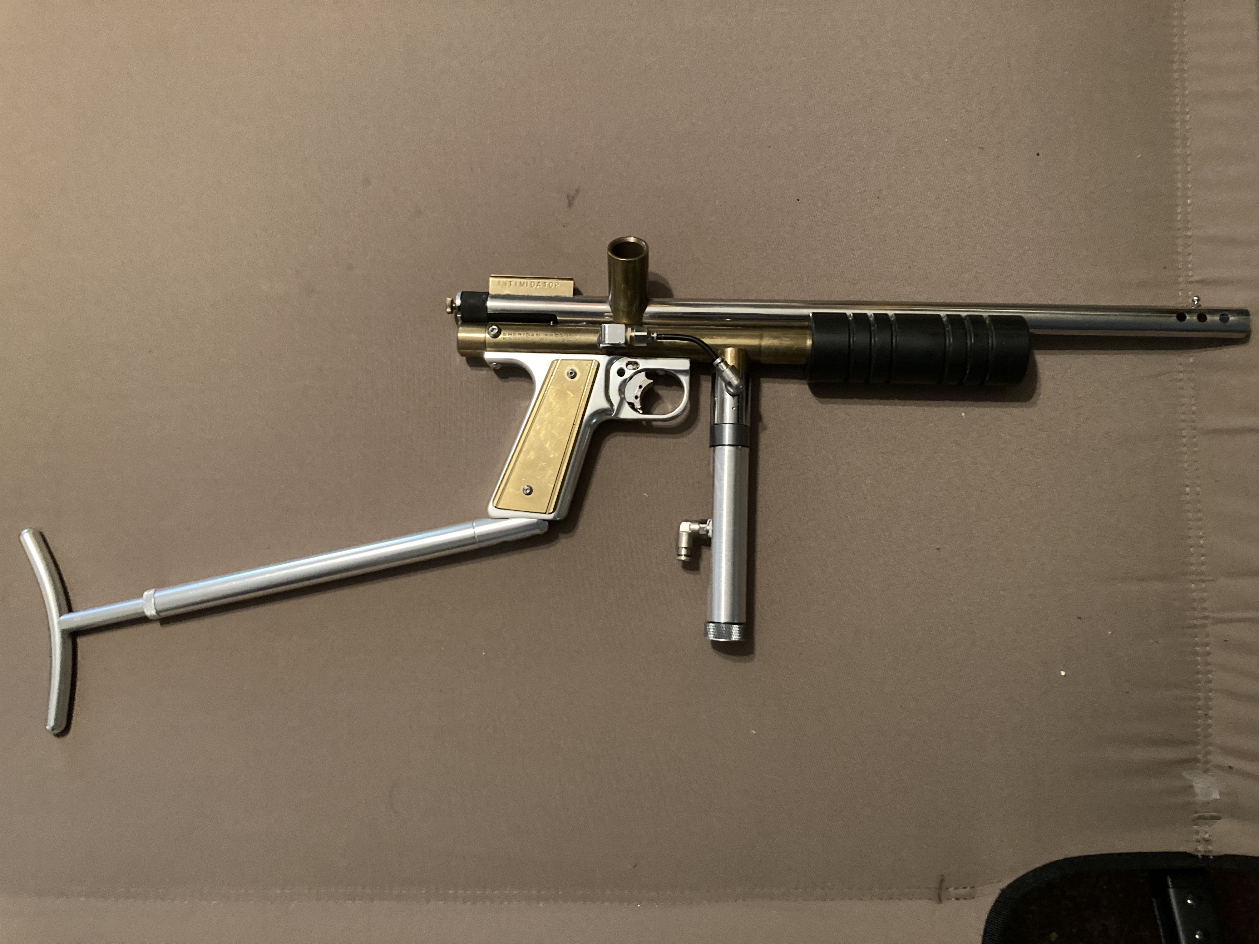

        I've used automag vertical adaptors in the past for those that have side taps. I had to turn part of it down and make a brass collar to match the OD of the bottom tube that fit over part of the VASA.
        5EBF24E3-71B4-4A0D-946B-D92B10BE8227.jpg FFEE3158-EBC9-4049-8A25-675F06EF1BB4.jpg
        • Cal440
          Cal440 commented
          I like how you did those, did you add a threaded insert in the lower tube or just thread a drilled hole to mount the vasa.
        • k_obeastly
          k_obeastly commented
          threaded insert and a set screw threaded the same as the automag VASA
        • Cal440
          Cal440 commented
          Thanks
