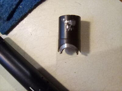

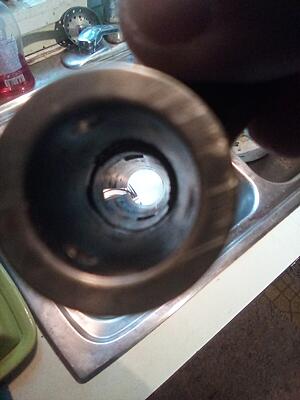

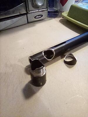

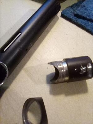

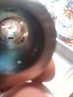

            I found time to tackle this over this past weekend, it was threaded in.
            • Mr. Hick
              2 Tooth hillbilly
              • 515
              any chance you could post up a couple pictures?
