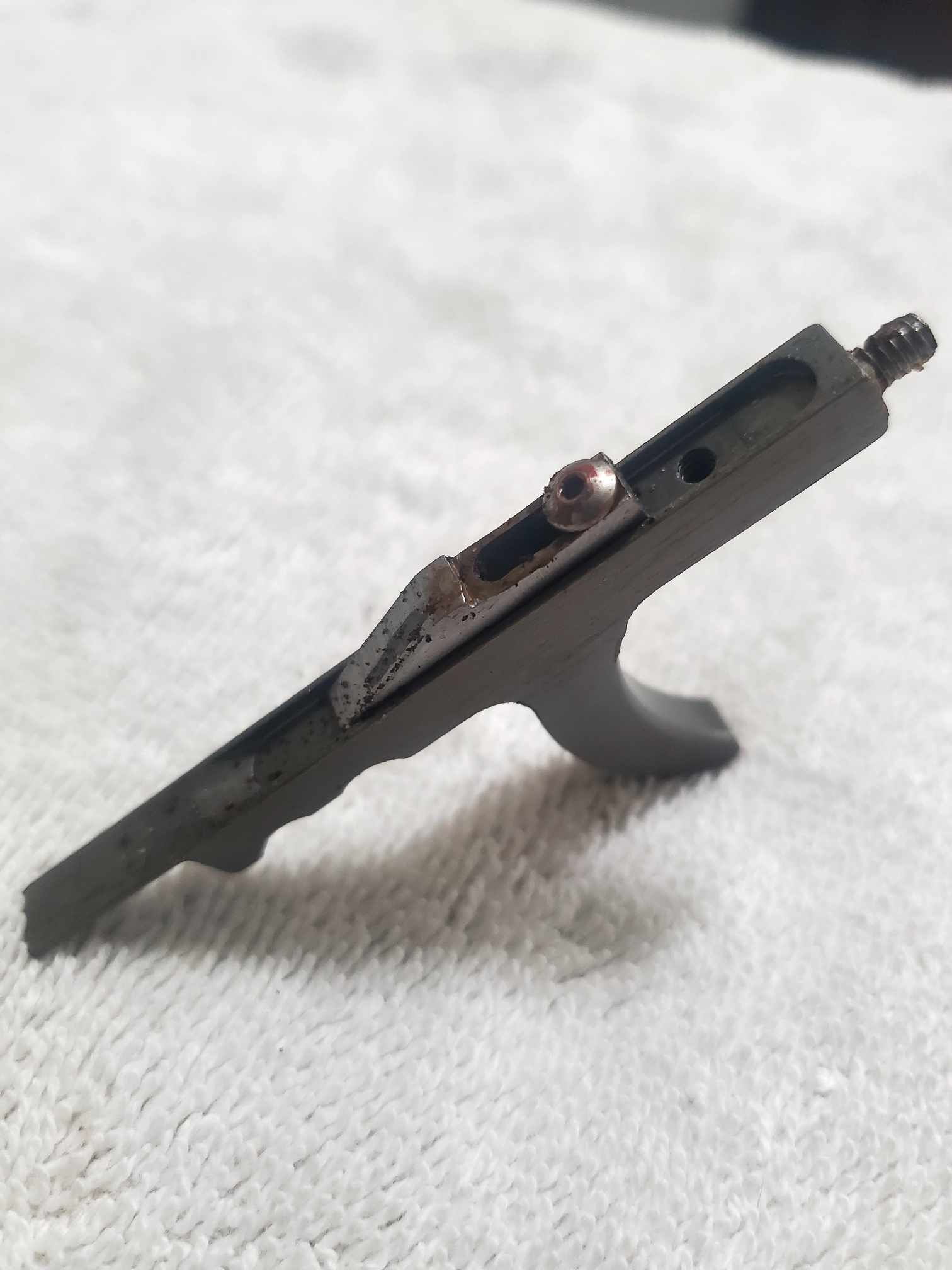

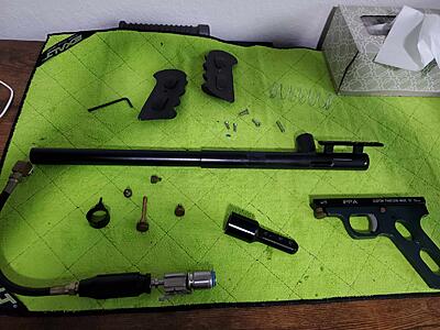

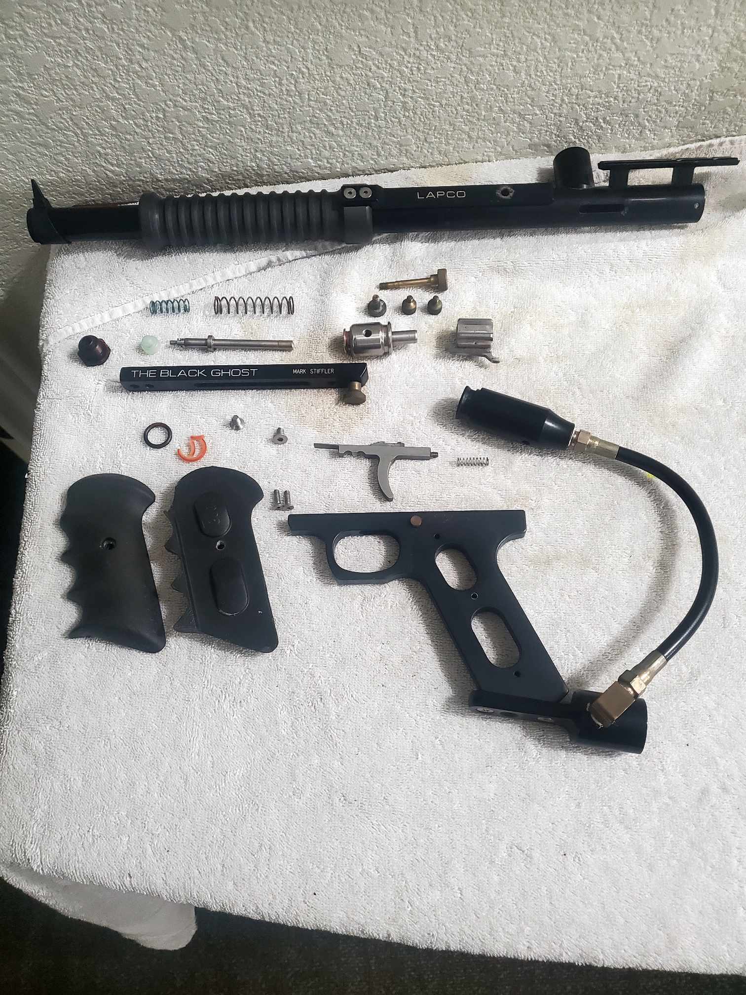

    Ill try this again, Here are some pics of the Black Ghost I inherited from a buddy. This is it disassembled and dirty. I will clean it and massage it as needed to make it awesome. Click image for larger version

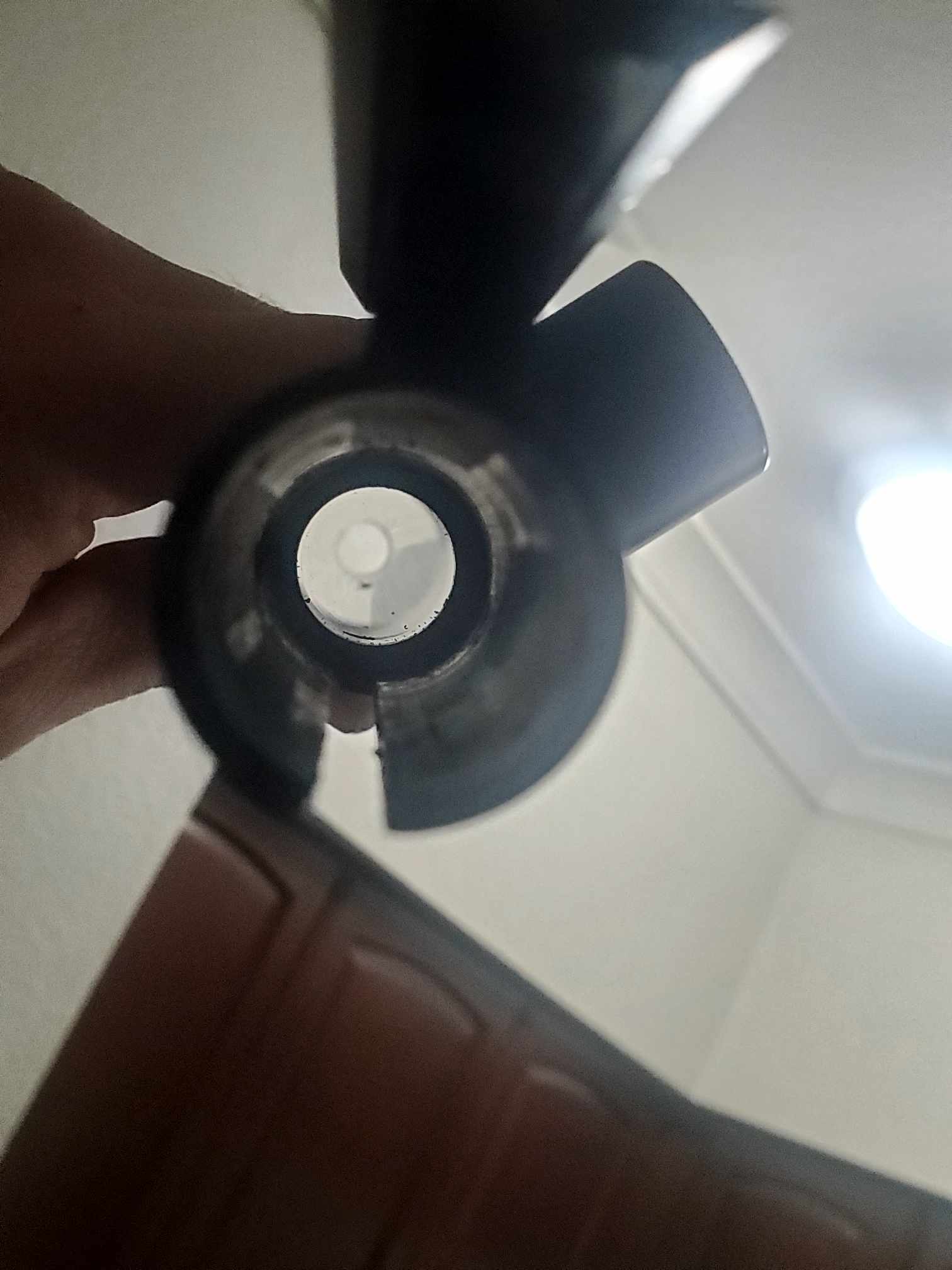

    While a little dirty, the barrel still has a mirror finish. All of the parts are in great shape. They all just have a bit of old paint or a little crud on them that has been there for some 20 years now.

        Thanks for the images, this looks like it is in super nice shape. With just a little of work you could have it up and playing pretty quickly. I expect the barrel is around 0.692 ID (my two Ghosts are 0.691 and 0.693). Finger nail detents work but you will have build it up some for current paint. The large bore kills efficiency so running on CO2 cartridges is not overly practical. I love the Wintec trigger frame and slide trigger, very adjustable and feel great.
        Is there a return spring under the pump handle? Not seeing the typical wear from use with a return spring on the barrel.

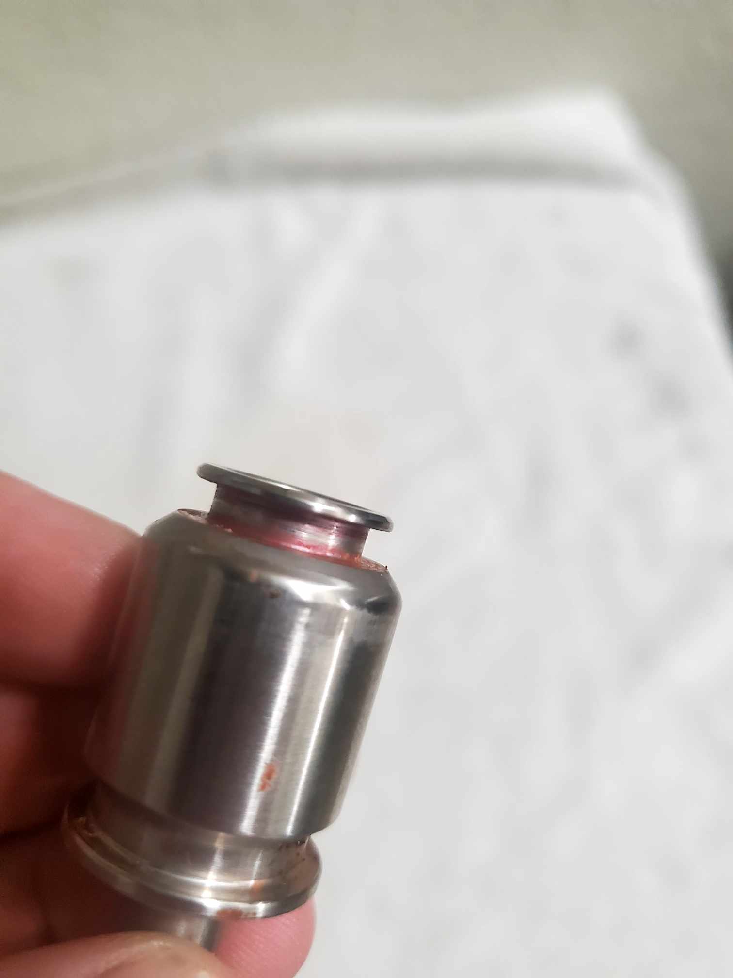

          Yeah there is a return spring. I dont have the proper allen key here at the hotel I am at to remove the front sight to get the pump handle off at the moment. Let me know if yall want any pics in particular. Any chance yall have the oring callouts for the 2 it needs to replace?

            Anyone know the Oring sizes for the valve assy?

              -112

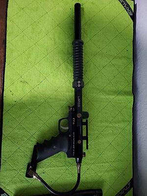

            Finally got the Black Ghost reassembled and ready to rock. Cleaned her up real good. For sitting for 20 years its in great shape.

                I left the front sight off, I didnt want it to get broke. This will see use at ION this year.

                  Never broke one but lose them, YUP. Good call and have fun playing with it it is a nice looking Ghost.
