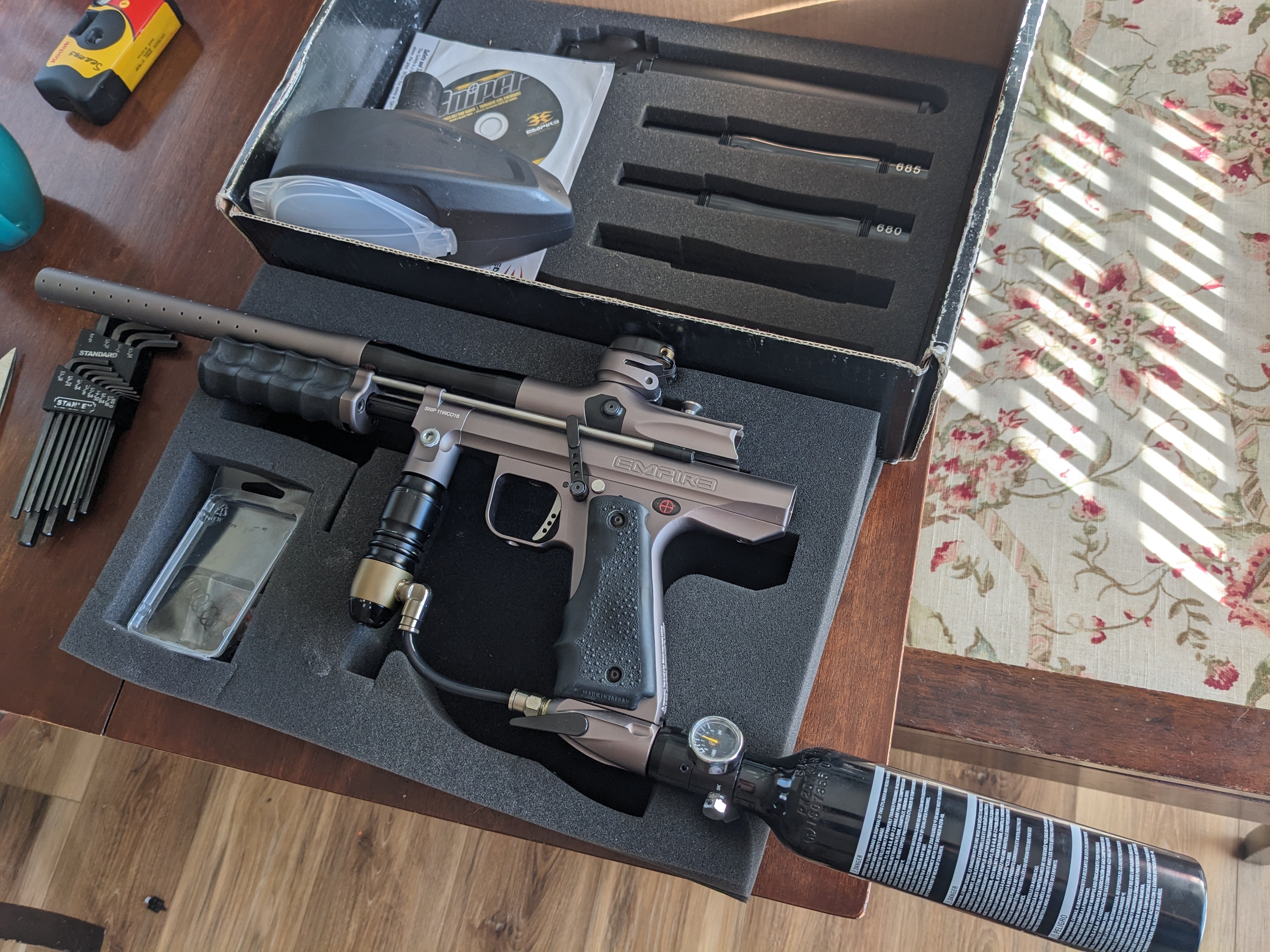

    Good morning. I picked this up yesterday, played with it right after a good cleanup and lube. This one is broken in nicely, much smoother shooter than the one I had 10 years ago.
    I prefer to use the stock class feed with a 13ci tank. Super light and low profile. I was playing with all semi shooters, though they were pretty green. But loading was incredibly difficult, with the spring, the plug twist, and getting the tubes. Is that just part of it? The two added steps with this stock class tube make it hard, but I love that it spring feeds. Just much harder than my old phantoms with the stock tube.
    All in all, the .675 back with mediocre paint was great, and though it is stock, the stroke was smooth, though not super light.
    It is light as heck with the stock tube and 13ci tank. Loved it.
