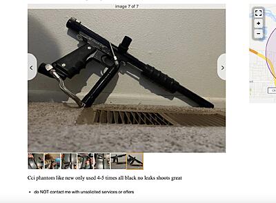

    Looking for some up-to-date advice on what to look out for when buying used Phantoms. Using the attached specimen as an example. I sent the seller a message and haven't heard back yet.
    All the photos make it look pretty clean, seller's asking $225. The only downside I'm seeing is I would want to be able to convert it over to tubes and 12 grams, and I would want a barrel I could put an insert in given that paintballs have sized down. What do you all think? Worth the money plus the drive? What're some things I should watch out for?

    I would keep looking. I think you can find something that ticks all your boxes here on MCB with nice anno and the parts you want. Just be careful, if you buy an acid wash, open class Phantom, and it doesn't come with the stock class body, you'll have a hard time finding a match (at least from my experience).

    You could just get the 2.0 breech, UC kit, Freak barrel new from Extreme Velocity and throw em on an older used Phantom which is the way to go I think. I've heard a lot of issues with that hoseless 2.0 trigger frame and you can't remove either ASA from it.

    I suggest finding a CCI branded one like you posted with everything you want. However that’s not a bad deal for what you are getting. You could easily drop a stock class Detent body you would need to buy a feed, remove that fore grip and replace it with a bucket. Gloss black match’s easy as well get it built how you want it then go from there. Or you could probably find exactly what you want and spend a lil more.
    I do suggest sticking with CCI valve, internals, cup seals, and springs. Until EV gets their crap together or we get our aftermarket cup seals worked out. There feeds and body’s pump kits and freak bore barrels are good. Just stay away from there valve bodies, internals, and cup seals.
