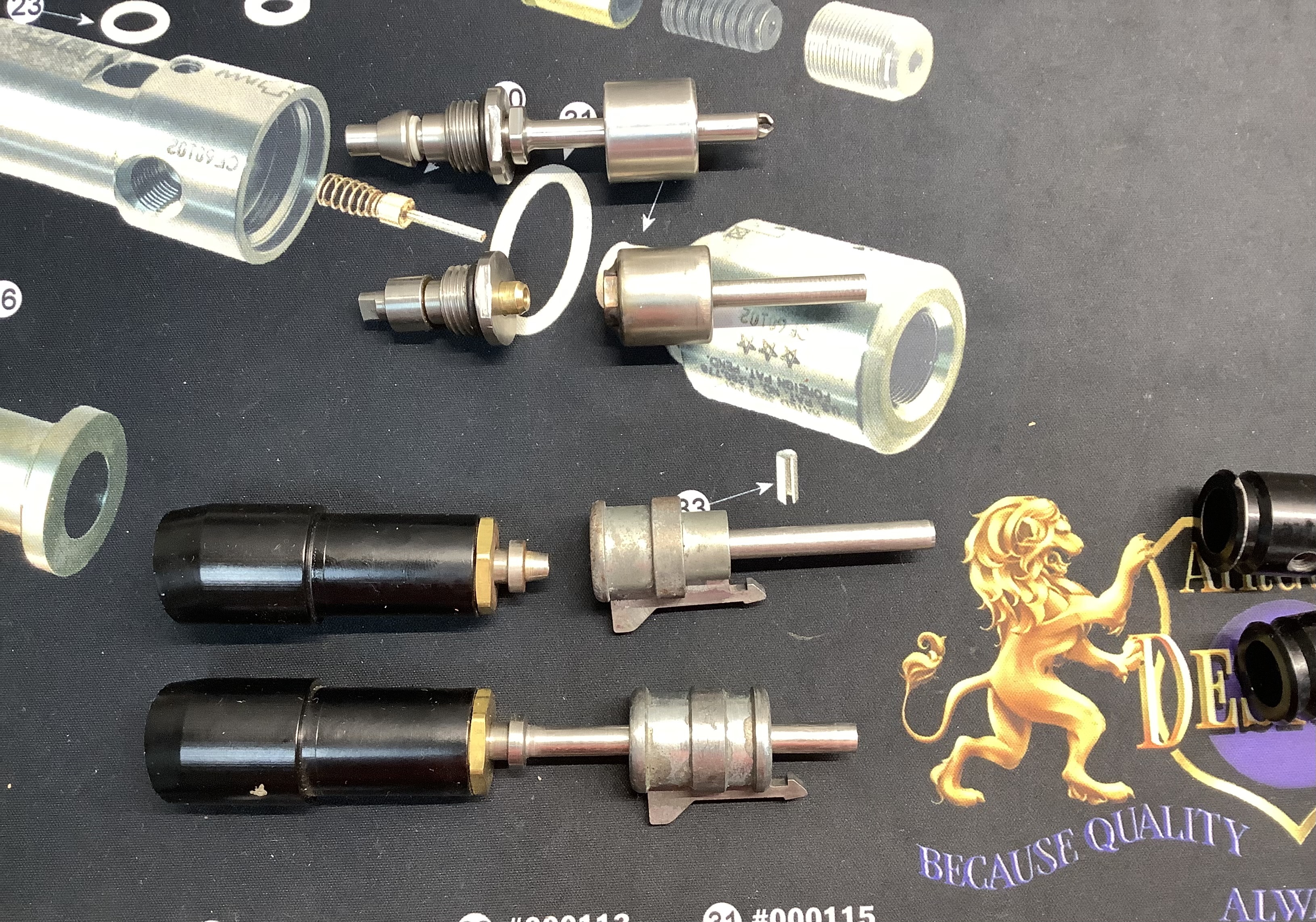

    I just picked up another Traccer and it came with the powertube attached to the bolt and just a short stub sticking out of the valve. I also encountered this with the old Armson pumps I bought a couple years ago.
    From my understanding, at least with the Armson ones, the version with the powertube and bolt connected is the older more out of date version and the powertube on the valve like we are used to seeing is the more up to date version.
    Are there any other guns that did this?

    The top one is the more modern trracer, only early models had a standard Nelson style power tube. Also your newer model should have the spring detent under the breech.

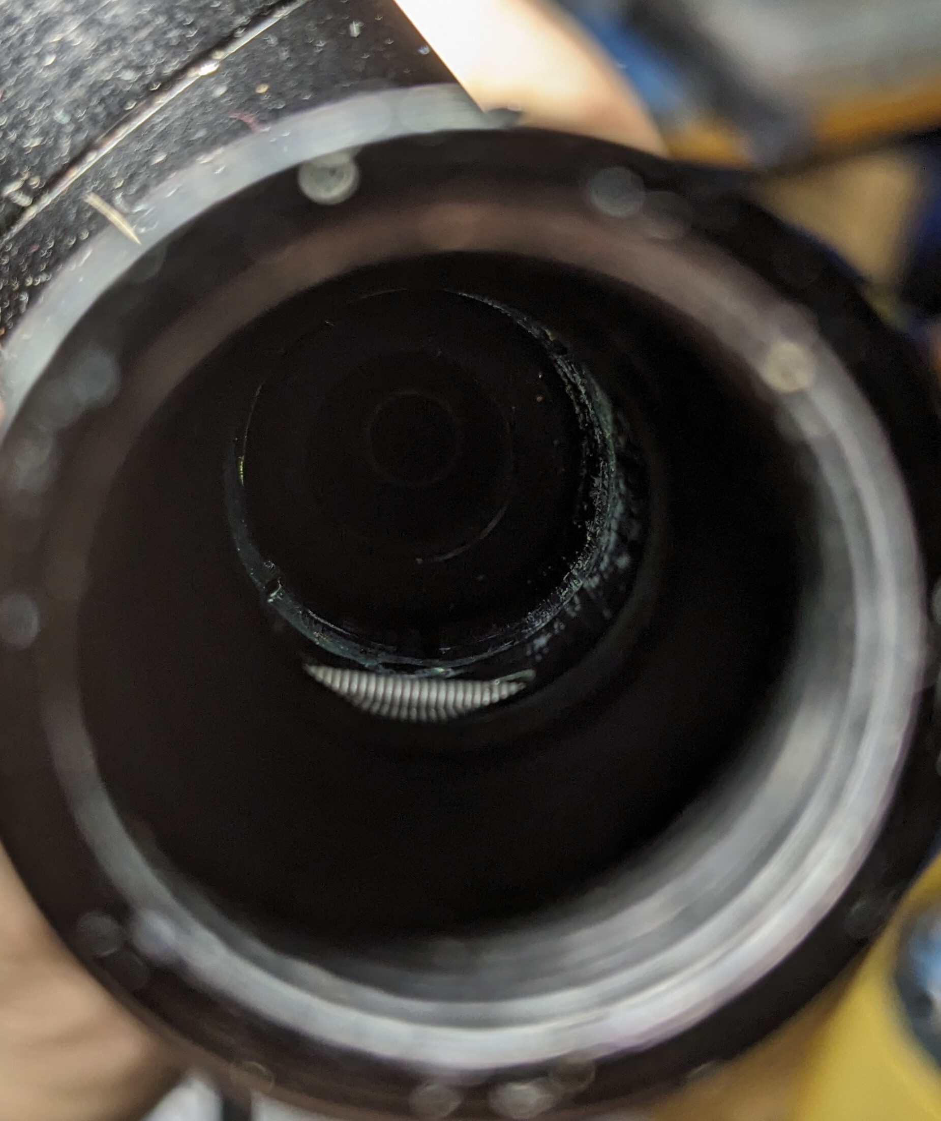

    this is the detent Chappy is talking about.
    (Sorry for the grime 🤢, grabbed the first tracer in the project pile ...)
    From the feed side:

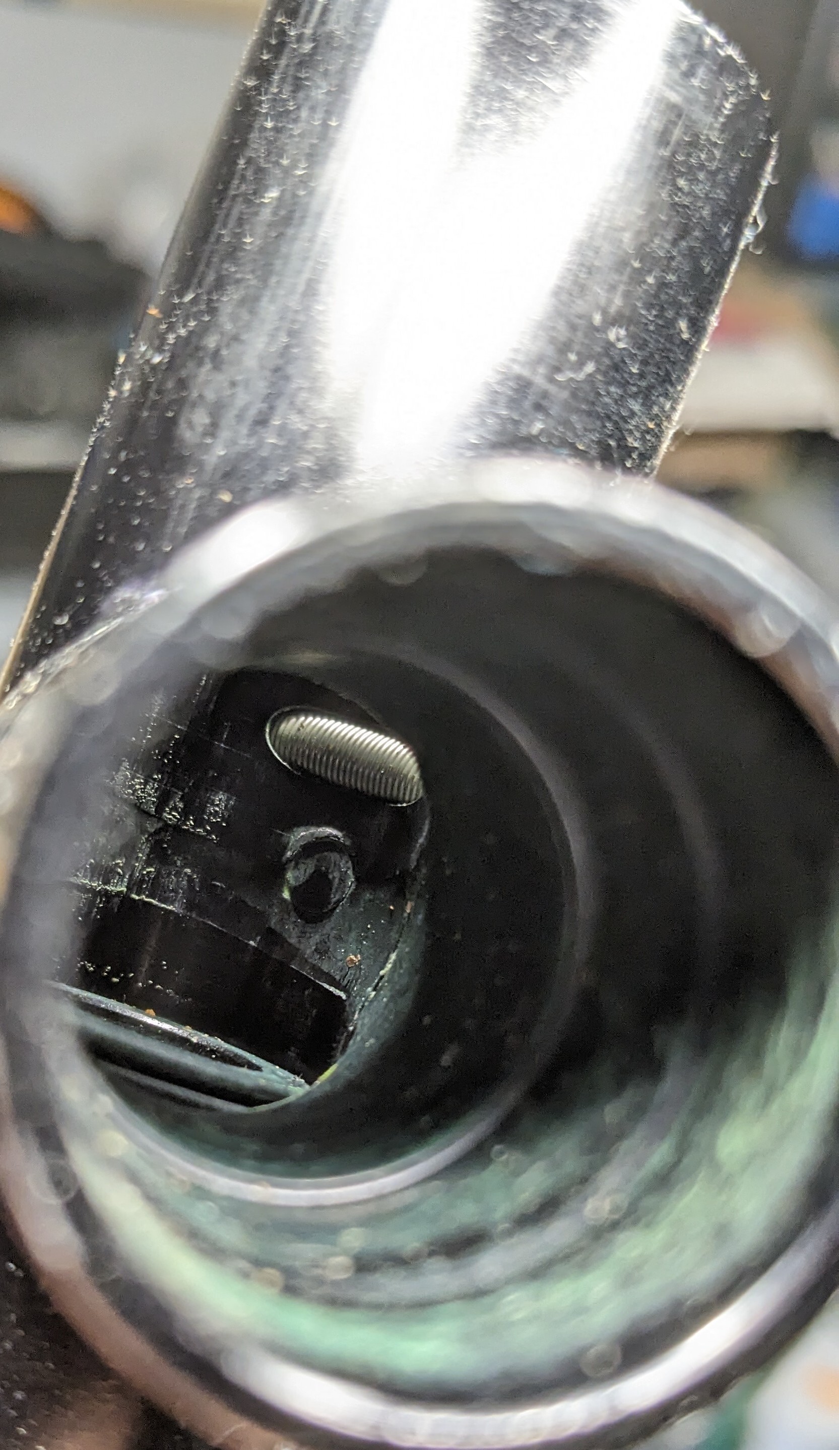

    From the breach:

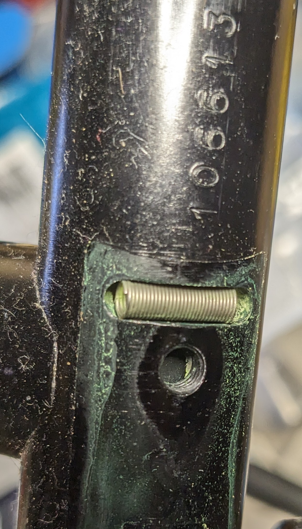

    And from the underside (frame removed):
