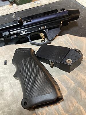

    Any idea if the grip handle is removable? I’ve been curious about replacing the m16 style grip with a 45 grip. I’ve looked at it every which way and it seems the grip handle cannot be removed from the rest of the trigger assembly.

    That should be removable. Try to knock out that tension C pin on the bottom/front of the grip frame and slide the ASA assembly toward the back of the gun. Once that's done you should be able to access the allen key on the grip tang by going through the center of the grip.

      Myrkul was right, thank you!

        Wow, after looking how that came out that was not at all how I thought it went together, but I'm glad just knocking out that front pin worked! 😂

        Yeah, the stud rests on the c clip keeping the piece in place.
