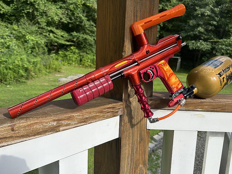

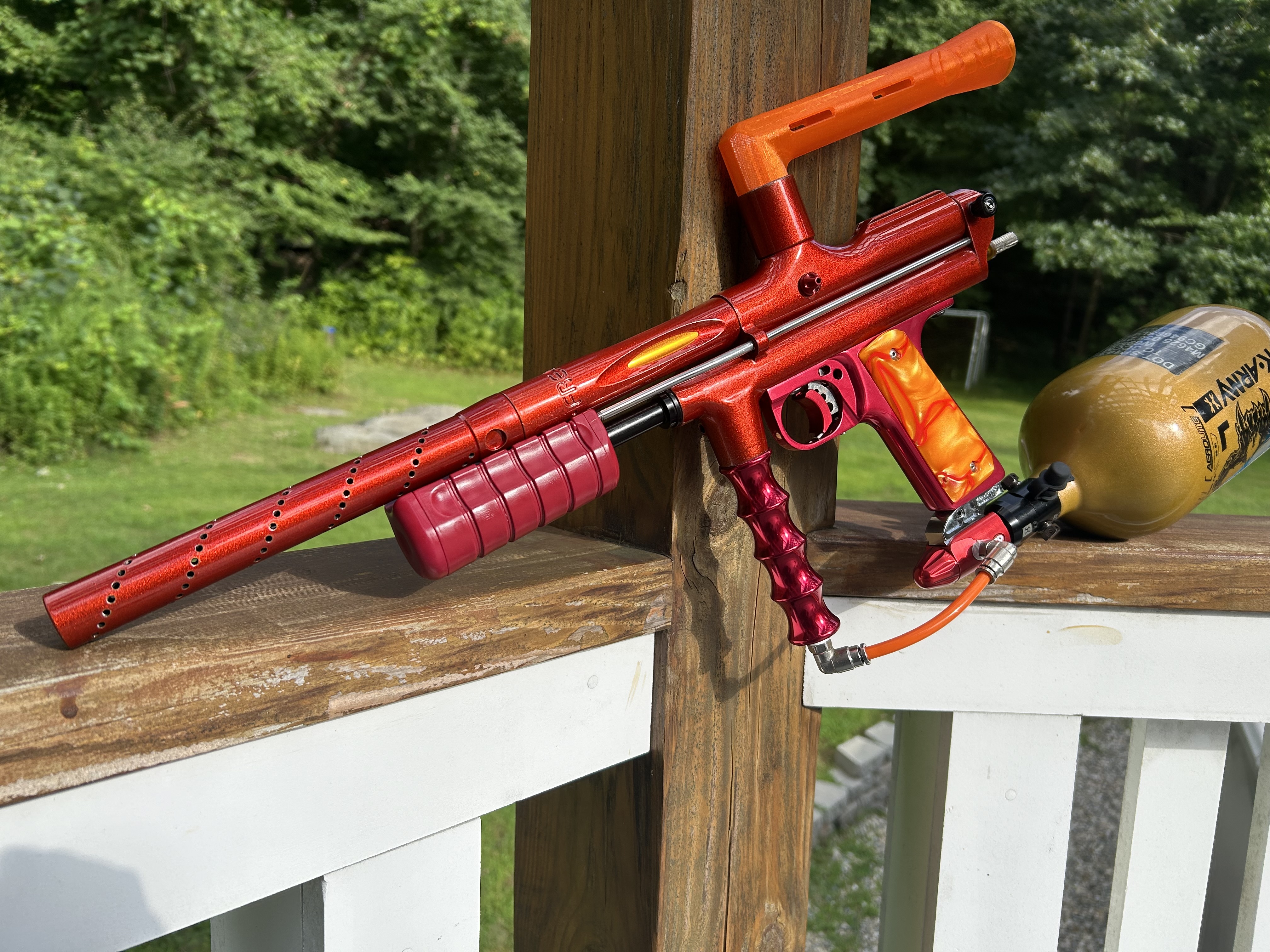

      I absolutely love mine. It’s the basic Trilogy that I rebuilt and had powder coated. Slider frame is in my opinion a huge upgrade with a Slice kit. No Reg needed on this as they didn’t come with one so I roll with a gas through. Obviously I’m running a freak insert All American as well. Great shooter and absolutely one of my favorites.

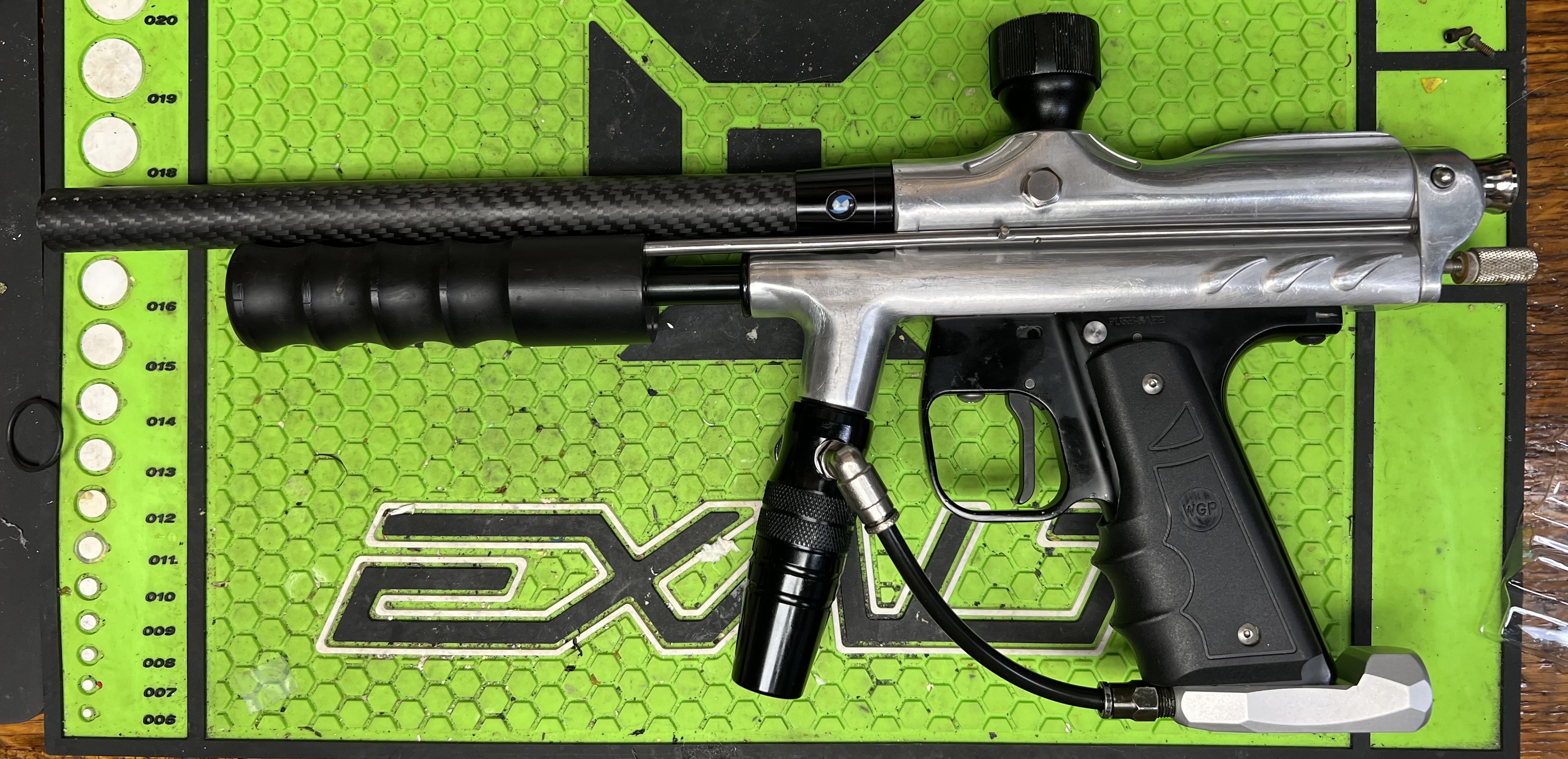

        Just threw this one together as a low budget build. It shoots quite nicely, but trilogy frame is a little awkward and I find slide frames nicer. I did intend on putting a Laz valve in this for a sleeper build, but can’t get one in Canada.
