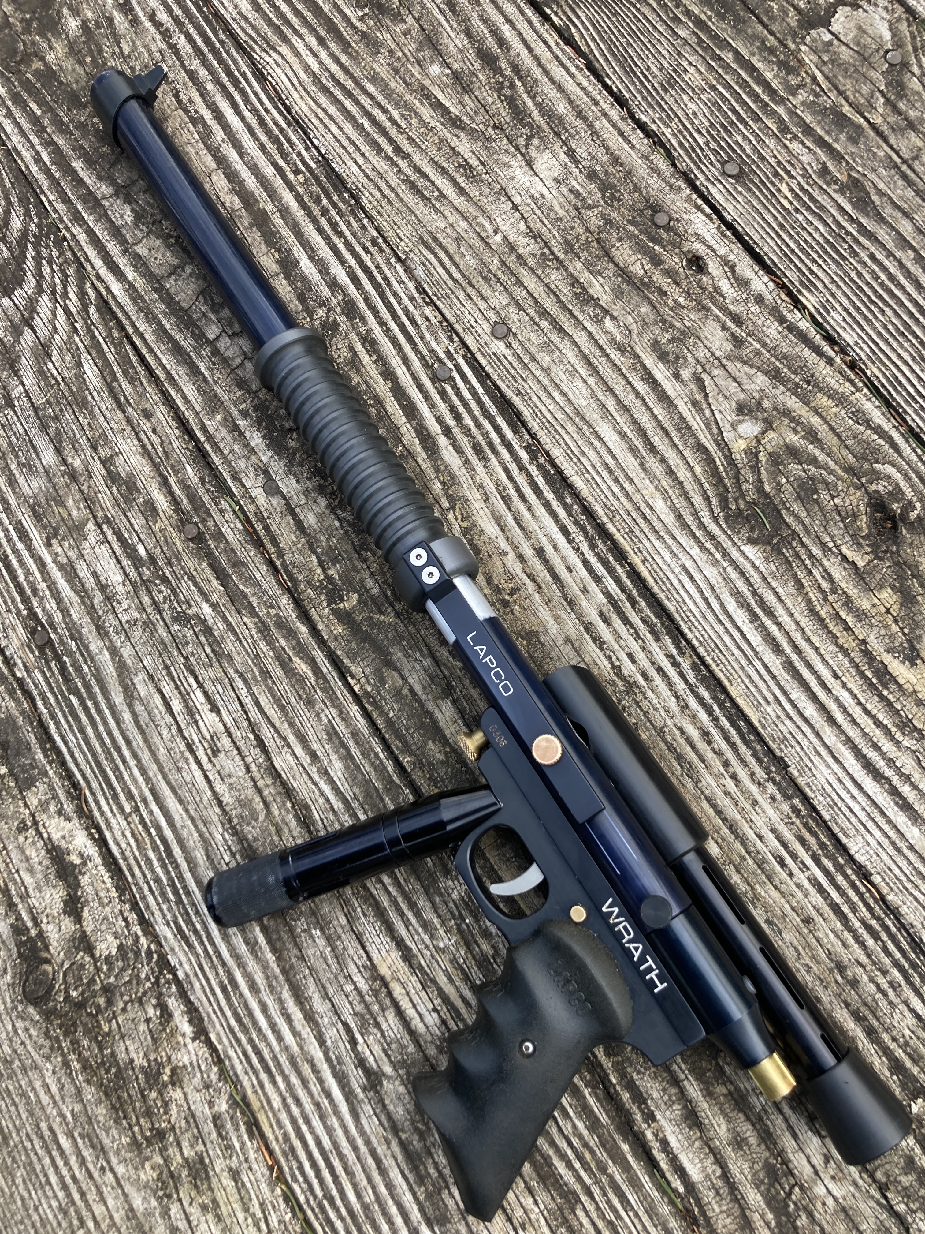

    Traded ThatBobbyjoe a phantom for this awesome old Lapco Wrath

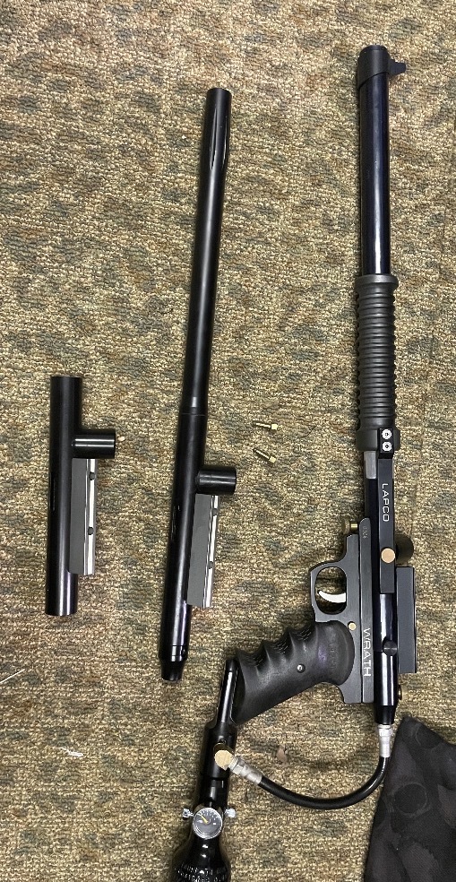

    Mine came with two extra bodies, both bore drop and supposed to be cocker threaded, although only one really works.
    It airs up and shoots with no leaks as is with about 22 shots to a cart. Ive got some powertubes and springs to fool with to get some better numbers there.

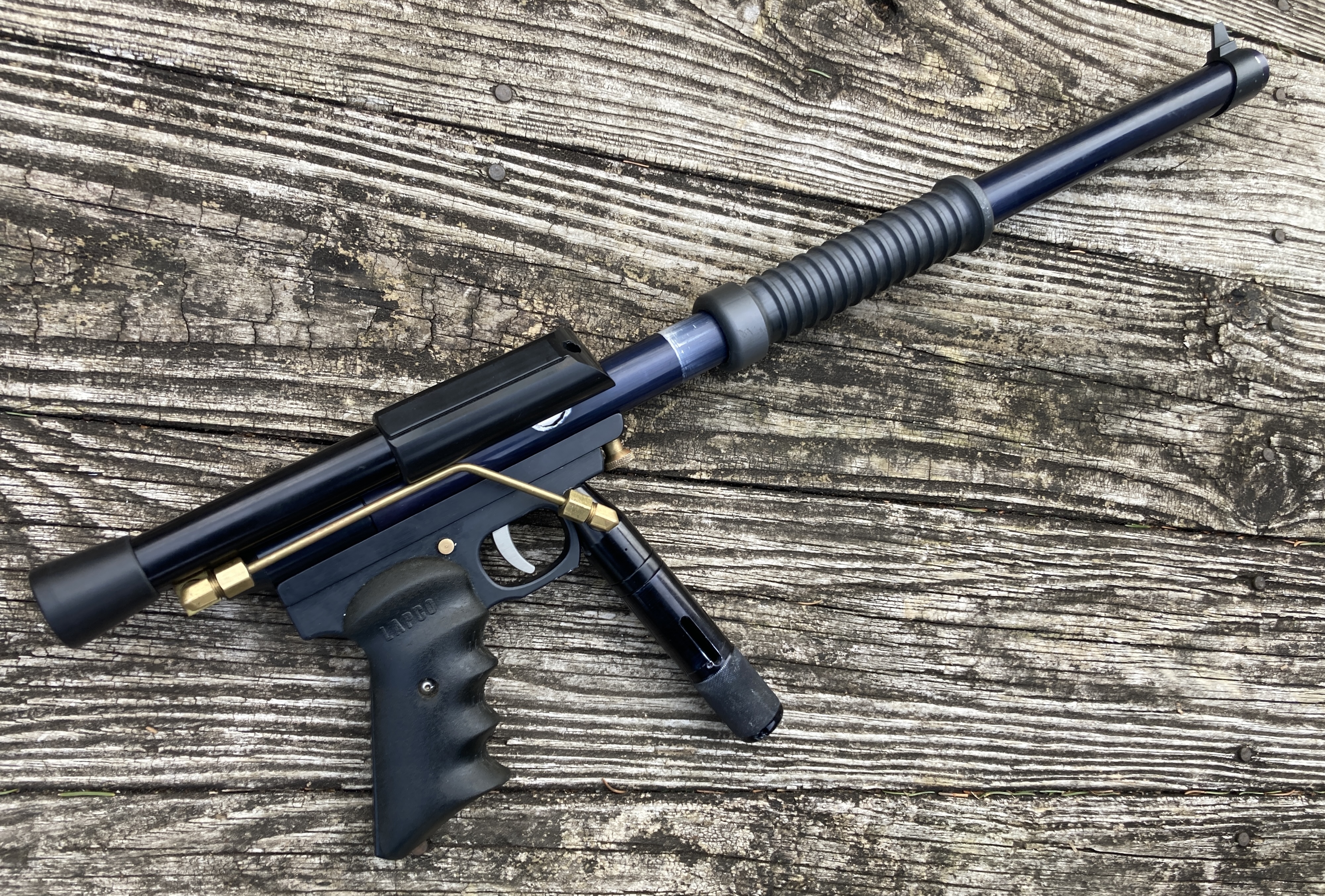

    While I definitely enjoyed The Wrath for what it was when it came to me, I can never leave well enough alone. I fell in love with the frame and trigger ergonomics and decided this thing would get some modern touches.
    The feedneck unscrewed from the body by hand and i drilled and tapped for a cci stock class feed.
    the brass hardline and vasa is also cci, drilled and tapped through the top with a screw attaching through the Wrath frame.
    I dig the angled foward vasa look on this one, reminds me of the forward angled vasa ive got on one of my snipers, also a lapco part.
    This whole build is similar to The Grey Ghost 2008 vsc Lapco put out a while ago, though those are center feed and vertical vasa. and much more expensive than i "paid". nice that on mine, the front sight is still functional.
    Future plans are to send the unibody out to be modified for a removable, insert bored barrel, maybe some porting. ill do some efficiency and fps tuning once its back from that.
    Very stoked on this thing. Ive hadled many nelsons and the frame, grips and trigger are by far the comfiest ive ever held. Ive never seen another Wrath (and before this one didnt even know about them) but ive wanted a Lapco since the first time i ever shot a pump, a Grey Ghost. ill have it with me at any stock class games i go to for now on. So if you see me and want to check out The Wrath, like all my gear, feel free to take it out for a round or two and let me know what you think!

              Dam Slimbo that looks super cool! I love the angle on the bucket ASA.
              • $L!mBo
                $L!mBo commented
                thanks brother! i like it too, a happy accident that the cci vasas be like dat but mostly me being not willing to flatten out the inside of the trigger guard for the normal, phantom style attachment. but as a bonus, way faster to remove
                The brass hard line is a nice touch too. Well done!

              Nice, that VASA looks oem+ and really rounds out the look for the marker.
              • $L!mBo
                $L!mBo commented
                i agree! the taper of the phantom vasa almost matches the back of the valve, the angle is almost the mirror of the frame and is almost perfect 90° to the bottom of the frame
