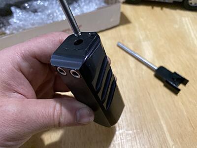

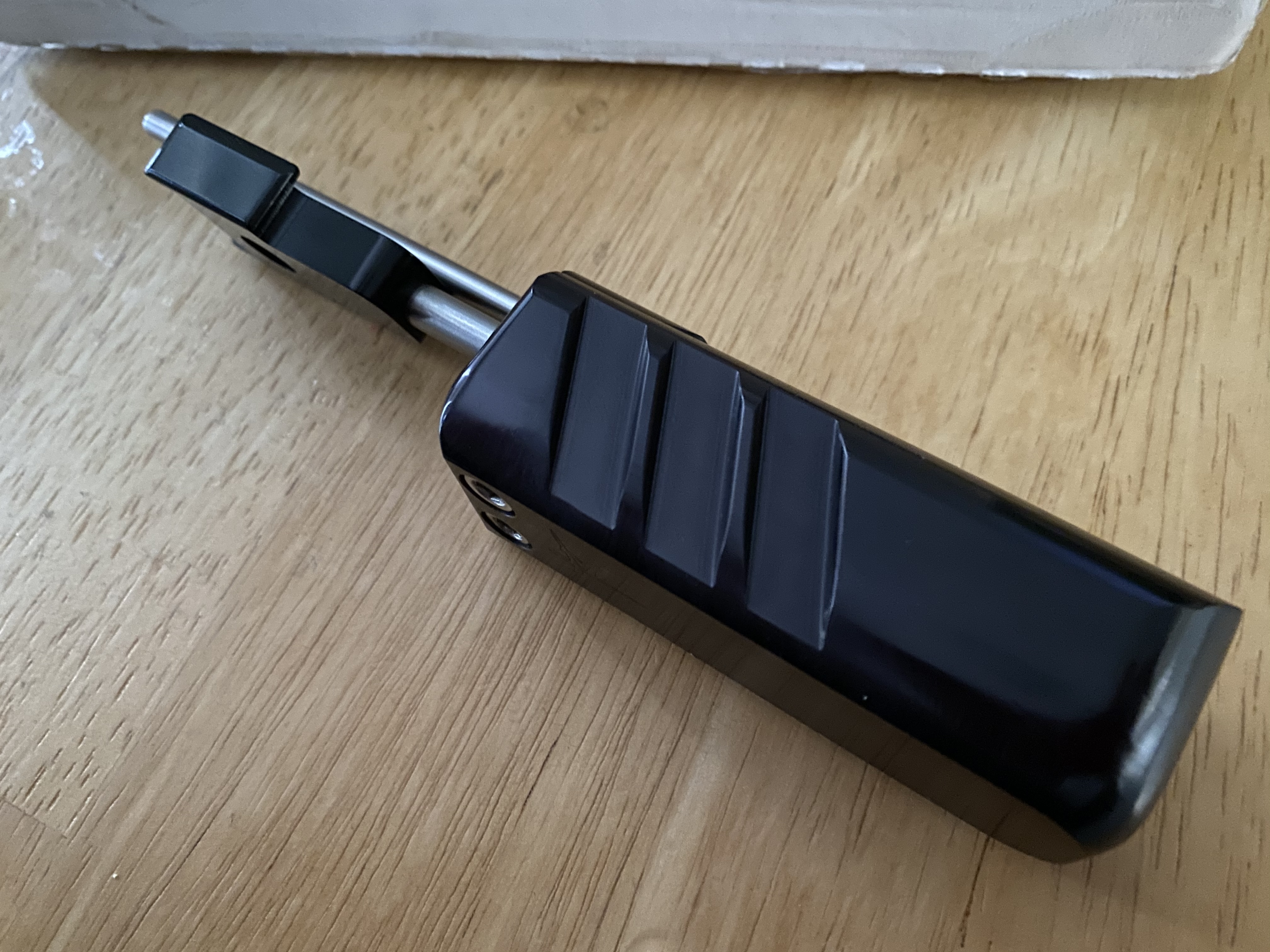

    So I got my hands on an original RTR Gargoyle Under Cocking kit and it came in today. I didn’t even know these existed until recently there is not much info on them. It’s got dual guide rods just like the the standard Gargoyle handle. Pump mounting plate it’s a bit thicker then the CCI one, but similar in design (it keys into the frame). Handle is sold aluminum it’s got some weight to it. It feels really smooth and will be nice trying out different barrels on my gargoyle. Might even try it on my Phantom with the slide frame I snagged from RTR on the last drop. Can’t wait to try this thing out. 89646B2A-CEA0-406B-BB70-E6C88D339A23.jpeg

    The handle is removable from the "key" that all the pump and guide rods go into. This was so that if you wanted you could make your own custom pump handle for it.

      Yes it’s a cool design.

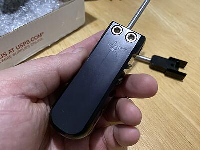

        Logo engraved on the bottom.

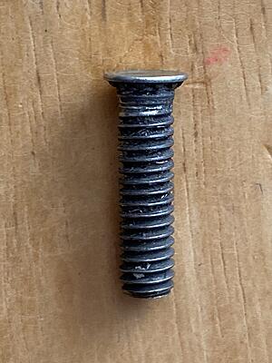

                  It needs a longer front mount Stud on mine at least. Needs to be about a 1/4” longer. I think even on a Phantom you will need a longer screw. The mount plate is thick. May attempt a Phargoyle after I play around with it on the Gargoyle.

                So I’m going to need one of these that are about 1/4” longer then the stock one to mount this. I’m going to check McMasterCar see if I can source one. Before I turn down a bugle head. Then the stock speed wheel will spin right on.
                EDIT: PEM Stud it’s called for anyone is sourcing replacement parts.

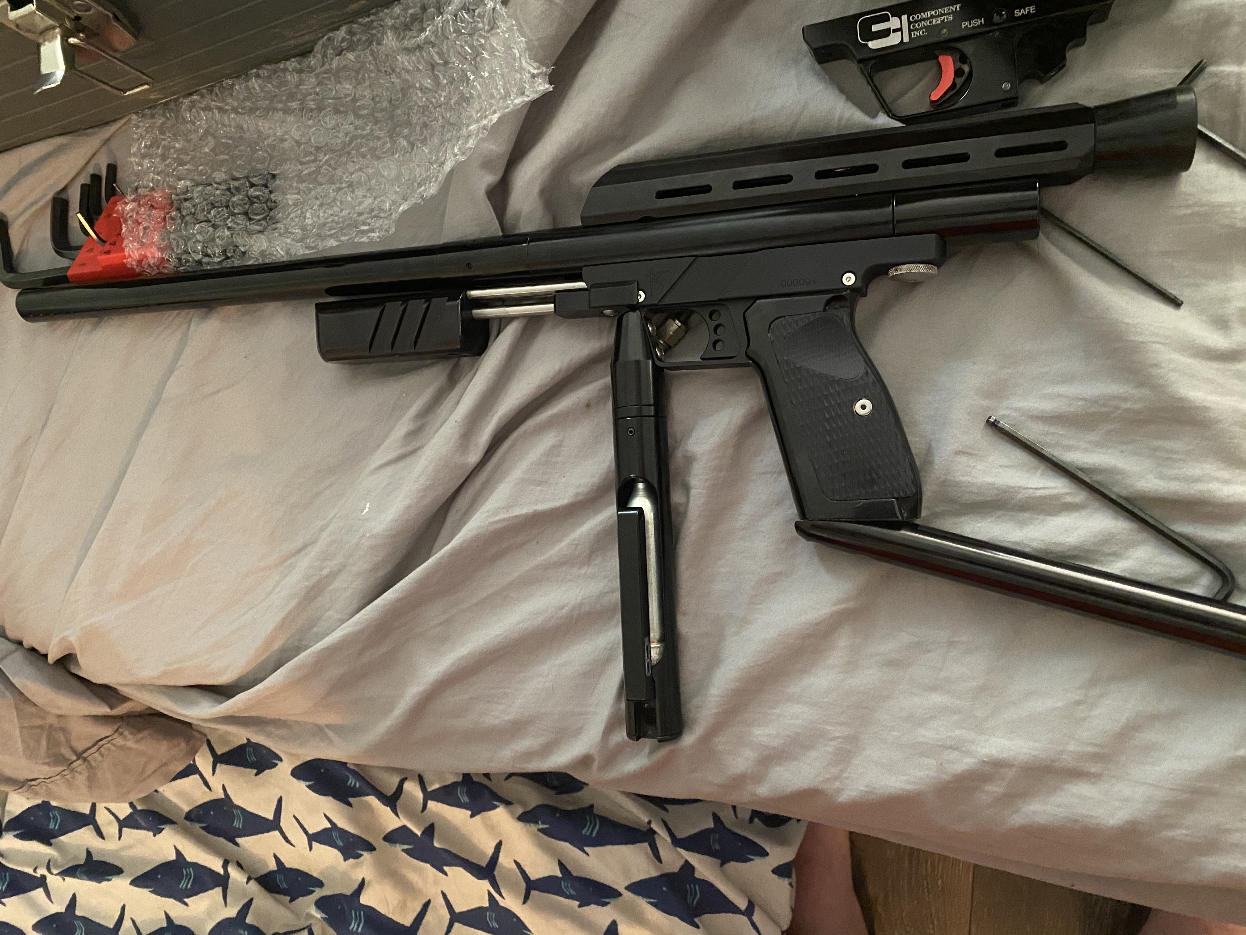

                Ok so strike two I’m going to need a lower profile nut of some sort to clear the Vert ASA the stock one is a bit to fat. Longer stud will work and provides enough clearance but the speed wheel is a lil to chunky (like me) to fit. Going to Look tonight to see if I can find something on mc master carr. I need a thinner 8-32 nut preferably one of the toolless type.
                edit: I found a nice stainless one but I will have to turn it down on my lathe to work. Im thinking I can match it to the dimensions of the step in the pump plate if I want to get super fancy. I’m going to keep looking and see if I can find something off the shelf that will work tho.
                  • 6384
                  Found one I just need to shorten up the collar. Much easier to modify. I got a few just in case I mess one up or lose one. Stay tuned... lol getting there.

                        Stilgar has the mounting bracket Nish. The issue is how the Gargoyle mounts from the top down and it uses a nut to hold the front half of the body. The Longer front mount screw that I have creates clearance issues on that mounting nut at the area ware the VSC top half bolts to the trigger frame. I ended up putting it on my Garg framed Phantom because the phantom mounts from the bottom up. If we were to source a thinner mounting nut it would work fine. Im assuming the original kit came this way and the nut was lost at some point.
                        It won’t mount to a dual rod plate the design is completely different. The Gargoyle dual rods are above and are guided and keyed into the gargoyle frame. The CCI plate has them below and they slide into the handle. The Gargoyle plate only had one larger guide rod similar to the older style CCI under cocking kits.
