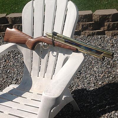

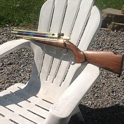

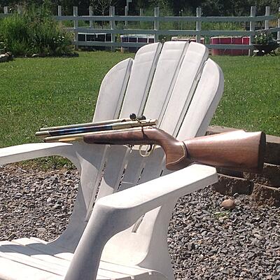

        And Done....
        added a newly powdercoated end plug and a feed plug in delrin....
        also powdercoated the trigger assembly and co/2 lever in a gloss black, gold vein combo...
        made a trigger guard from a section of old barrel tube...
        was shooting 425+ when I first fired her up so I changed the main spring to a much softer one...
        cocks way easier and is shooting around 280 ish right now...
        And she is super light to boot.... with a nice ergonomic grip that use can use both left handed and right handed...
        The stock itself came out wonderful with super nice grain.....

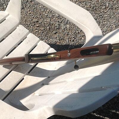

        posted a a picture of the cutout for the drop out slot underside of marker.....
        i made this one so you you have to load it back end first...i am hoping it saves wear on the piercing pin collar.
        pictures.....
