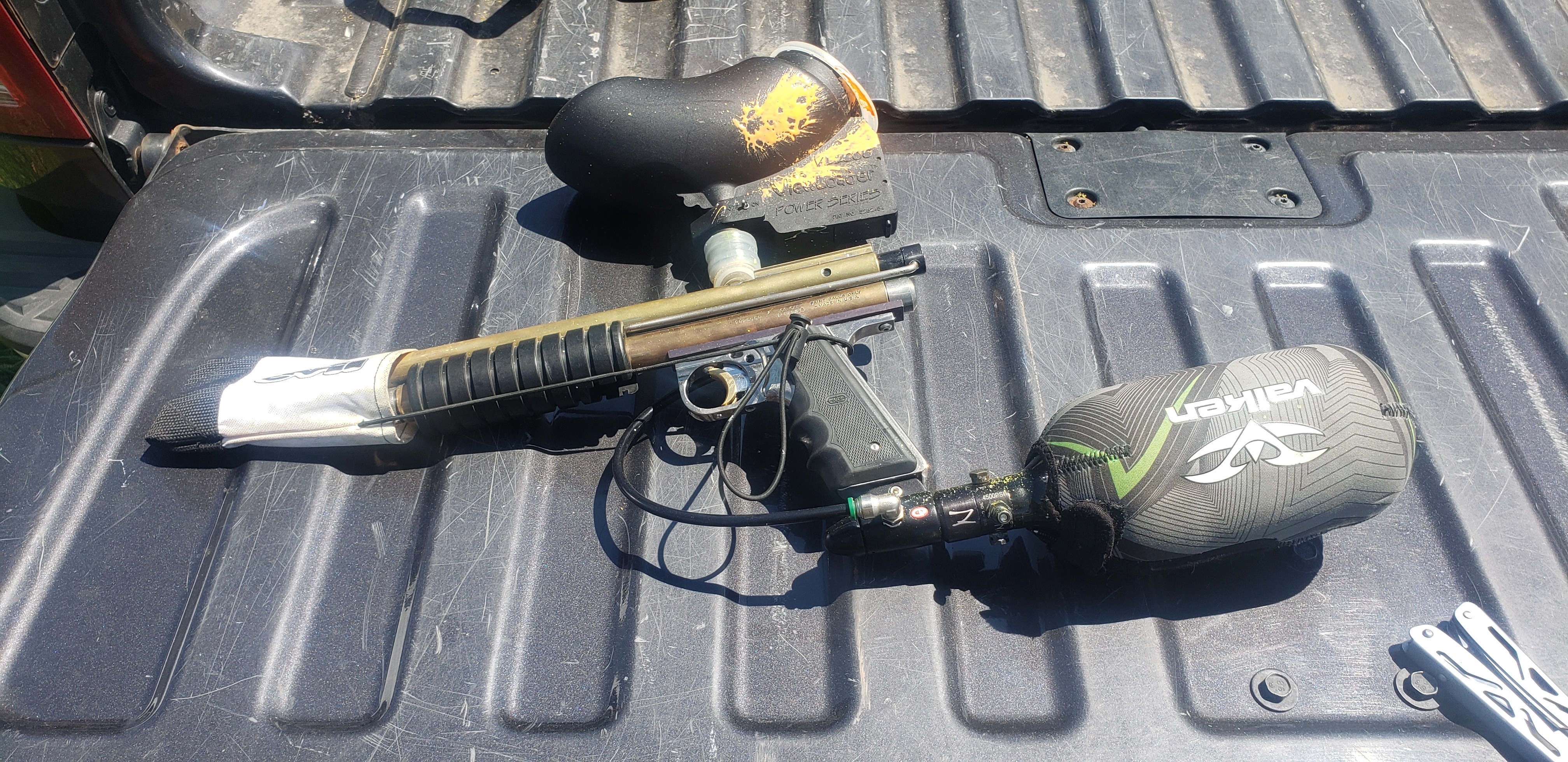

    Here if a mac 1 annialilator I recently acquired here on the forum. I added the cocker frame and I am honestly swoon. I used at a big game yesterday. It may have been the 94* weather making paint shoot well, but this thing shot better than all of my other sheridans I own.

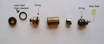

      You will need a valve tool there is a thread cert soldered into the lower tube currently capturing the valve body.
      Here is a picture of an early sheridan valve laid out. The far left nut is what is holding it in there. A valve tool has a squareish tip that is also hollow so if can drop around the valve and catch the edges of that nut.
      The next brass bit to the right is the part youd want to open up.
      Also IF you see a pierce pin (you may have a CA valve already) you can take the pin off to add to volume and flow. But if you do this you are a constant air only pistol, but it seems lile your end goal. On the other hand you can leave the pierce pin and should be able to make it work with the other valve work.
