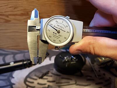

      BrickHaus commented
      I happened to find a safety ball in q baggie and have my calipers. It measures .077"
      Spring I would imagine has a similar od.
    • evilfishsticks
      evilfishsticks commented
      Some quick conversion showed that 2mm is .078". I'm going to grab some 2mm bearings and try them out.

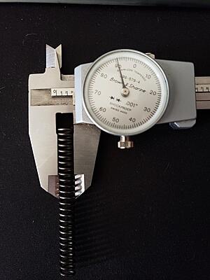

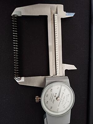

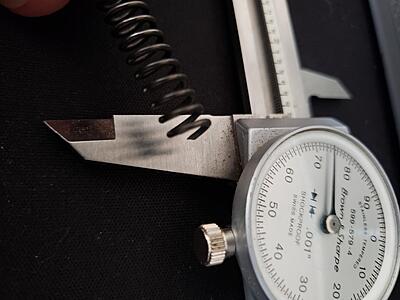

        • 3402
        #21
        Well. The spring I have seems to be cut. I intend on putting it back in my kp3 so Ill leave it as it works in that shooter.
        It measures 2.675" long, and .290" OD. Its heavy.
        I don't know exactly how to measure a spring poundage, but here is a start.
