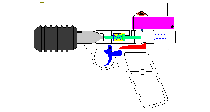

    Af​​​​​ter the hammer hits the cup seal, why doesn't a little air escape through the non-hat end of the cup seal into the chamber where the hammer resides? I'm looking at this animation for reference

    Probably does, tbh. The valve stem does have a fairly close fit through the valve, though, so I'd imagine it's negligible at best.

      Contrast that versus a blowback valve that has a port to blow back the hammer (which has a seal ring also). Not a lot of gas lost normally.

        Some does ... It is not a sealed end. But the flow will go with the path of least resistance, which will be up the transfer tube and push the ball out.
