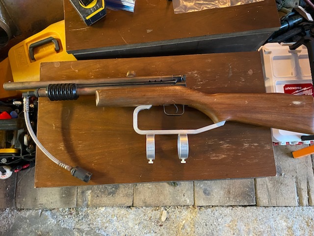

    I got my greasy mitts on a Piranha Rifle. Seems pretty much un-messed with as far as mods, just as I remember the last new one I manhandled in a shop.
    My question is this: is it total blasphemy to mod it a bit? I'm thinking Wedjits and a 12gram cut out etc, but don't want to incur any wrath from The Brass Gods by mucking up a relatively untouched example.

      Oh my God I am about to throw this thing in the lake.
      Total clean up, popped in wedjits, holds air fine. It lobs paint a bit slower than I can throw it only a lot louder.
      I pulled the valve, opened up the ports, put shims behind the hammer spring, not a damn thing changes velocity. Tried HPA and co2
      What am​​​ I missing here?

      the widgets only keep the small paint from rolling out. it still takes more air than a 12ie is possible to launch a .677 ball at field speed down a .695 bore.
      • Oddbawl
        Oddbawl commented
        Aha!
        That's the perspective I needed. I've never run into this before with PGPs and PMI-1s, but none have a barrel this long. That's what's been driving me nuts. It's loud, seems like it's doing what it should, that must be monster blow by.
        I'll open up the transfer port next.

        The focus is going to be trying to balance valve dwell with flow... have you opened up the air transfer port between the tube? Are the ports in the valve lined up? How's the springing? How's the bolt opening - tiny?
        I know people like to blame barrel size... but my Hurricane has no issues shooting .680 paint out of it's. 690 barrel at 280FPS with 800psi input, and I've built 12gram powered Snipers that used a stock bull barrel with nail polish wedgits that again shot 280FPS with 600psi input - and got close to 40 shots per 12gram.
        Like carburetors, it's a matter of tuning using a bunch of adjustments.

          But again, the thing looks pretty factory, and must have been useable at some point in time, so I was looking at tuning before alterations.
          Now, the factor that has changed is paint size, so I do suspect it's transfer port is too wee now as it needs to compensate.
          Your Hurricane likely flows a helluva lot more than the wee orifices on this thing.
          How are yooze guys doing it? I was thinking of drilling through the bottom, the either tapping it if there's enough meat for a set screw like the Snipers or sealing it up with more lead.

        Drilled it out - measured and drilled from the bottom.
        I used a 7/32 drill bit and tapped for a 1/4"-20 setscrew - there's enough meat there for 3-4 complete threads, more than enough.
        I also drilled out the bottom port of my bolt and angled it slightly, but haven't modified my main port much yet, I'm leaving that for tuning once it's all together.
        I also modded my valve a bit - I'm running a custom Sheridan valve from JG Airguns that already has slightly bigger porting, I did a little massaging on the input side of the valve and blocked off two ports with setscrews to help force the air through the top port. I'm going to run a PPS Dynavalve which has a necked down valvestem similar to a Rat valve cupseal or Tornado setup.
        I haven't settled on a valve spring yet, but I've got a bag full of misc that I can pick from.... PPS used a cut yellow Cocker valve spring in one of my Typhoons, so I'm sure it doesn't matter that much.

        Leave hammer spring stock and get a lighter valve spring. Will correct most of your issues
